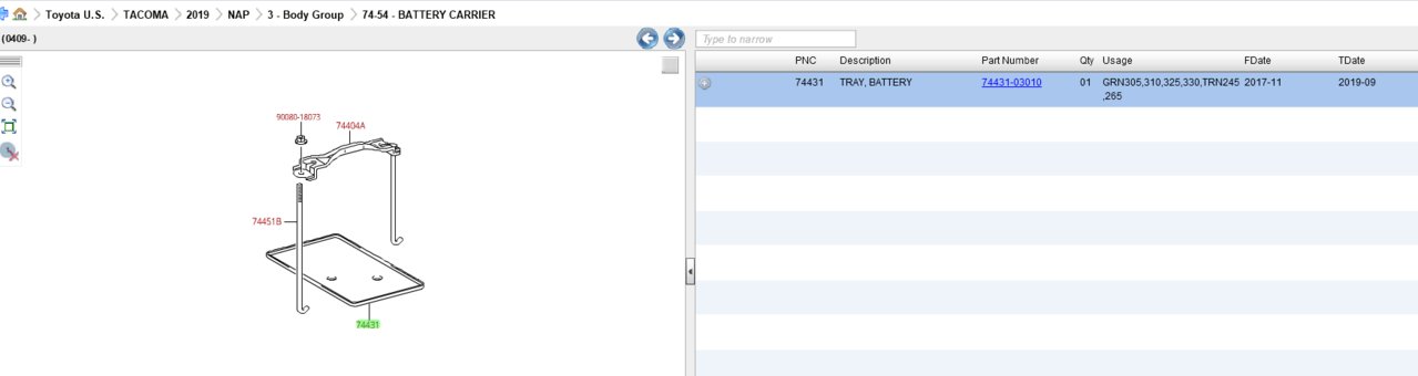

    For the life of me I cannot find a battery tray for a 27F battery. I know they are common and i know they exist but can someone point me in the right direction?
    Thanks!
    PS 3rd gen guy so don't hate ;)

    Not exactly. On the 2nd gen Tacos, there are 2 choices for a battery tray(cheap plastic pan). They list 1 for W/cold spec and one for WO/cold spec. I don't know about "cold spec", but it's common knowledge that the tow package got the 27F and without the tow package got a 24F. For 2nd gens, W/cold spec, tray is $35 and WO/cold spec, tray is $31. For 3rd gens, they only list the $31 cheap plastic pan.
    If you're looking to upgrade the electrical system, I would go with an aftermarket metal battery tray.

    On second gens the 24f tray is the same as the 27f tray. I have a 2011 without the tow package that came with the 24f. I just bought a 27f battery and it fits perfectly in the stock non-tow package 24f tray. It is plastic, 8 years old, and better condition than the surrounding metal.

    OP, what did you end up with? I just squashed a 27F into the stock 24F tray. Could have sworn all my googling indicated the TRD OR with tow package came with a 27F. Ordered it and they drove across town to transfer it for me and I get there and realize I have a 24F.
    I wonder if when they made the tow package standard, the dropped the battery size.

    It fit okay with regards to clearances and all, it was larger than the existing plastic tray.... which I just squashed a little. I then ordered the OEM tray for the 2nd Gen and it works just fine. Let me know if you need a link.
