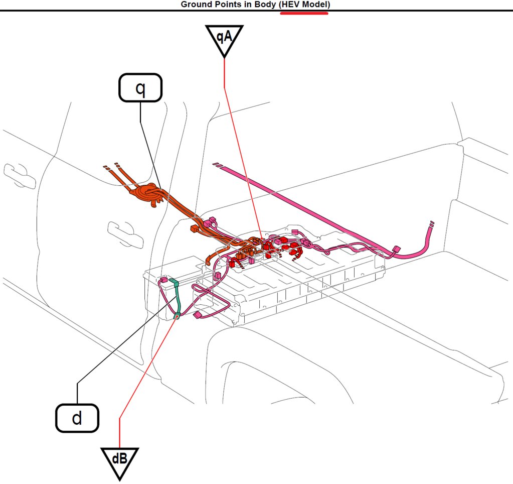

    So the battery is not under the hood? How do you jump these things if it is??? Thanks!

    Use the jump post under the hood.
    Edit....looks like the hid it:

    Thank you very much! I assume the normal battery (not talking about the hybrid battery) under the seat is sealed so we don’t have to put water in it????

    Unsure but assume it is the same as my sealed one in my non hybrid.
