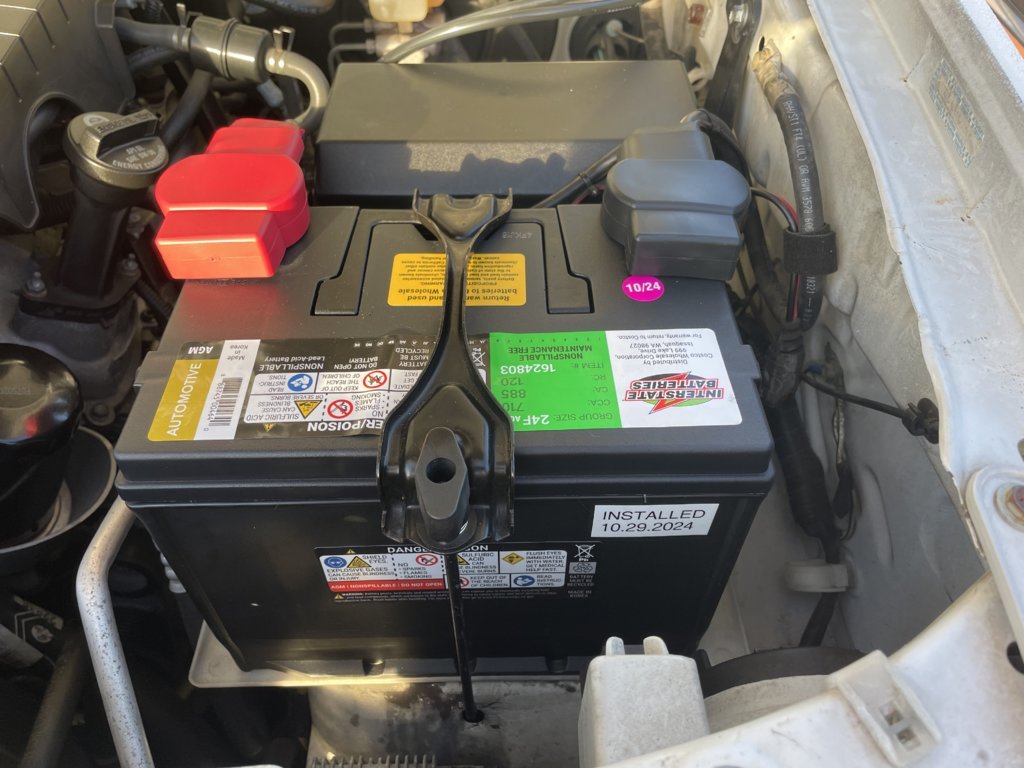

    I recently purchased the Costco Interstate AGM. I was able to use the stock hold down.
    I removed the voltage boost mod I installed for my old X2 AGM. I don't think this battery needs it.
    Too new to review other than install.

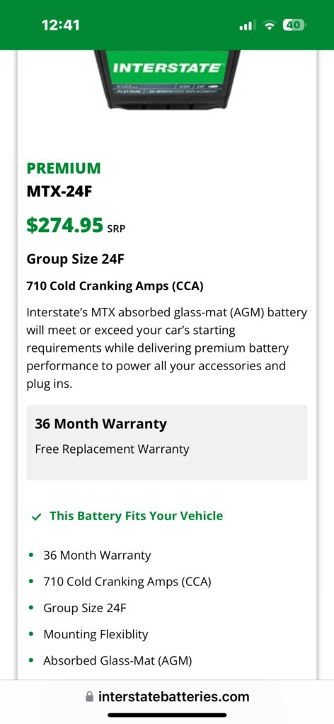

    I replace mine every 5years too , and never wait for it to fail. It’s time for a new one & I was going to get that AGM Interstate. I just wanted something as long lasting and reliable as possible. Just seeing if there’s anything better out there. Thanks for all the replies, I’ll probably get that interstate and this AGM charger off Amazon. Plus I’ll consider the marine battery idea the other guy posted too and just ask him how the extra ground wire helped? Thanks

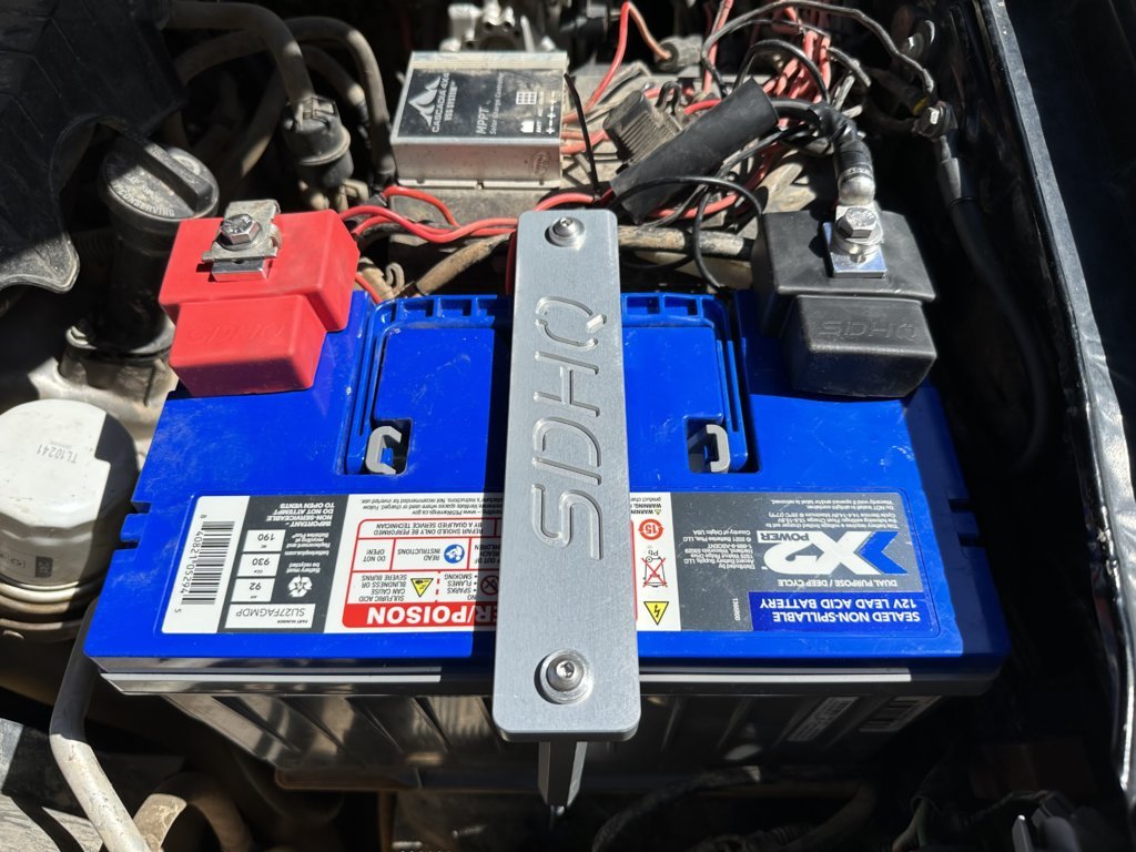

    I live in the southwest desert and had previously ran OEM Toyotas batteries that lasted a year before replacing. Upgraded to an AGM battery (along with the alternator voltage booster). Still going strong after 18 months.
    *don’t mind the birds nest. I’ve cleaned all that up with the Garmin PowerSwitch
