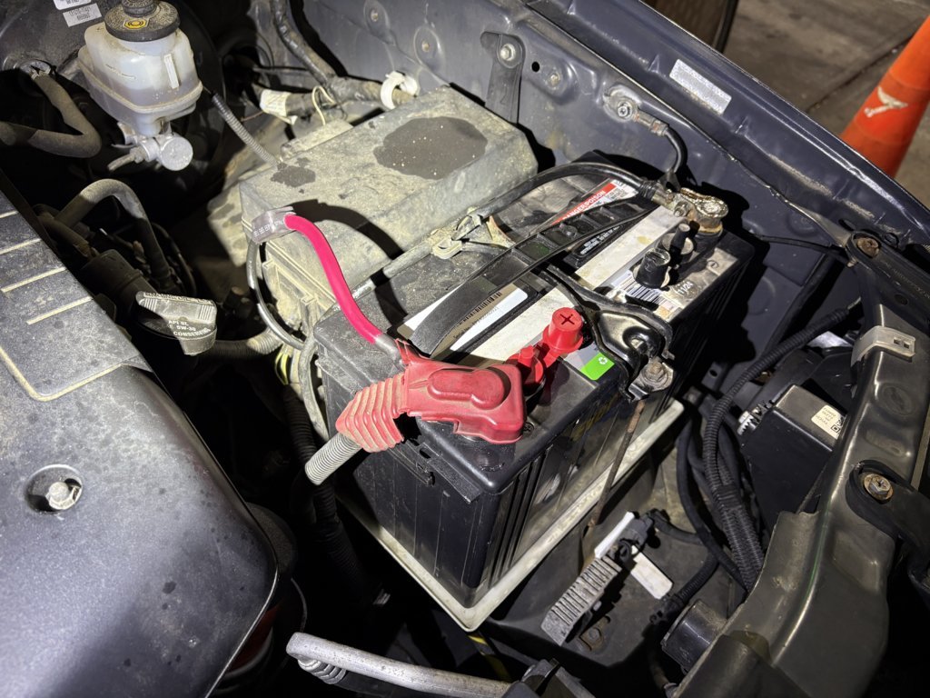

    In my case, 2nd gen it’s THIS positive wire that’s too short

    Interesting... What is restricting the wire from reaching the positive connector on the battery? Something taped off somewhere?
    On my truck, there was no restriction; and I definitely did not extend the positive lead.

    That one I’m pointing at that goes into the bottom of the fuse box, will be an easy fix though…. That ground that goes into the fender would be a tight stretch so I think I’ll just grind off some paint and drive a new screw through that a little closer to the terminal. Thanks for the good advice- I just found this one at wall mart that was made 11/24—$93 - it was behind the ones that were made 7/24 haha

    THANKS AGAIN!!! it’s done. Idk where I’d be without Tacoma world haha just had to extend that 4awg cable and move the negative fender mount wire

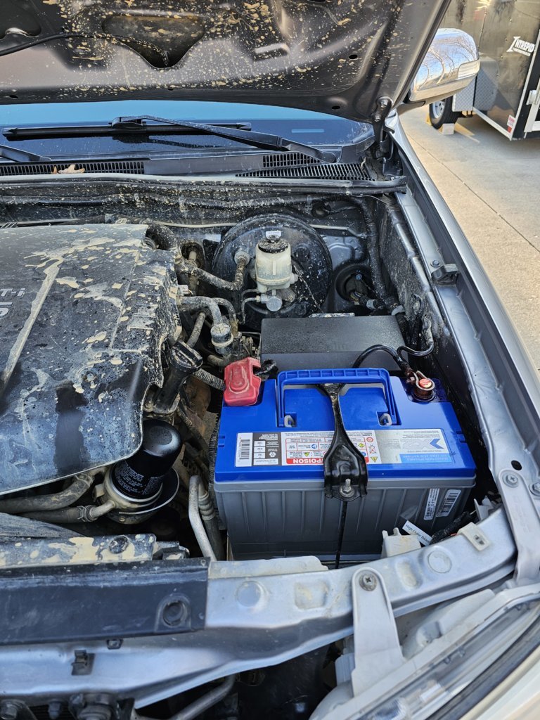

    For interests sake, the group 94R/H7 battery fits in the same space as the group 27's. The only glitch is that it's slightly shorter which means using an aftermarket hold down. These are way easier to source, more powerful and are fitted to new Toyotas (Tundra) and most of the European cars and Chryslers.

    I actually saved money and have a longer cable now making it possible to install different styles of batteries if ever in a jam

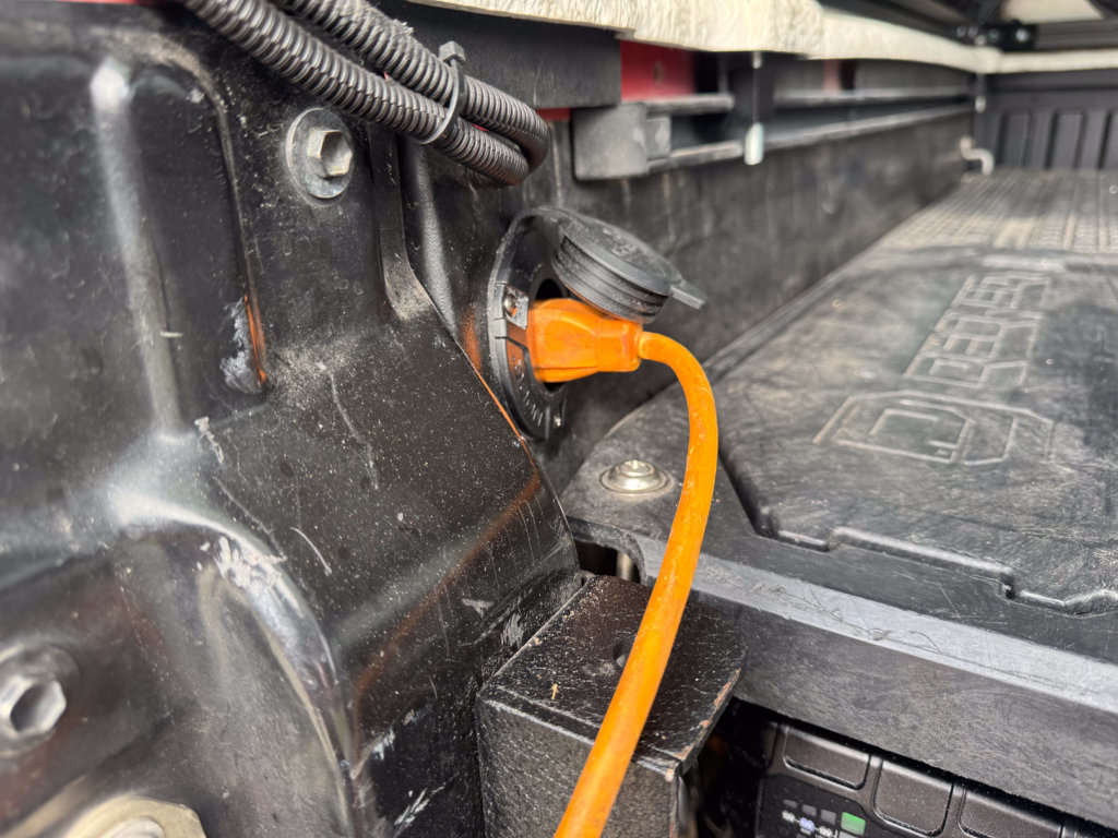

    While not a 2nd gen, I run a similar setup. I have the Gen 5x1 permanently installed and added the AC port plug they also make. Works great. I plug it in on the weekends.

    I love my x2power. I have the 27f and did the voltage boost mod. I've had mine a year. When i hit the starter in 20 degree weather, it hits damn hard

    I’ve been running this setup for 7 years. Shooting for 10 before doing it again.
