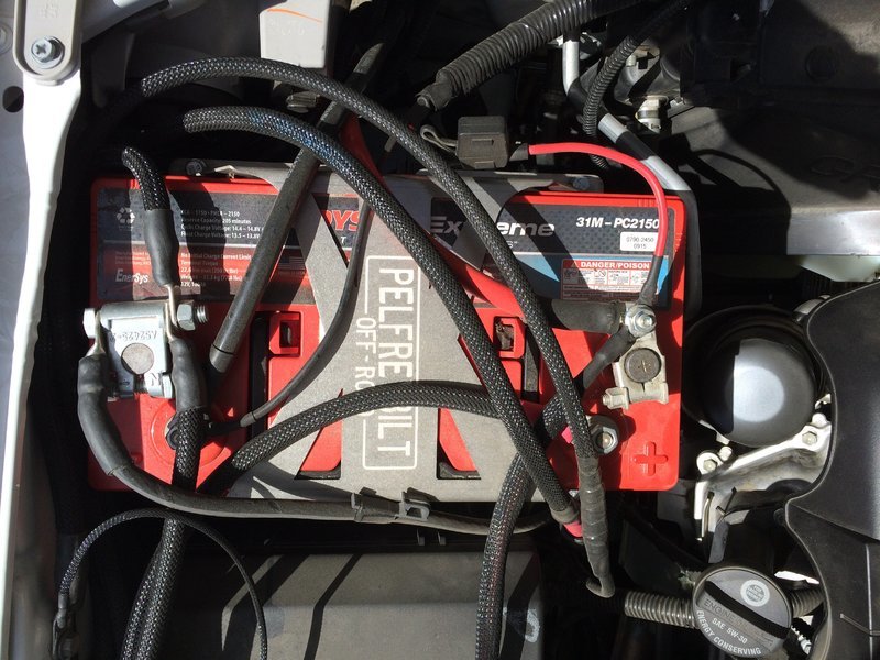

    I did the BamaToy upgrade on my truck (27F) and helped out @the glen (31M). Kind of a shame Bama flaked out on making them. As I recall @ryanjboutin bought a kit around the same time but may not have installed it. Maybe you could buy Ryan's if he still has it...

    You could just swap out the terminals now and do the wiring later. I used one of these for the negative in place of what came with the Bama kit. If you re-use the stock cables, you will have to terminate one of them with a lug. That is the difficult part as those really want to be soldered, not just crimped. If you can get the lengths, you can also buy pre-made cables. I like marine grade but they're expensive. Another alternative is Del City.
