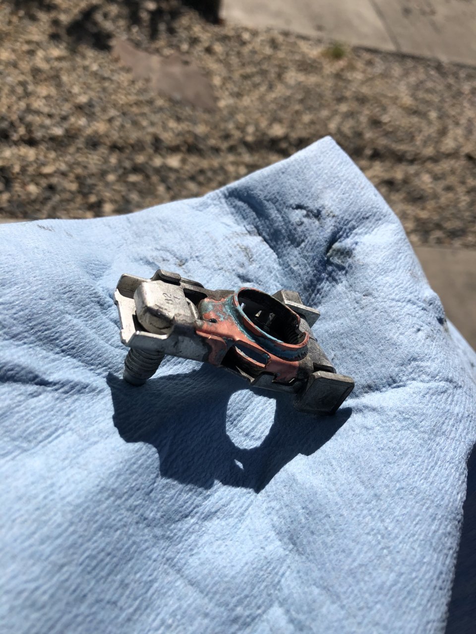

    Should I be concerned and replace this part? I try cleaning it with soda hahaha. That raw copper is something I’m not sure about .

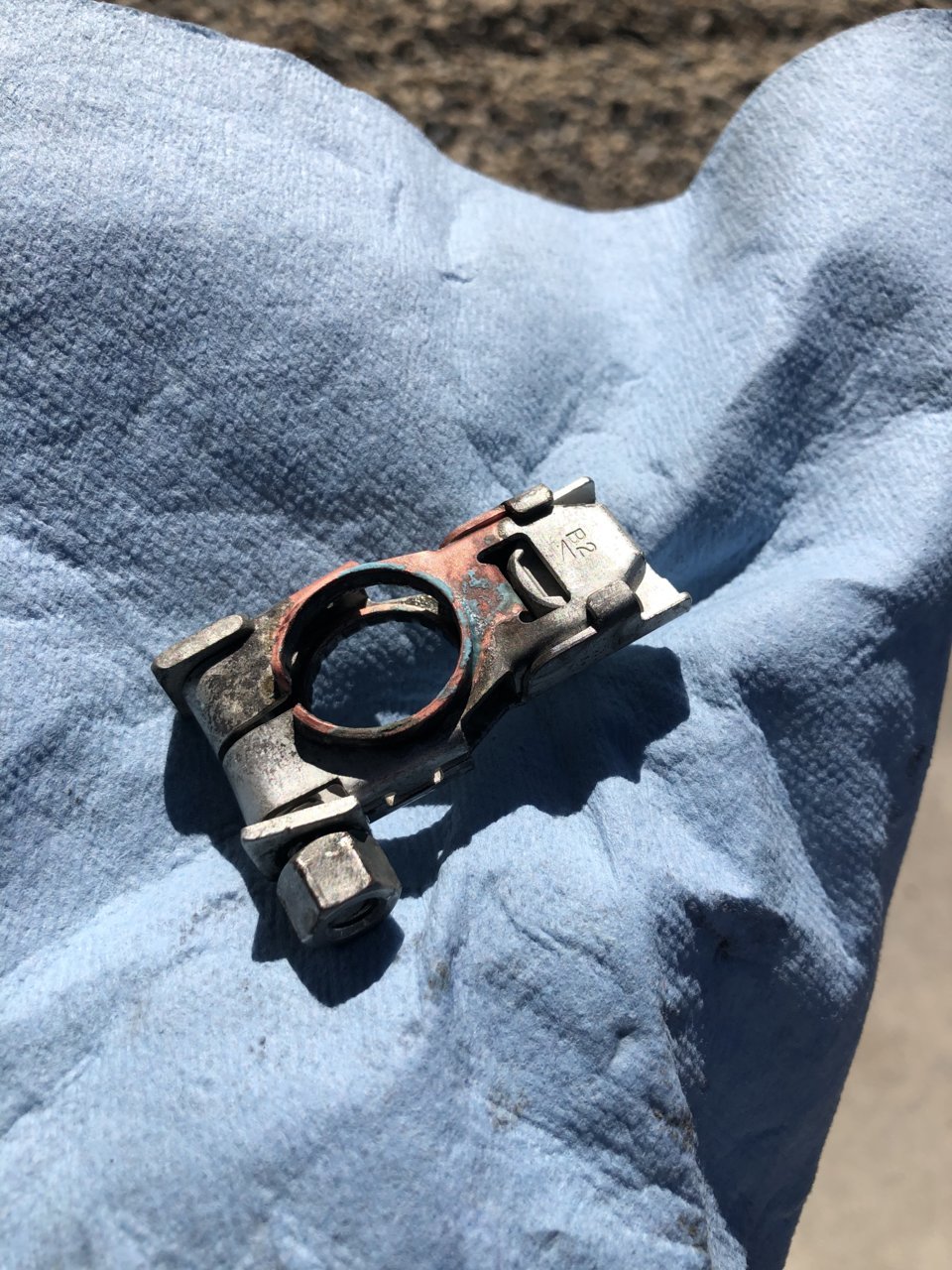

    Another pic

    Wire brush. Re use it. After installed blast some fluid film over it

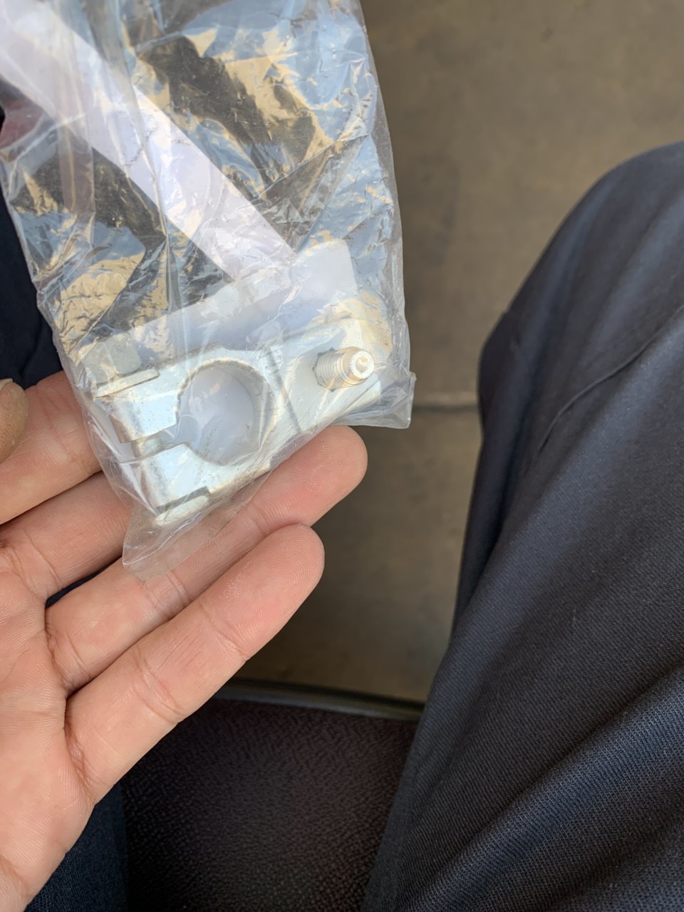

    2018
    New ones are cheap and easy to install.

    If it’s cheap replace it .

    I would replace it and the battery

    Put it back on the cable, mount it to the battery post. Schmear a bit of die electric grease on the post and on the connector.
    BTW, the copper isn't "raw". It has just lost it's plating.
    "Raw copper" needs to be smelted from ore.

    I
    part number?
