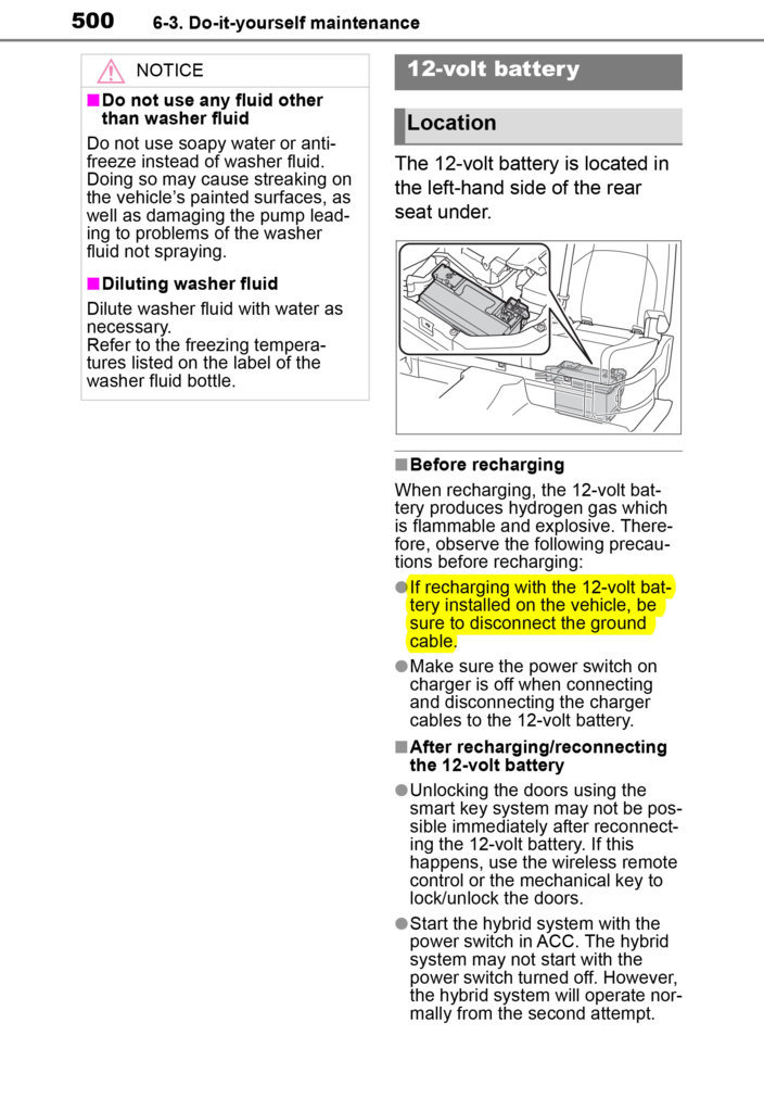

    You can't use a trickle charger. The 12VDC battery needs to be disconnected (remove ground lead) to charge battery. If you let the truck sit or do not drive it for an extended period of time, you should also remove the ground lead.

    Why not?
    Hybrids have huge relays that interrupt the 12 volt system when off. You can 100% charge any 12V battery in a HV while its connected, provided its a "smart" charger, but that goes for any modern vehicle.

    don't know, ask the Toyota electrical chassis team.
    it's very clear in the manual and T-SB-0025-23 "Maintenance for HV/BEC and Auxiliary Batteries" that the 12VDC battery must be disconnected before charging.

    No it does not, it says to disconnect the 12v for storage.
    There is no where that says its unsafe to charge the battery while connected.
    We test and charge 12v batteries while connected daily, this is the norm now. It even shows in your TSB that you linked that the vehicle is connected when the tester is connected.
    The tester is a massive charger, and it frequently uses 50amps to charge batteries while testing.

    the manual does state that the ground should be disconnected when charging the 12VDC battery.
    the TSB does state the 12VDC battery should be disconnected for storage (i.e., does not give the option to use a trickle charger).
    i have been told by several dealers not to use a trickle charger with the Max hybrid.
    if you have different information, great please provide this documentation allowing the use of a trickle charger.
    cheers...

    I’m a hybrid tech. The reason they say to disconnect is because the battery is inside and there may be fumes that could ignite.
    technically you should always disconnect any battery before charging incase you induce spikes. Most chargers now are self regulating and won’t boil a battery or over volt an ecu.
    They are telling you this because of liability. You can 100% use a trickle charger on any hybrid 12v battery.

    so you are a hybrid technician. congratulations o_O That explains your vain comments.
    good info tho. there is definitely some ambiguous information being disseminated regarding battery charging.
