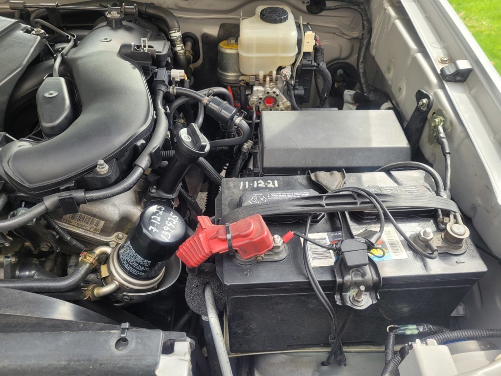

    In October of 2014 (6 years) the OEM Group 27F battery died. I almost died when I saw what Toyota wanted for a replacement. That day, I spliced 2" of AWG #6 wire onto the negative lead where it attaches to the inner fender. According to my notes, this cost me <$20 for wire, the correct size butt splice, and heat shrink tubing. This enabled me to use a non "F" battery in my truck. The next day, I bought a Walmart Group 27 Deep Cycle Marine battery for $87 in Massachusetts, and I changed the battery in the Walmart parking lot. In November of 2021 (7 years later), while the battery load/resistance tested OK at Advance Auto Parts, I decided that I was pushing my luck, and bought my second Group 27 Deep Cycle Marine battery from Walmart. This time it cost me $92 with Florida's state tax. I am still running that battery today.
    EverStart Lead Acid Marine & RV Deep Cycle Battery, Group Size 27DC 12 Volt, 740 MCA = 937.5 CCA - I see that the price is now up to $94.
    You do you. However, despite the forum-know-it-all predictions of short circuits and the need for a $300+ AGM battery every 5 years in every vehicle (you guys crack me up); in the 10+ years that I have been running with the extra 2" of negative lead, and Marine Deep Cycle batteries in my truck, I have had no DC or battery related issues!
    MY
    total cost for batteries in the 16 years that I have owned my Tacoma has been <$200.
    Toyota makes the negative wire that attaches to the inner fender as short as possible so that they can save $0.002 on the manufacturing cost of every vehicle, AND to force you into buying a "-F" battery at a +30% price premium.
    Add two inches to that negative lead and you can mount either an "-F" or a "non-F" battery in the stock battery tray. There was nothing for me to do to the positive lead because on my truck it reached either the front or the rear of the battery without issue. There are no downsides to this modification on the Gen 2 Tacoma; assuming that you can either manage a quality splice, or use a longer cable.
    This is what my battery installation looks like;
    [EDIT] Yes, the pic above was taken in 2023 at ~124K miles. I have STILL not changed this battery (Sept 2025 at 142K miles), and it is still going strong.

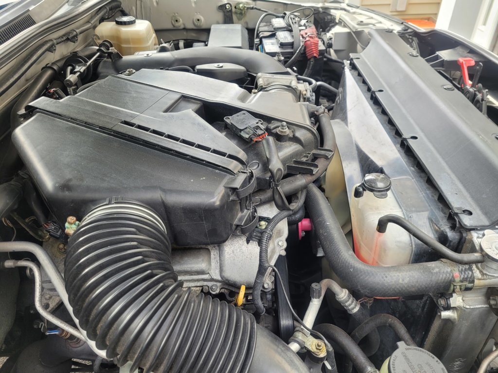

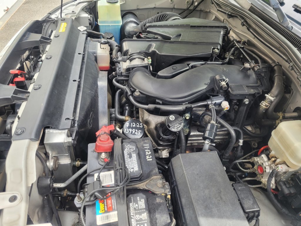

    The two year old picture was buggin' me, so I took a new series of "under hood" pictures today. This battery should be good until 2028.
