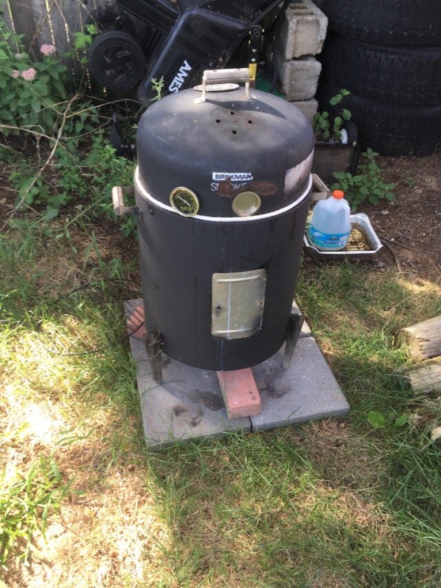

    Here's my S1-R1 cook droid at rest - "set timer"
    List of mods - all stuff I picked up on yoo-toob, etc.:
    high temp gasket at the lid
    thermometer on the lid
    Fire bowl drilled with approx 12 3/8" holes to vent.
    (3) very small terracotta pots as risers for a 10" or so grate - created a place for ash to drop and allows air flow into the fire bowl.
    Legs on the outside

    R2D2 NOOOOOOOOOOOO;)

    I have the same R2D2 set up. It has been a while since I have posted pics on this site so I am trying to figure it out....
