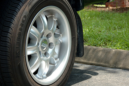

    I’m trying to find out if the 18” Tundra BBS wheels will fit an 01’ Tacoma. Anyone have any experience with this?

    Talking about these ones? They should. Bolt pattern appears the same, as long as you have a 6 lug tacoma.

    That’s the wheels, someone local has a set but I’m not sure about the offset and if the center of the wheels will match.

    They are a BBS Rw rims, ive seen them on some 2nd gen trucks. You have to get actually toyota ones for them to fit. Ones off of some place like tire rack wont fit a tacoma.

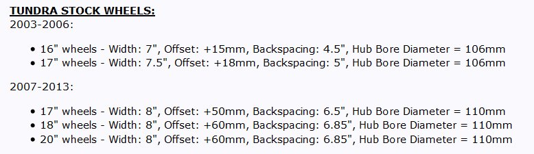

    Tacoma hub bore is 106mm tundra is 110mm so they will fit if they are off a tundra. But wont but hib centric but that doesn’t really matter

    Interesting. I'm running old tundra wheels and they fit perfect, so I did a quick search and came up with this. Looks like it changed between gens.

    Maybe I thought of the newer gen then. But i have seen 2nd gen tacomas with the rims the op likes. But idk where they got theirs
