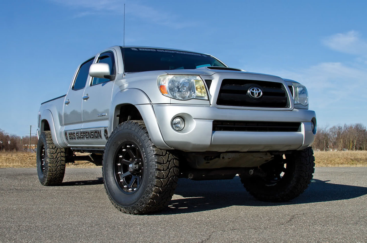

    I see BDS just came out with a 4" tacoma lift. Any one have any opinions or experience with this? Photos?

    It's drop bracket. Along with 3" blocks in the rear.
    I emailed them a few weeks ago asking for some more pictures of this truck. They said they had 35s on it but rubbed severely.
