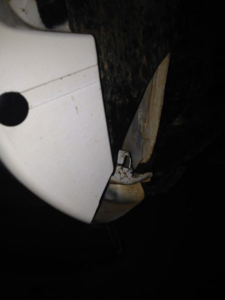

    I'm looking into the BDS 6" DB lift with the coilovers for my 2015 TRD sport. I want to run 35" toyo open country tires on an 18" rim. Does anyone have this package on the 14 or 15 model? Im wondering if trimming was needed on the back corner of the front fender when the tires are turned, saw a stencil to trace this cut out (some people said it wasn't needed) but am wondering how or if you needed to trim the fender flare. Please don't chirp the DB lift, it is quality. Im looking for advice on how to and what I may encounter on the install or while running the setup. Tire specs will be 35x12.5R18 on the BDS coilover 6" Tacoma lift on a 2015 TRD sport package for specifics.

    Mine is a 2011 but you'll run into the same issues with a 14 or 15 model. Here is my fender trimmed up.....

    It's easier to get everything installed, then trim what you need as you go or as you see it rubbing. If any future wheeling, you might want to do a cab mount chop as well.
