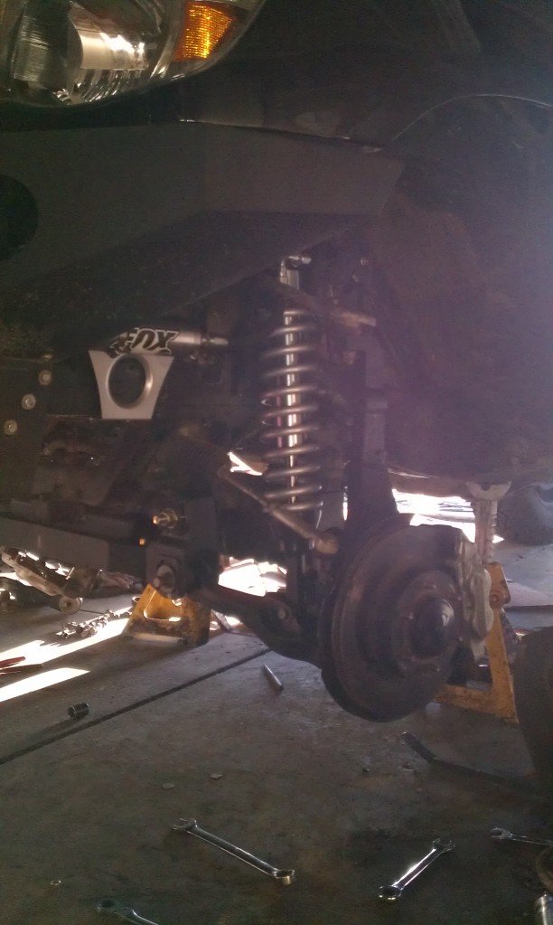

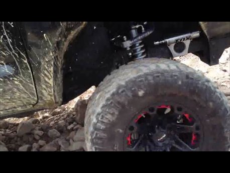

    Ride is pretty cherry! (except rear blocks)
    Just make sure your dead set on a DB lift
    Maybe get new UCA's

    Spring packs are about $500 a pair, give or take, you have leaf springs in the back not coil. Bump stops are what limit the Up travel of the front suspension, the smaller the more travel you have. The ones that came with my kit must have been misboxed because they were always touching the LCA.
    DB is drop bracket. Means they add a lower cross member, taller steering knuckles, that's where the lift comes from to allow bigger tires. Stock UCAs are fine, after market allows more camber adjustment and better caster, they are not a must.
