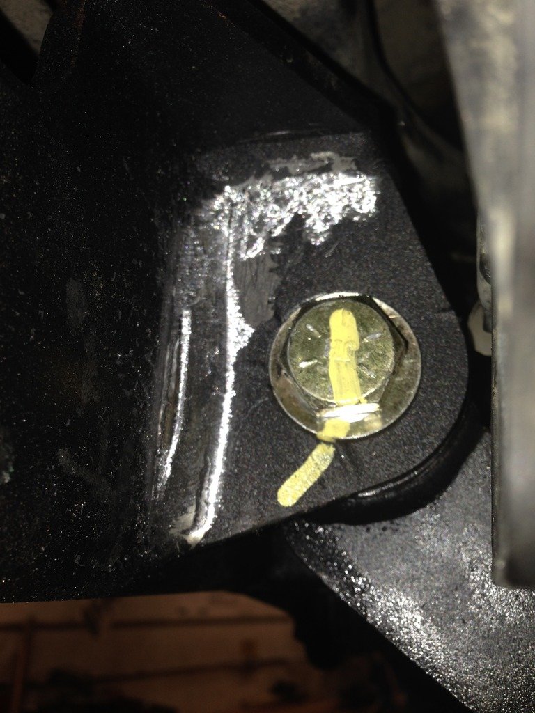

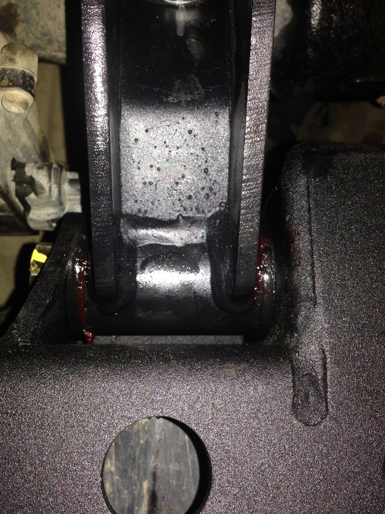

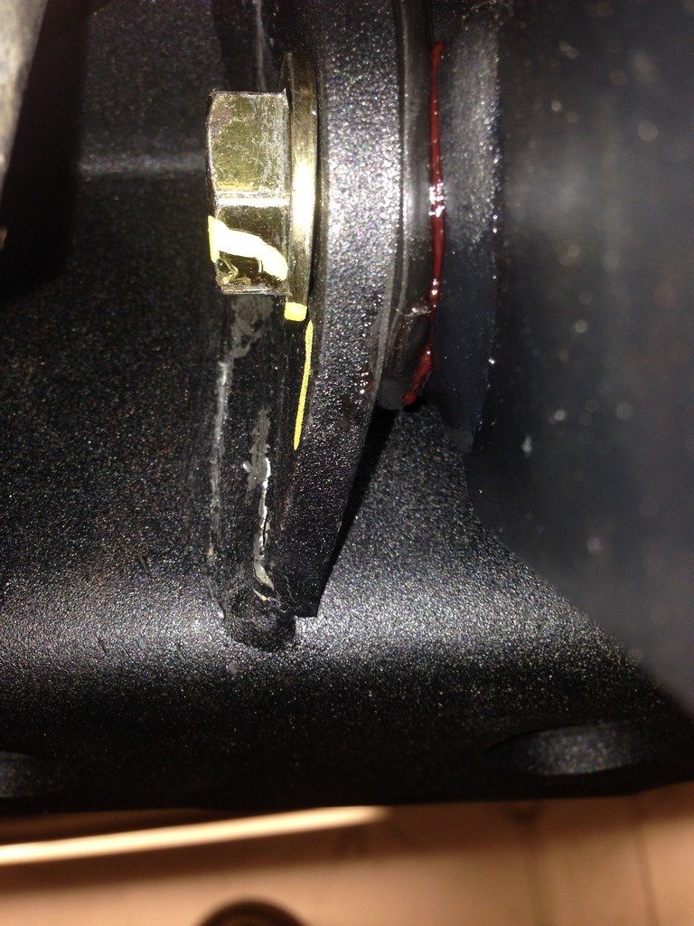

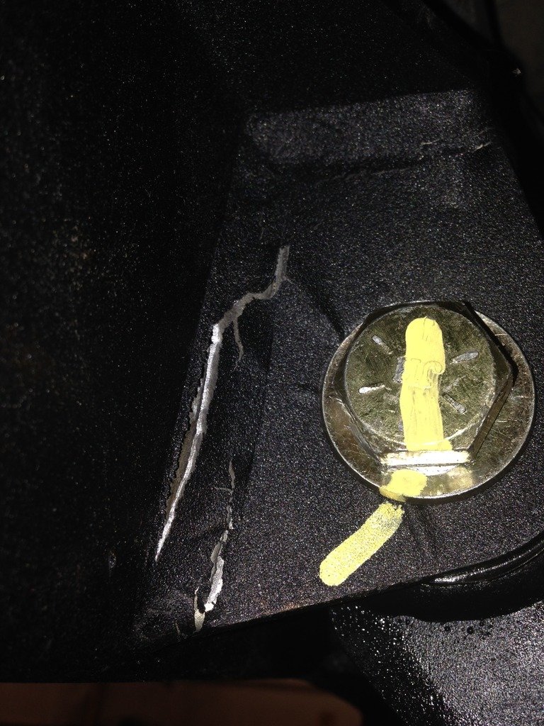

    The BDS Kits (or at least the one I received) have a design flaw on the front passenger side diff mounting bracket. The bracket is welded too far to the center causing it to bend excessively when torqued to the recommended 96 ft-lbs. Mine was so bad that the weld behind the bracket cracked. Unfortunately I have limited shop time and could not wait for BDS to send me a new part. I already had everything put together and the front end nearly complete so I decided to fix it myself considering its a simple weld.
    If you had this kit installed by a shop I highly doubt that they did a thorough inspection of everything. I would check all of these mounting brackets and welds, specifically the passenger front. All of them seemed to bend a bit after being torqued. But the passenger side front cracked half way up the weld. I included pictures of the issue and repair.

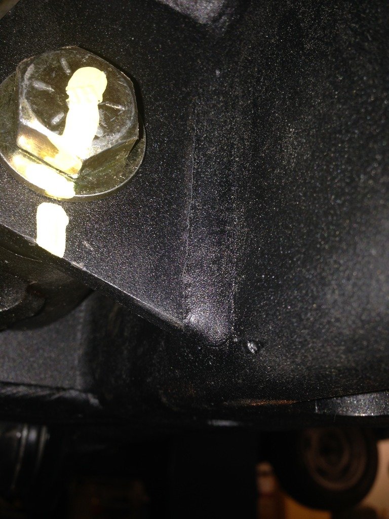

    The bad weld

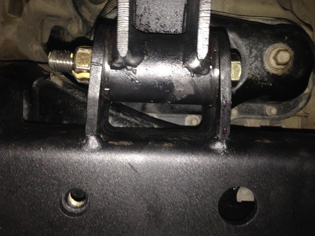

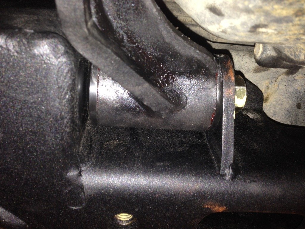

    The remainder of the mounting brackets look fine. A slight bend to them but no issues with cracked welds.

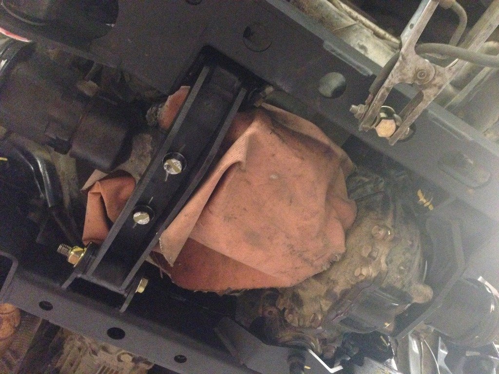

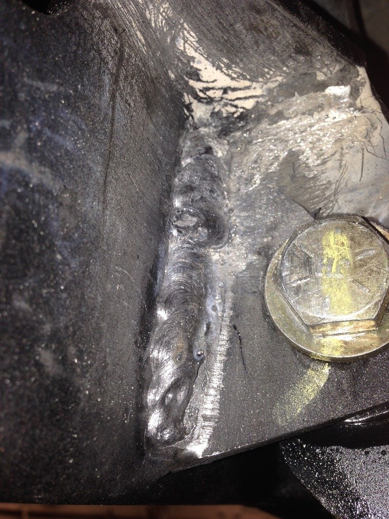

    The fix is done by grinding through the powder coating in to the steel around the cracked weld. I used a skid plate mounting bolt as a ground and made sure to use a welding fire blanket and wrap the diff control box/wiring. I ran a bead down the weld and once cool I coated the area with POR15.
