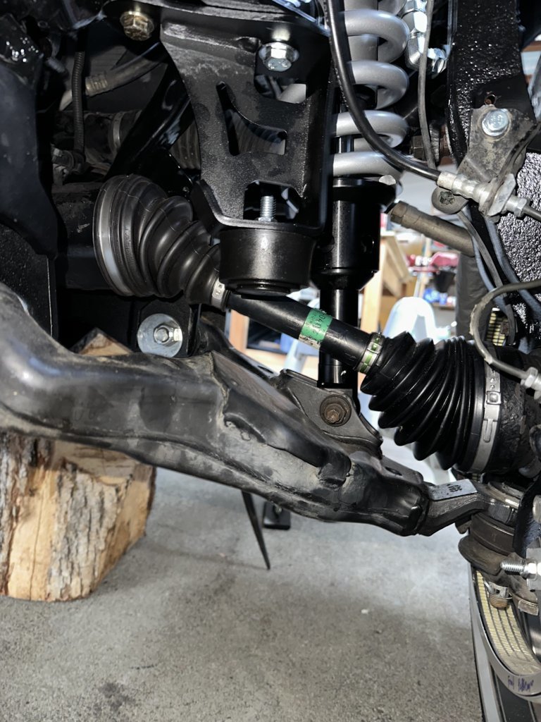

  8. Aug 21, 2025 at 7:58 PM
    #28
    that_06regularcab
    that_06regularcab [OP] 3rd gear wide open in a Toyota
    Nov 4, 2015
    #168631
    310
    Southern Oregon
    Windigo likes this.
  9. Aug 21, 2025 at 7:59 PM
    #29
    that_06regularcab
    Nov 4, 2015
    #168631
    310
    Southern Oregon
    My driver angle doesn’t seem too terrible but my passenger is like a good bit worse. So maybe it is possible that I messed up idk

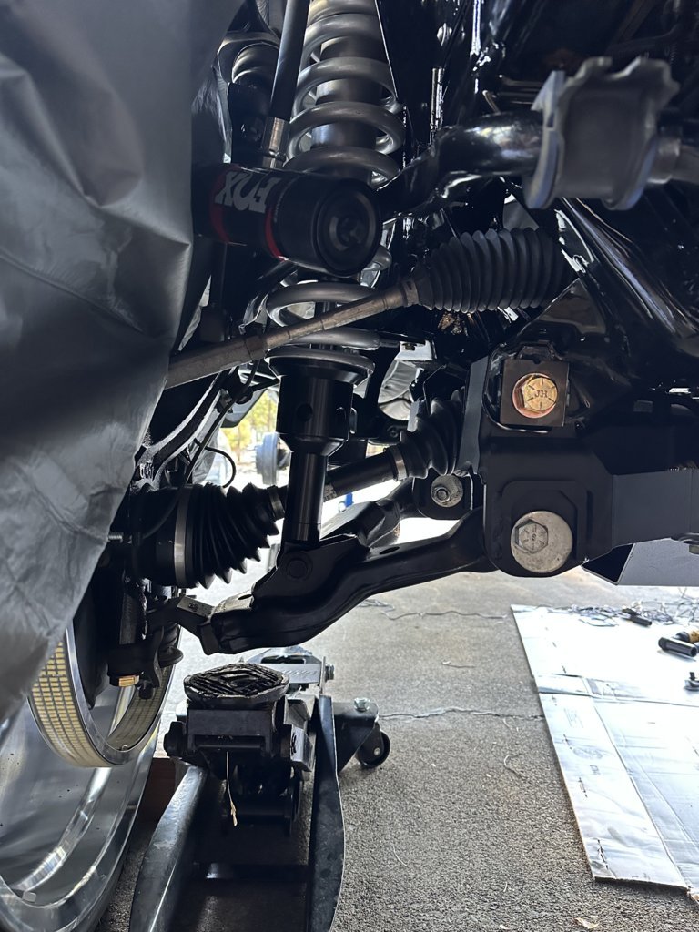

  10. Aug 21, 2025 at 8:02 PM
    #30
    that_06regularcab
    Nov 4, 2015
    #168631
    310
    Southern Oregon
    Another couple on the passenger side
    Windigo likes this.

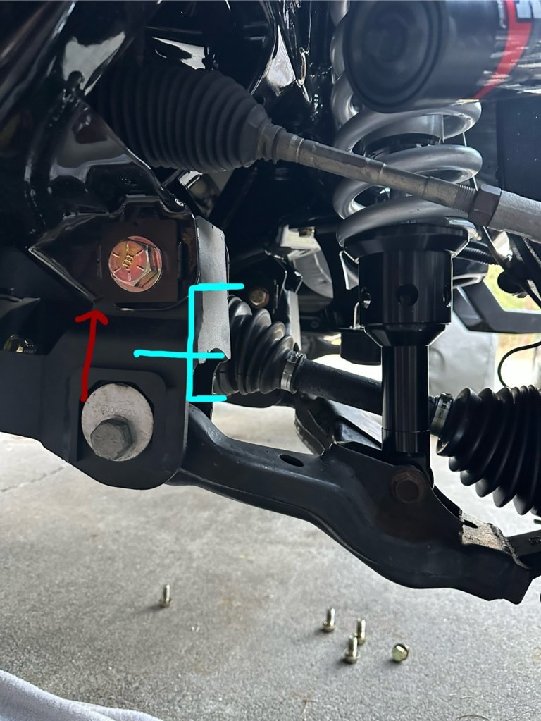

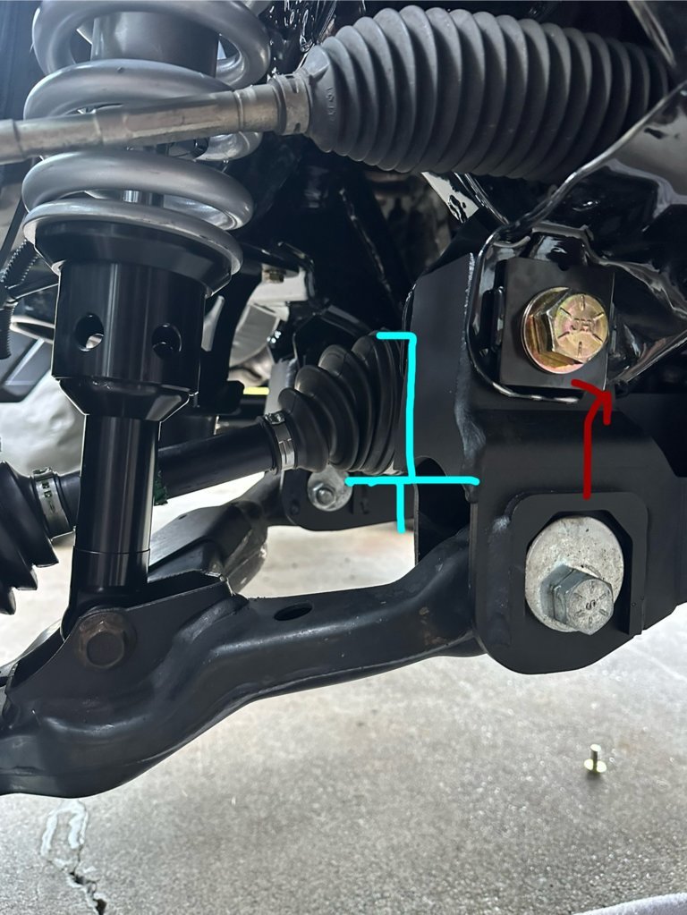

  14. Aug 27, 2025 at 10:24 PM
    #34
    that_06regularcab
    Nov 4, 2015
    #168631
    310
    Southern Oregon
    Ok so adjusted preload 1” and it helped cv angles. I can get pics later but I think we still need to come down some more. However, the passenger side angle is still super bad. And I sorta know why passenger and driver cv angles are so much different now (passenger is way worse). It’s because the inner cv axle housing on passenger side is sitting higher than the driver side. I believe this is because when I installed the lift I had to cut away part of my frame so the front crossmember could swing high enough up so that the mounting bolt could go through the mounting hole. Otherwise when I first tried to install the front crossmember— I’d swing it up and it would get hung up by part of my frame. The maroon/red color arrow in this picture shows the location I had to do that. And because I cut that, that means that the passenger side diff support came up too.
    But the question is, why did the crossmember get hung up and not just mount nicely in place? The maroon arrow shows where I had to cut away from my frame so the crossmember would mount up correctly
  15. Aug 27, 2025 at 10:25 PM
    #35
    that_06regularcab
    Nov 4, 2015
    #168631
    310
    Southern Oregon
    This pic shows how much lower the driver side inner cv axle housing looks (refer to the turquoise reference points)

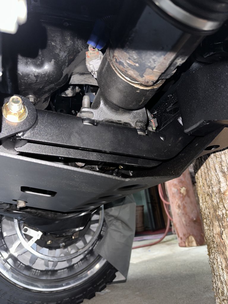

    Usually on the db kits you lower the diff assembly. Let look at their assembly instructions
  19. Aug 28, 2025 at 6:22 PM
    #39
    that_06regularcab
    Nov 4, 2015
    #168631
    310
    Southern Oregon
    I remember there being spacers for the factory skid plate but I didn’t use those. I have a printed version of the installation manual and I watched a video but I don’t recall spacers for the diff supports. They’re just these arms that you beat bushings into. I could have somehow missed it but ya idk I don’t recall
  20. Aug 28, 2025 at 6:26 PM
    #40
    that_06regularcab
    Nov 4, 2015
    #168631
    310
    Southern Oregon
    Idk if it was mentioned here yet— as I made another thread about the issue with cv angles not matching etc. but 4x4junkie noticed in some of the pictures that I posted that the passenger side diff support tabs looked welded on upside down. And looking at it in person they very much orient facing up on the crossmember on my truck, but orient facing down in the instructions. Here’s the pics. I’m the instruction manual it is figure 20 right below step 37.
    gotoman1969 likes this.
