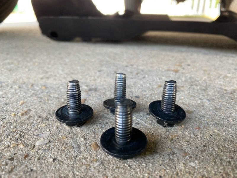

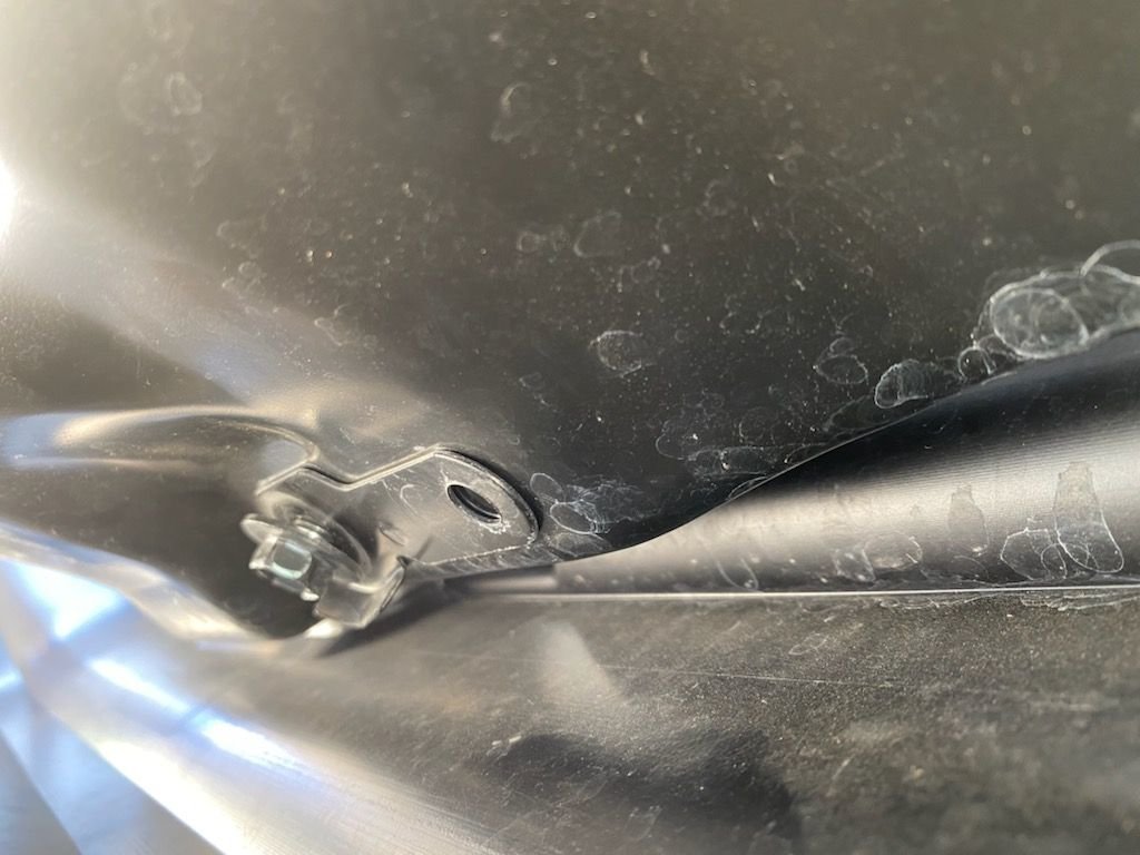

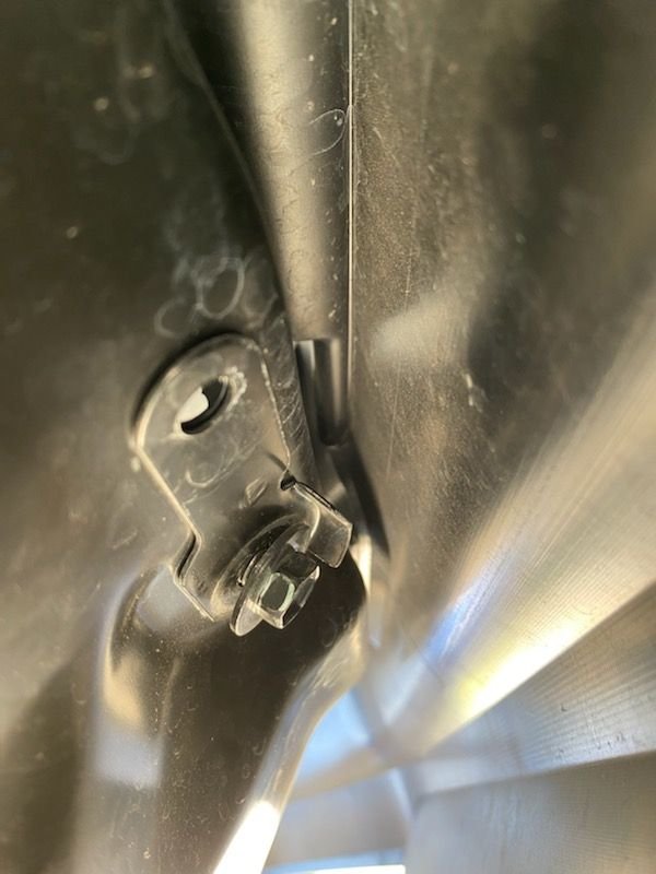

    I have a Sport too...and removing the original skid after finding bolts over-torqued and screwed in crookedly by the dealership were not the same holes the TRD Skid lined up with. I was glad those holes were not re-used and the new TRD Skid had different mounting locations.

    Here's what my bolts looked like after removal and area on the original skid where the ONE bolt was put in crooked:
