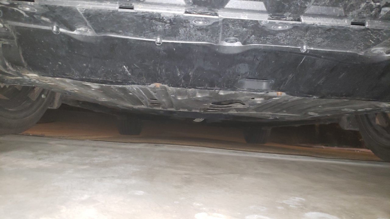

    I should clarify, but a Civic's skid plate is nowhere near as tough as a Tacoma's. Although it's metal (better than my Focus' felt under tray), it's so thin and optimized for aerodynamics and fuel efficiency that it's flimsy. I've heard stories of dealers forgetting to screw in the last two screws on the front, causing the plate to fall off when driving. 20220219_211408.jpg
