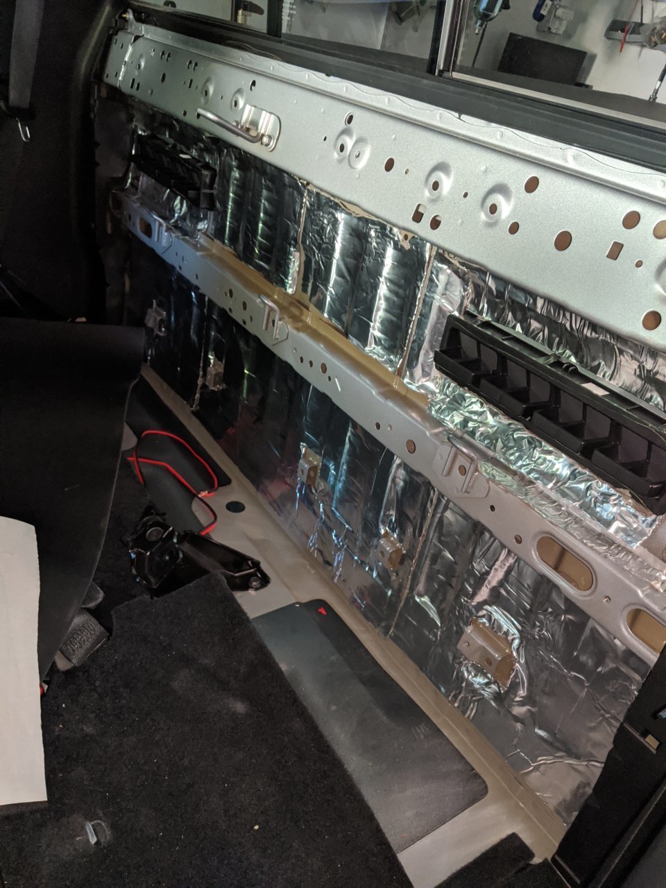

    I did it to all the doors and back... here are pictures of the back. It made a difference but if you need to be wowed you will have to do the roof and floor.
    Layer 1 -BXT II RAAMmat
    Layer 2 - Ensolite IUO
    Layer 3 - Mass loaded Vinyl

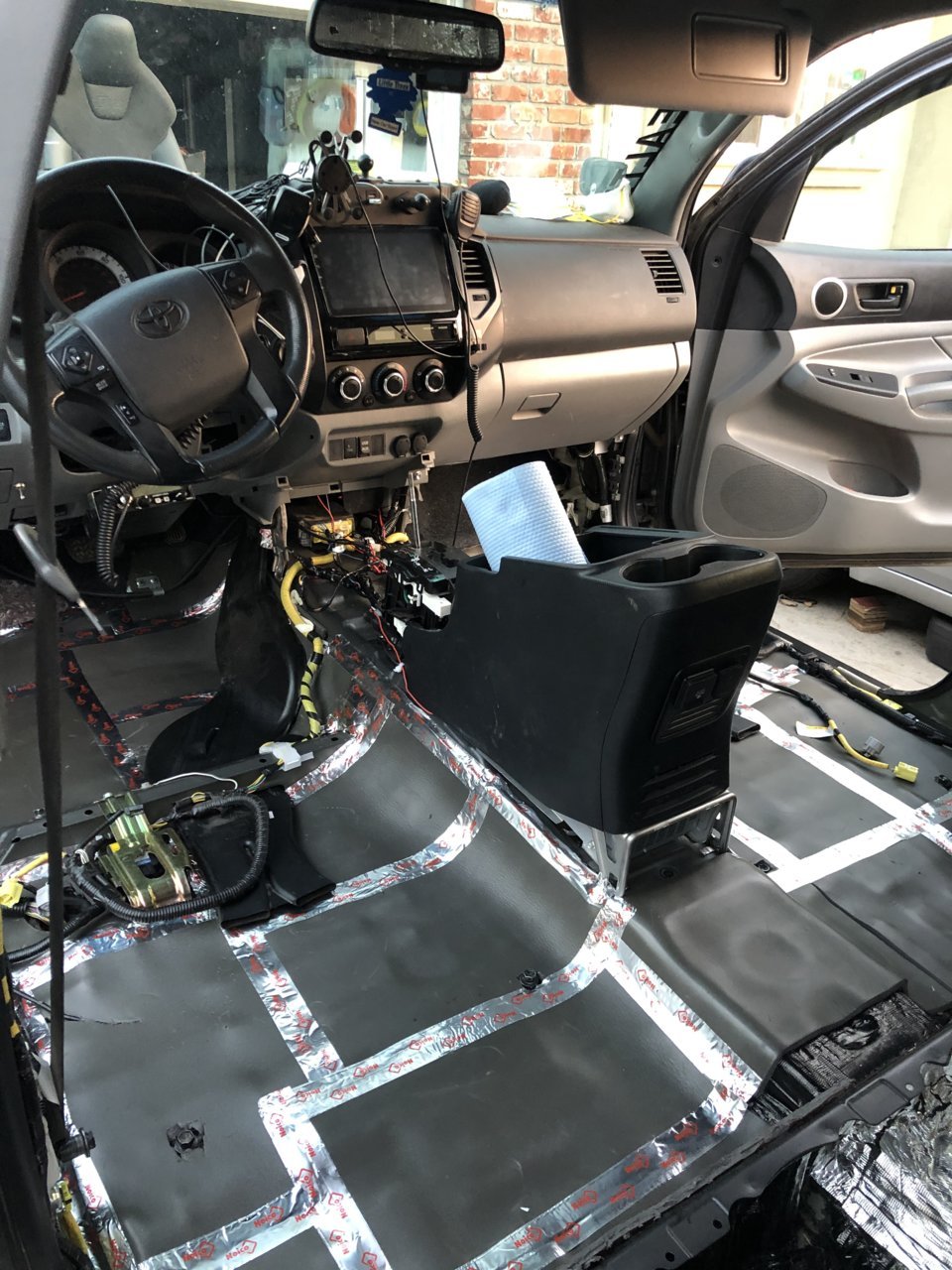

    I’ve done doors in dynomat extreme but the rest with Noico 80. Just did the floor and rear with 80 them 315 mil (accidentally ordered the wrong one) that stuff is thick. I would prob. Stick to 150 or do 315 in the floor and 150 mil on sides as some areas don’t lay flat very well. On the rear I did extra 80 mil on the recessed spots. I need to lay 150 over the dynomat on the doors. The roof area will be a major improvement for sound inside and out. For audio you loose a lot there.
    this is almost finished floor.

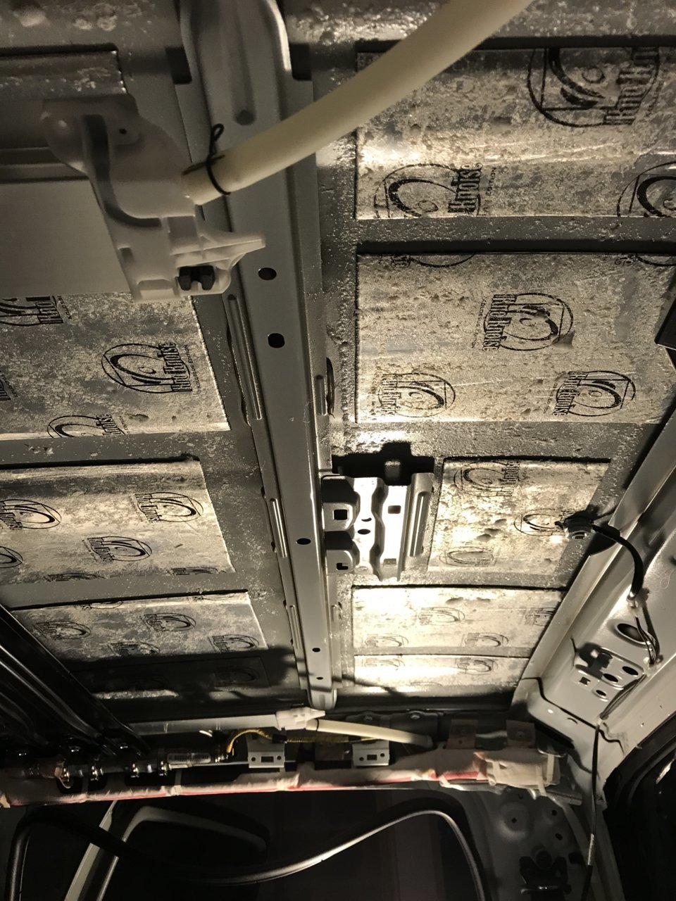

    Exactly right. 1 lb/sqf minimum. Also, the more mass you stick onto a vibrating surface (think resonance) the better it will be at changing it to a lower frequency. I like 80mil or better, kno knoise kolossus is 100 mil thick. Took 35 sqft to effectively do the whole truck, + some butyl rope for those internal door supports (very effective).

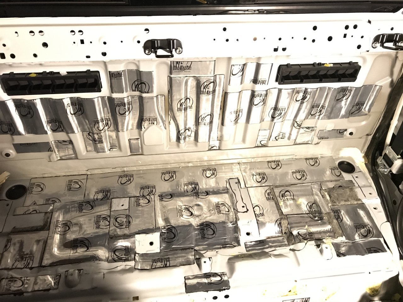

    Well... I did it. Used the excellent post on this board about removing the jump seat bits, then yanked the back wall sections. Wiped the whole area down using a clean towel w/alcohol and went to work. I'd gotten my wife a set of new speakers for her front doors along with a box of Dynamat Xtreme. Thanks to her COVID fears about anyone getting in her vehicle it's been sitting for quite some time... and I couldn't wait... and so I commandeered it. LOL. There was just enough square footage in that front door kit to do the entire back wall, plus the narrow strip of the floor exposed directly under the jump seat mounts. All told I had maybe a couple of solid hours into it from first pop out to last snap in. Thankfully I did not break any of the red snaps. Too tired to take it for a spin now. Need food & rest. I have to do a grocery & gas up run tomorrow, so I'll find out then if my efforts have yielded bountiful fruit. If so, I will continue forward towards the front doors. Not sure about the floor or ceiling but if it can be done w/o trashing the carpet & roof liner to the point where they no longer fit properly then I will eventually do them as well.
    We have a major road trip coming up at the end of this week so that will be the real trial by fire. Now if I can just get a little tinting done before we leave I'll be way ahead of the game. My heartfelt "Thanks!" to all who posted here with their various struggles & successes. CHEERS!!!
