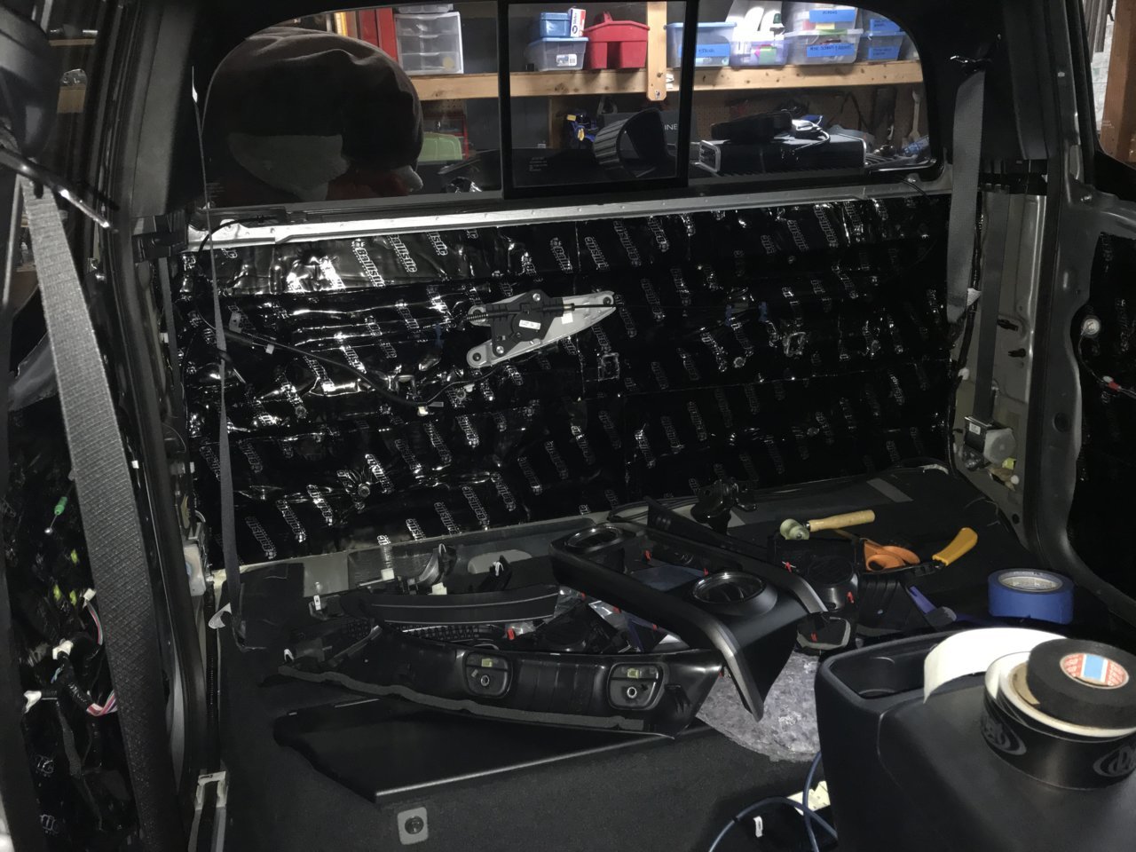

    Swiped the Dynamat Xtreme from the stereo install package I bought for my wife. LOL. Removed the seats & hardware and layered the entire back wall with it. After a 1700mi trip I can confirm that this was a great mod. HUGE difference in the noticeable sound from the back. However, as others have mentioned, you almost instantly begin to hear other areas throughout the rig that are the next 'weak link' in the chain. Next summer I'll be on my motorcycle and can afford to put the truck in drydock for an extended period in order to strip it out. At that time I will put a second, thicker layer in that back wall for good measure. And going forward I will do two differing thicknesses when I tackle the access & front doors, floor pan and roof. I don't have a thunderous sound system like many others who've done this mod; I just appreciate a quiet vehicle where you can talk to others in your rig without having to shout to be heard over annoying background road noise.

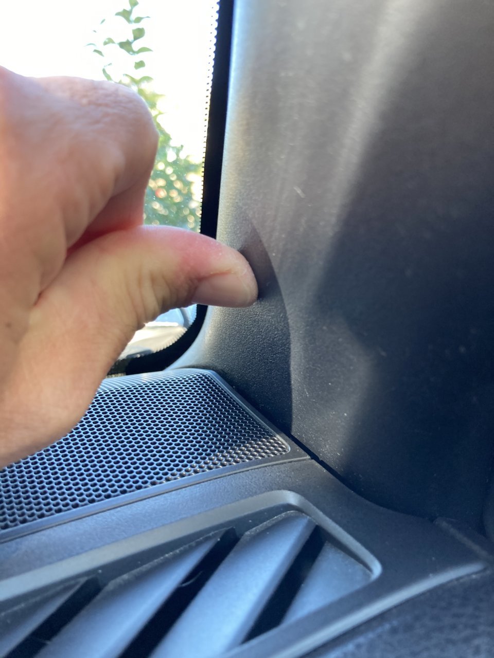

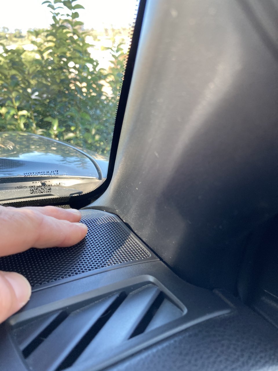

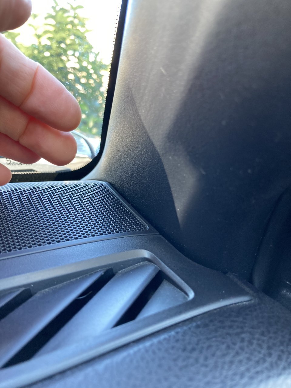

    I have a rattle inside the cab at the junction between the passenger A pillar and the front dash speaker grille. Does anyone have ideas on what type of product might work to eliminate the noise?

    It's super low tech, but I just folded up a piece of paper and shoved it down in there. It's hardly noticeable, and the rattle is gone now.

    if it’s due to plastic rubbing, maybe Tessa tape on one of the surfaces

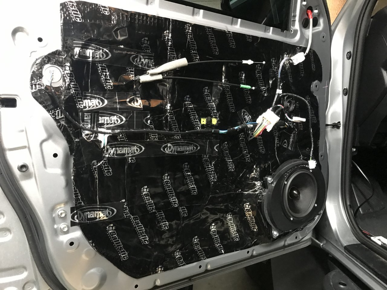

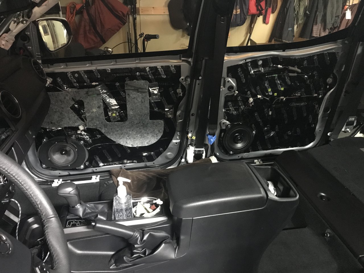

    Doors and back wall was noticeable improvement.
