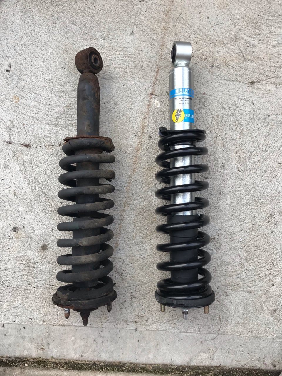

    Reviving the thread! I did quite a bit so I will run a recap and then try to keep the thread a little more active.
    So to start off...I got into an accident...that slowed me down. I spent a pretty penny to get the truck fixed since it holds sentimental value to me (it was my grandfathers truck). Once I got that fixed, I jumped right into the front end suspension. I ended up going with 5100s with OME 881 coils in the front. It was RUSTED...PITA of an install. Took a before and after of the madness.

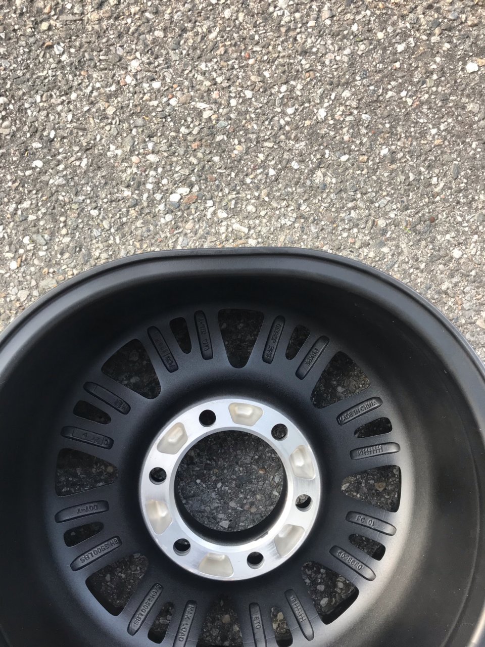

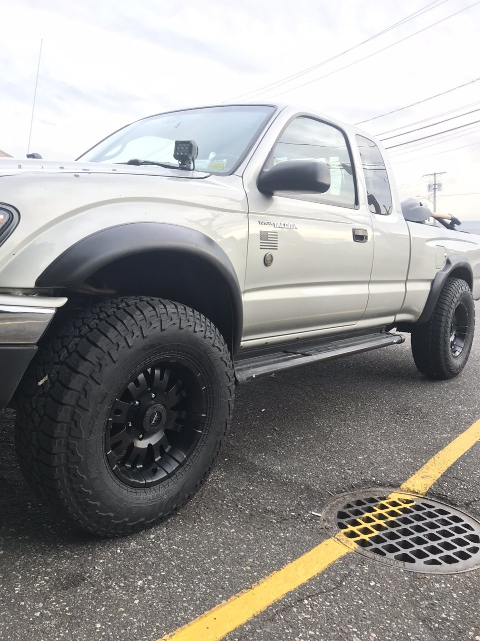

    Next up I got new tires and wheels. Ended up getting 265/75/16 Falken WildPeaks on Pro Comp wheels. I got two wheels shipped that were pretty badly bent. 4 Wheel Parts customer service was nothing but amazing in getting me new wheels and threw in some free goodies. I had spacers on which gave me some serious rubbing...had to get rid of the spacers and that solved my issue.

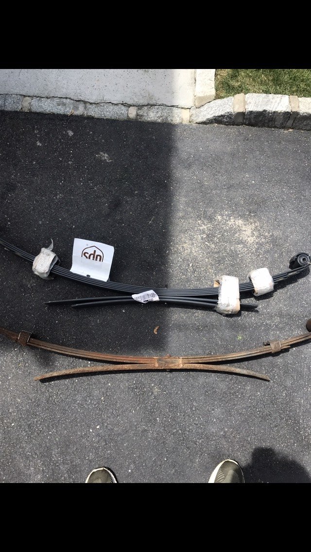

    Then along came the 5100s in the rear as well as the OME Dakars. Once again...PTA...I should just rename the thread 'PITA'. I got all new hardware, and cut EVERYTHING out of the truck since it was so rusted (I learned from doing the front end...). So new greasable shackles, new leafs, new lower shock assembly, new bolts, etc. Loctite everything, anti-seize everything and prep for the future. I wire wheeled everything and POR-15'd the rear end (not all of it yet). I am getting some of the frame welded/patched with safetcaps soon so I didnt touch those areas yet.
