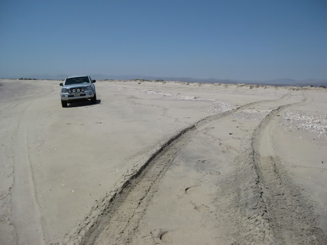

    This photo taken the next day is the deep tracks I made before deflating:

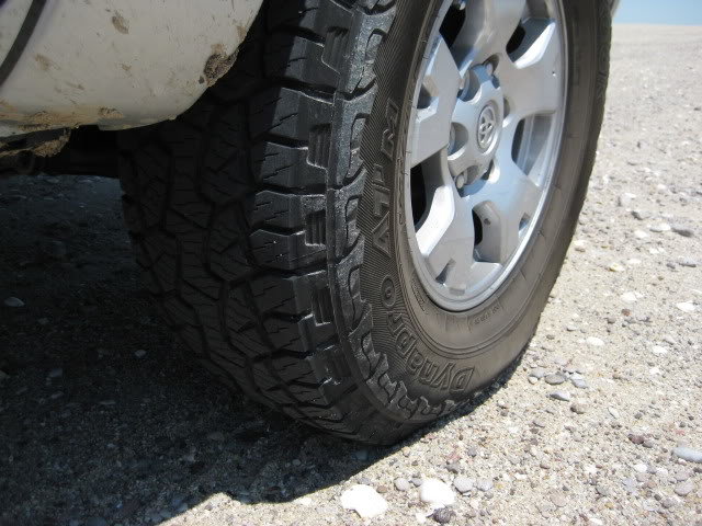

    See the tire at 18 psi not digging in, but floating on top (note track on left, above):

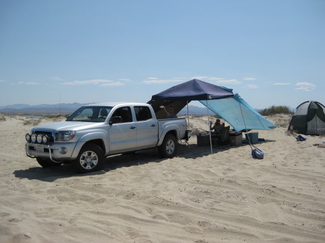

    However, with the right amount of air removed, driving on deep, dry sand is not a problem... Here, I backed up to our sun shade...

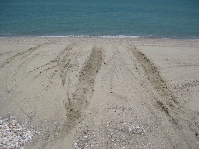

    In this photo I took looking down over my tracks, the deep torn up track is with the rear locker on... and the tracks just to the left of them is using A-TRAC instead of the locker... (the H4 tracks looked the same as the A-TRAC test):
    It was more of a surprise for me to see how bad the rear locker did than it was to (again) witness how good the A-TRAC is.
    The A-TRAC continues to impress me as the greatest advance in Toyota traction systems to date. Just making all four tires rotate the same (front and rear lockers) isn't always the best way to get over something... A-TRAC senses the rotation speed of all 4 tires and prevents spinning that would sink you or stall you by transfering power to the best tires to keep you moving. Because your differentials are open when there is no need to transfer power/ match rotation (no spinning tires), steering is unaffected... makes the A-TRAC 'golden' for tough trails.
