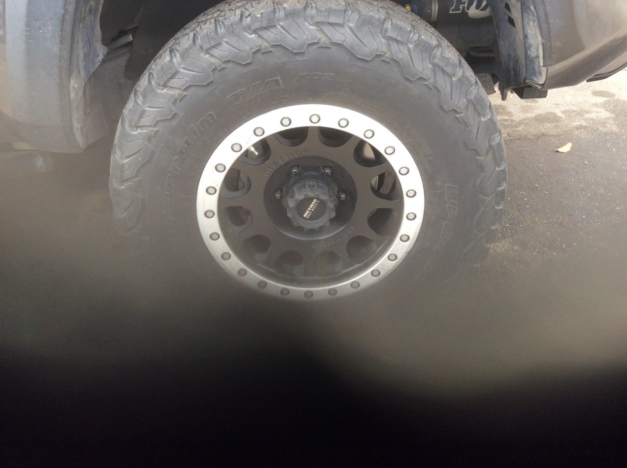

    Does any know where I can get my tires changed. Went to calderons and they said the don’t mess with real beaded lock rims so I’m looking for a shop that does.

    If you don't mine installing then yourself, they are easy to install. No shop needed expect for balancing and airing if you don't have a air compressor. Just watch the videos on youtube.

    Breaking the bead yourself with a jack can be pain though, having to do four tires.

    These are real bead locks. Pretty much unbolt the bead plate and tires slides right in and out.

    The outside bead comes off when you remove the bead ring yes. Still need to break the inside bead.
