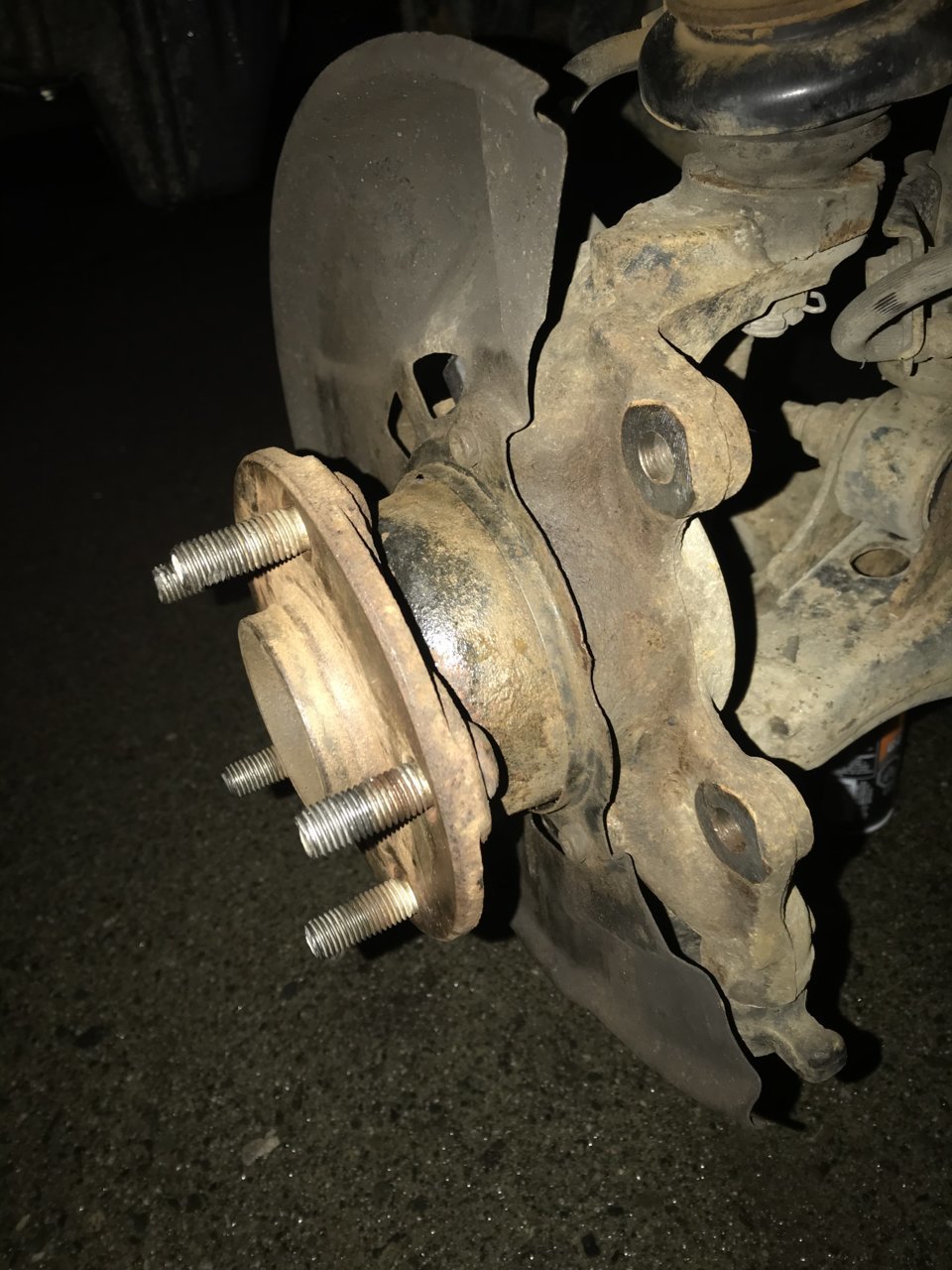

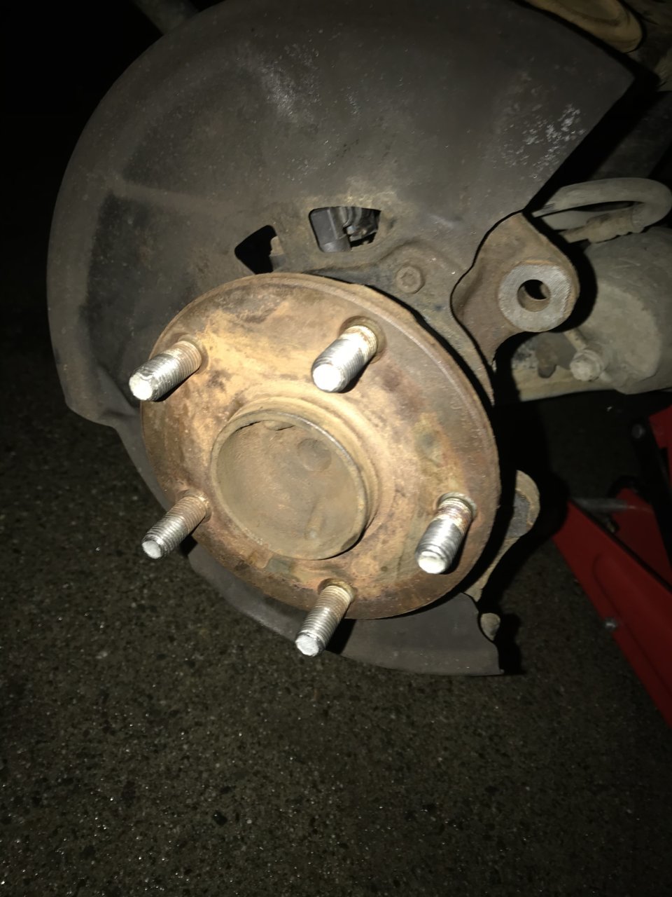

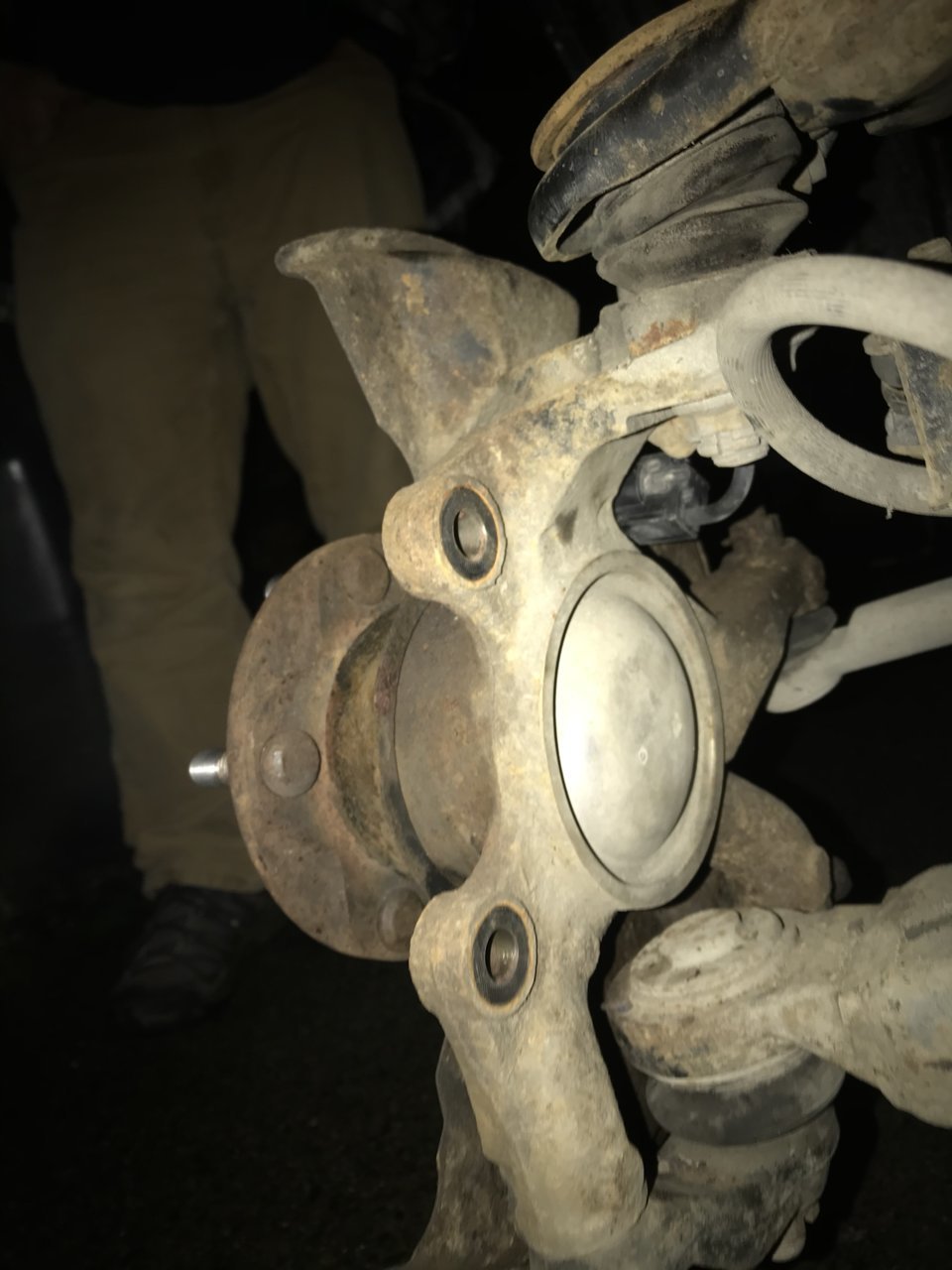

    Hey, having to change the bearing hub for my 5 lug 2007 4cyl 2WD. The 6 hub assembly seems to just be bolted on with 4 bolts but my 5 lug has nothing to remove. Wondering what I need to replace or can the bearing be pressed out? Thanks!

    The cap on the back unlocks all your secrets.

    Pop that big cap off on the backside.

    Oooh fantastic, thank you !
