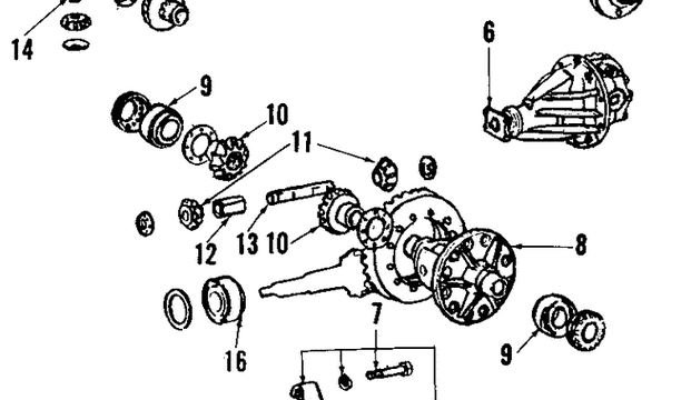

    Looking for help finding the part number for the rear differential carrier bearings for a 3rd Gen SR with 8" axle. (My truck is a 2023 SR Access Cab 4x4 3.5 AT) I'm installing a Detroit True Trac diff.
    #9 in the photo, I believe.

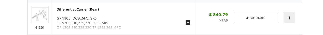

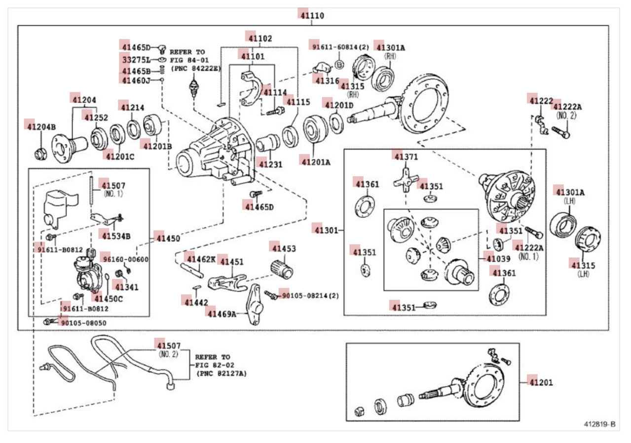

    Got to Parts.Toyota.com
    Type in your VIN, then type “Differential Carrier Bearing”
    It’s located under the “Rear Axle Housing & Differential” section.
    The reason I didn’t provide the # is, I’m not too familiar with what models had the 8” diff.
    But I know it’s listed.
    NOTE: THE PART # SHOWN MAY NOT BE CORRECT.
    It’s only there to show that it is listed on the site.
    You need to verify it by your VIN #AF752FFF-3218-4470-8380-244FBC4E8EBC.jpg0767DC04-46F7-42A4-A2F9-10FE29910815.jpg
