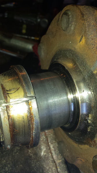

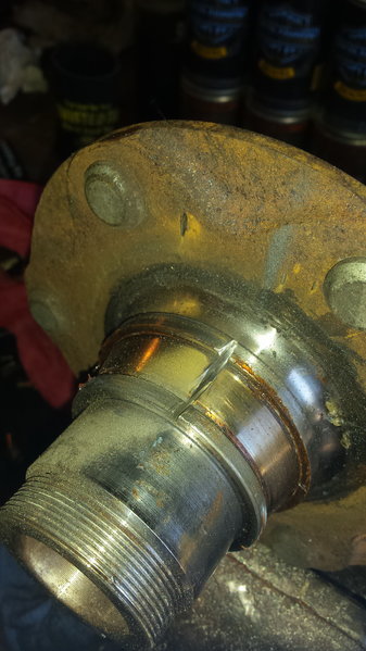

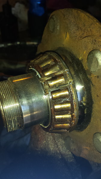

    You have pics? I believe the prerunner hubs are different than 4X4, but I don't know in what ways. For 4x4 hubs, the most effective way to remove the inner race from the hub is to make 2 or 3 cuts into the race111111. That will release tension and the race slides out with relatively ease.

    That's exactly what I have to do on bottom inner race after hub got press out.

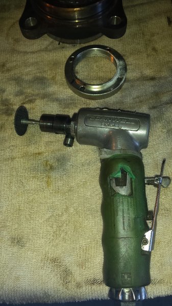

    20170208_160143.jpg Cutting it off actually ended up being very easy. I didn't even have to cut all the way though. I hit it with a hammer and chisel once I thought I was deep enough and it started to slide right off. So I would say for ease... just cut it off.
