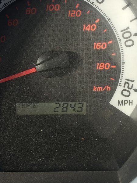

    Light turned on at 284.3 miles.
    Fuel up took 18.019 gallons.
    So here comes the math part.

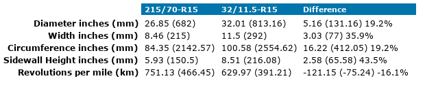

    284.3 miles is what the ODO states, but that's based on stock tires. I sized up. I have to accommodate for upsize. Have to multiply by Revolution per mile(First Pic).
    284.3 x 1.161 = 330.0723 TRUE MILES TRAVELLED
    330.0723 / 18.019G = 18.32~ MPG

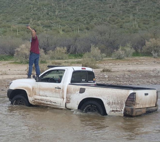

    Did better than my first post!
    281.1 17.373
    18.78~
    Pretty good with a weekend of camping,offroading, and river crossings.

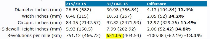

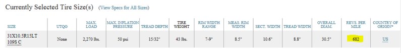

    I don't know if I would trust the tire calculator that TW has. I come up with 2 different numbers for Revolutions per Mile. I am running 31x10.5 BFG, TW calculator shows 651.05 revolutions per mile whereas BFG shows 682 revolutions per mile. I would go with the number from the tire manufacturer to calculate MPGs.
    When I drove my 5 lug off the dealership it came with Dunlop Grandtrek AT20:
    TW calculator specs:
    Below shows the specs on the BFGs I am currently running:upload_2017-2-28_20-45-6.jpg
    So when I calculate my MPG I use the specs from Dunlap and BFGs specs, the difference for my setup is -11.89%. Not the -13.33% shown on the TW calculator. Its not much, but that difference will affect +/- MPG data.
