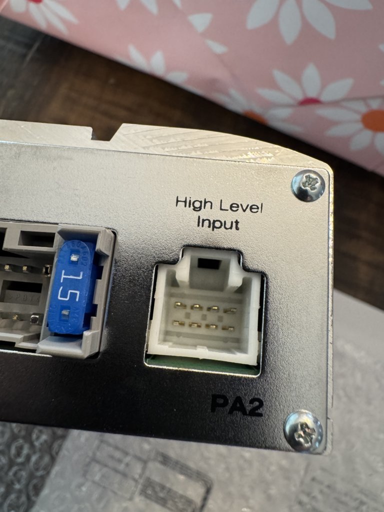

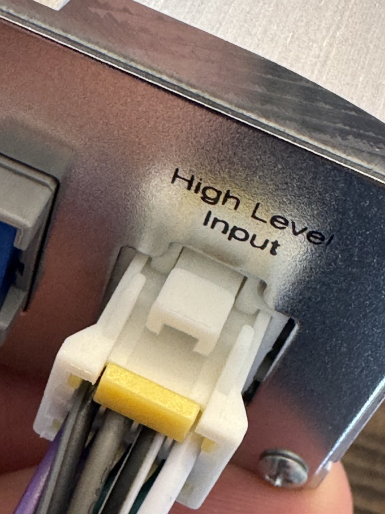

    IMG_0773.jpg IMG_0770.jpg So I purchased this little amp and received it yesterday. I’ve got to say that the quality seems questionable. The high level input connector inside the body of the amp is super loose and the loomed connector just doesn’t want to be connected. It’s super tight and doesn’t give a firm “click”. Forcing it any further feels like the amp-side of the connection will just collapse inside the amp, or break.
    I’ve emailed Meraki to see what they say, maybe this one needs to be replaced. Anyone else have difficulty with this input? The pic shows the input inserted as far as it’ll go, but no click. Pins are straight.

    A little bit of dielectric grease on the connector and it seated. All went together fine and it’s up and running. The extra watts helps the system sound better , but still just OK. Speakers will be next.
