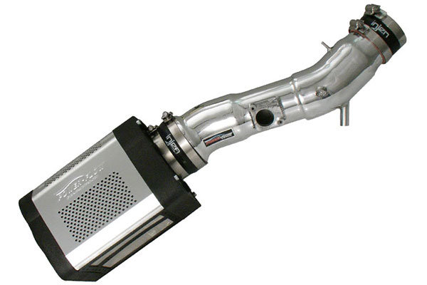

    What about injen cai

    Is this the injen you're talking about?
    If so, I'm interested in any pros and/or cons also!!
    Injen Part #'s:
    PF2058WB (Wrinkle Black Finish)
    PF2058P (Polished Finish)
