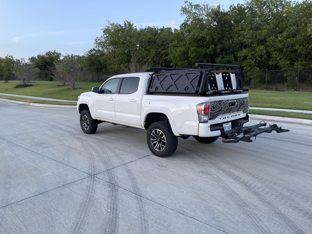

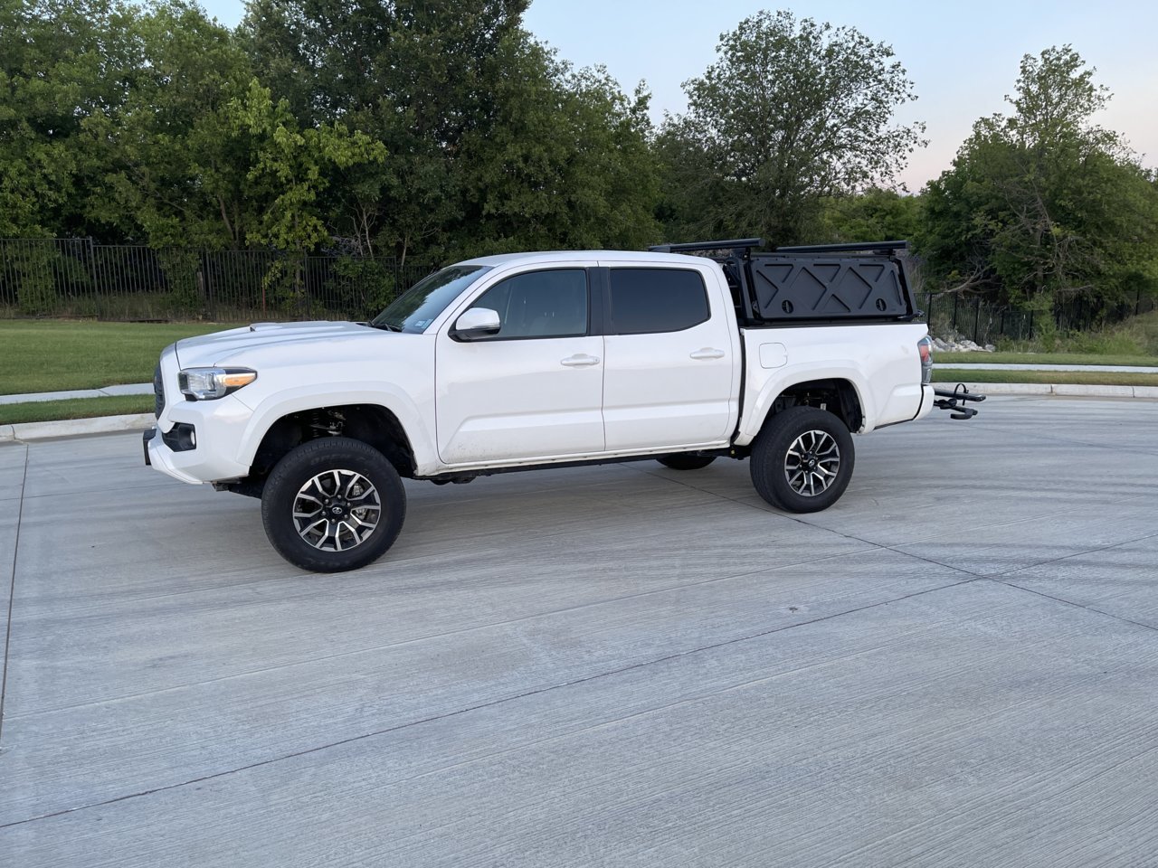

    This is what a '21 TRD Sport 4WD DCSB looks like on factory meats (Toyo 265 65 17) and stock rims with the OME-005 (2inch ARB/Old Man Emu Heavy Load kit). I would not recommend the Heavy load coils and leafs unless you regularly have 600 - 800 lbs of static weight at all times. The 2886 front springs and the heavy dakars are stiff AF and perfect for my use case but probably not yours. The lift ended up being ~ 3 in but I expect the suspension to settle in the coming months. Check out this post if you want my before and after pics. I also installed SPC UCAs for adjustability (4 deg caster) to accommodate 285 70 17s that will be going on next month.
    Before
    Driver Front 35" Passenger Front 35 1/2"
    Driver Rear 35 1/4" Passenger Rear 35 7/8"
    After
    Driver Front 38" Passenger Front 38 1/2"
    Driver Rear 38" Passenger Rear 38 1/2"
    Edit:
    • No issues with any of the sensors (dynamic cruise, lane departure, or collision warning)
    Alphadog24x7[OP] likes this.
