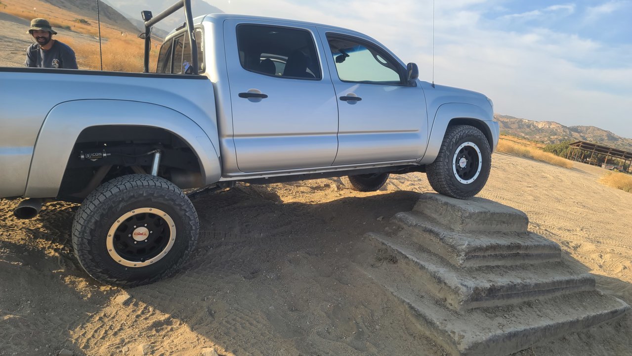

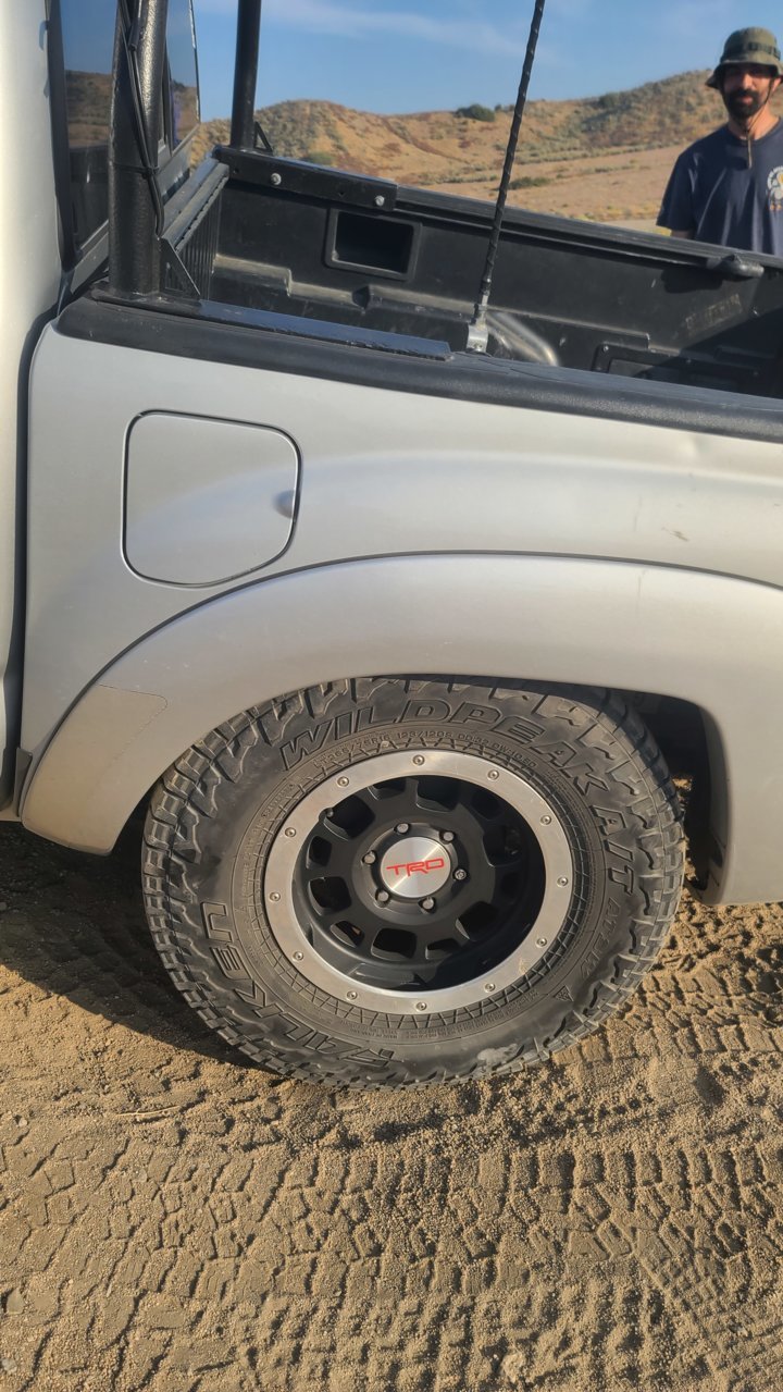

    So I've read up on sway bars a lot lately after my last excursion on some trails. I felt like I could really benefit from some additional flex in the front. After some research, it's a real shame that there's no options for Tacomas to have a quick disconnect system.
    I have an idea, and wanted some feedback from some of you whether you think it would work or not.
    I'll be removing my sway bar to make sure I'm comfortable without one before I start modding, in case something goes wrong with my experiment and I end up without one because I goofed or something doesn't go as planned. As for my idea (which may or may not be original, I don't know):
    As you know, we can't remove/disconnect our linkages without risking damage to steering/suspension components during articulation. Otherwise this would be a viable option. So, I got to thinking. Would it be possible/sustainable/reliable to chop the sway bar in the center and insert a steel sleeve over it between the bushings, and then drill holes on either end (and matching holes through the sway bar) and use pins to connect the sleeve to the bar? Fabrication isn't my thing. I know this would be possible but would it be strong enough to hold under normal driving? The pins would likely be the weak point in this system I would think, or maybe at the sleeve where they go through. The downside to something like this would be having to take off your skid plate every time you want to disconnect/reconnect but for someone wanting the best of both worlds it's a lot better than trying to uninstall/reinstall the sway bar every time you want to hit the trails.
    This system would allow both ends of the sway bar to stay connected, but be disconnected in the middle and allow it to twist. When the sleeve is reattached via the pins, the sleeve takes the place of the sway bar where it's chopped. Essentially, the sleeve would be acting as the sway bar.
    Like I said, I'm just looking for opinions right now. I'll be running my truck without the sway bar for a couple weeks to make sure I'm comfortable with it in case this doesn't work out how I'm thinking it would. In my head it seems viable.
