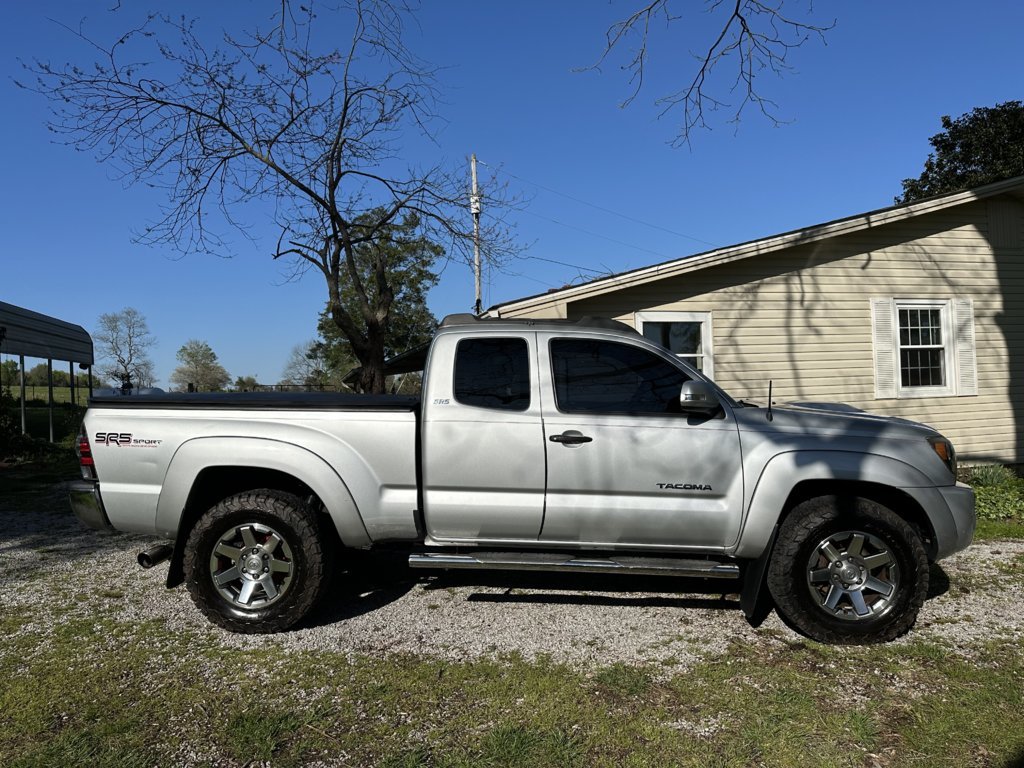

    Hi yall, I just purchased an 07 taco with the 2TR engine. Thought I’d found a good one, but now I’m nervous. It seems it’s consuming quite a bit of oil. I did the first oil change on it and it has a very slight timing cover leak. After 3k miles I thought I better check the level. To my surprise it was bearly registering at the bottom of the dipstick. Not even in the safe zone dots, like the bottom of the dipstick. I’m surprised I wasn’t hearing any valve train chatter with it that low. It took more than a quart, maybe closer to 2 to get it topped back up.
    So now I’m not sure what to do. I love this truck. It’s super clean, and it has 205k miles on it which i thought would be fine given its maintenance history and cleanliness, not to mention this is supposed to be the “million mile” engine right? RIGHT? Wrong I guess.
    I started searching for oil consumption issues with these engines, come to find there’s a lot. Most people claim the oil control rings fail. Someone said they had a “soft recall” for a bad batch of them? So getting new ones would likely solve it for a long time. I’ll run a compression and leak down test later. Can anyone confirm this “soft recall” bad batch deal? Or have you had luck replacing the oil control rings and getting more than 200k more miles after?
    I’m sure it’s consuming oil and not just from the slight timing cover leak. I used to do oil consumption test for Audi 2.0T cars all the time back when I worked as a dealership tech for them around 2013-ish. So save your “it’s probably the main seal” etc comments.
    I just don’t know where to go from here. How much longer should I expect this engine to last? Just another 100k miles? Audis spec back then was any more than 1qt per 1000 mi was unacceptable, and it seems like I’m around a quart every 1500 miles right now.
    And what would the next step even be? Seems like most people just get a new engine because they’re not that expensive, like $3k for a new one + labor. But the 2.7l is so underpowered. I know everytime someone ask about swapping the 4.0L in everyone says to just get a factory 4.0 truck instead, but these trucks are getting increasingly hard to find without rusted frames, and to be frank I don’t have $15-20k to buy one of those. I managed to get this one for $8k, which was nice and I thought I had done well. To be fair I don’t think the PO knew it was consuming oil.
    I would love to put the tundra v8 in this truck but it’s not realistic I don’t think. I’m getting older now and done playing with engine swaps, in fact I’d likely just let the Toyota dealer put a new 2.7l in it unless a 4.0 swap can be plug and play provided I have the harness and ECU of course, but I think I read it still needs a stand alone bc of body module communication problems? Can anyone confirm?
    Anyways, I’m super bummed. I thought I’d have this truck for a lot longer before having major internal issues out of it. I’m tempted to sell it, but the wheels, roof rack, and all is nice. I spent months trying to find a clean access cab sr5 manual under $10k. What should I do?

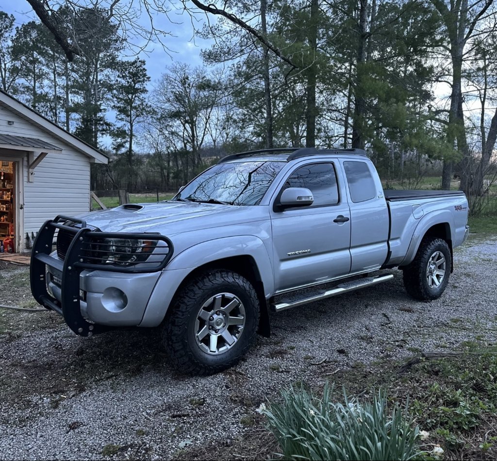

    here’s what it looked like when I got it. All I’ve done so far is change the engine oil, put factory headlights and a factory trd pro grill on it and take off the brush guard and runners for the roof rack.
