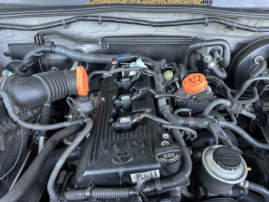

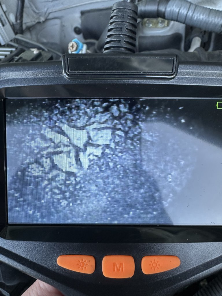

    Thanks for the input guys, so I started the soak today, we shall see how it goes!
    And yeah the only reason I would want the 4.0l is for the power. The 2.7 isn’t bad, but in TN there’s lots of big hills. But I’m getting used to just keeping the rpms up and downshifting to 4th on the interstate lol. On the other hand, LCE is making supercharger kits for the 2.7 now, but I ain’t about to spend that kinda money on this truck.

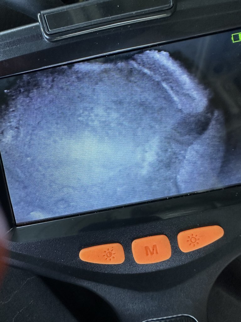

    so anyways, the trucks been sitting for a day so everything’s nice and cold, I pulled the plugs and they look decent, the mixture looks fine, none of them were wet. I decided to grab the borescope and check out the piston tops, wish I could’ve seen the walls better but my good borescope broke so I’m using this dinky one I got as a backup from tiktok shop. It was $10 and it’s basically a child’s play toy so the photo quality ain’t great, but here’s how things looked:
    ^clylinder 1. Looks pretty clean, can even make out the divots on the piston head.

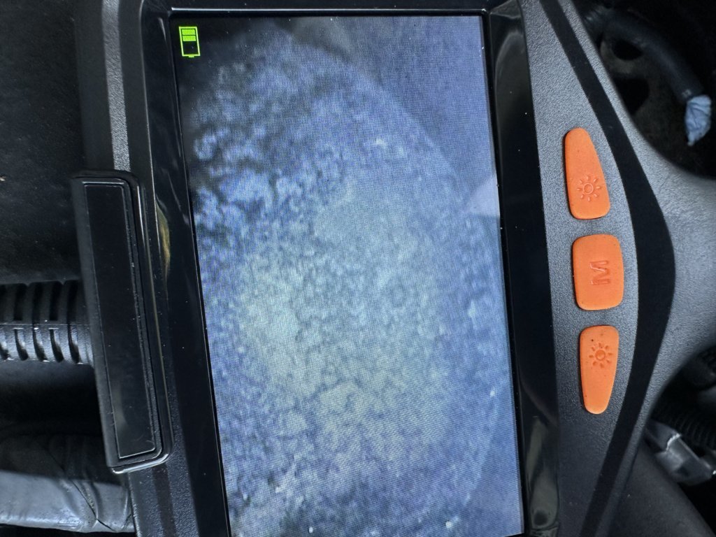

    ^ #2. Definitely some carbon build up, perhaps this is my culprit cylinder. Unfortunately the engine stopped with #2 & 3 almost at TDC so I couldn’t actually see the entirety of the piston top. I did get close up on 1 & 4 just to make sure having the camera this close wasn’t fooling me. #2 is definitely more dirty than the others.

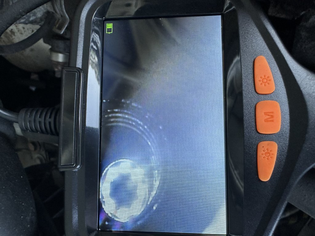

    ^#3 also quite dirty with carbon build up. Not sure if equal to, better than, or worse than 2, but leaning towards slightly better than 2, not by much tho.

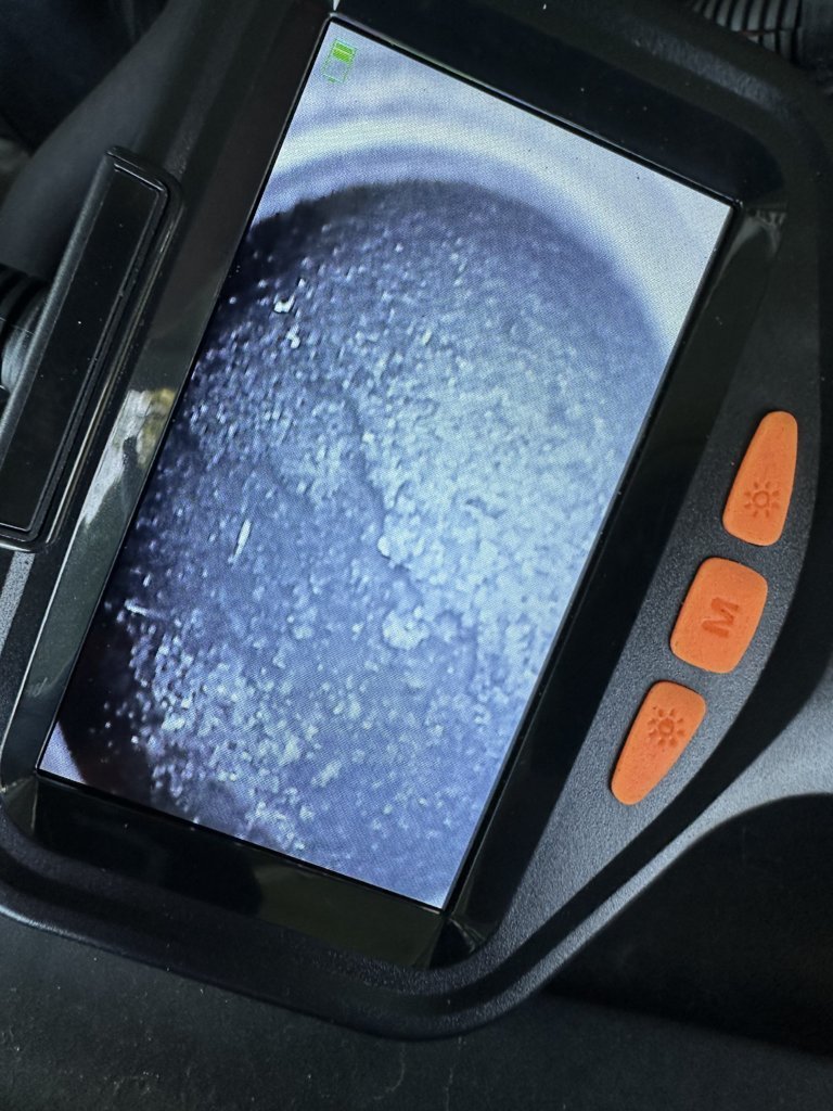

    ^#4 just as clean as cyl 1. No worries here.
    so with that, I got a funnel with a hose attachment and loaded all 4 cylinders up with berrymans brand cleaner. I did a test a year or two ago of Berryman vs seafoam when I was cleaning some old Bosh K-Jetronic mechanical injectors on my buddy’s VW rabbit. The berrymans cleaned much better so it’s my go to now. I loaded it up with probably far too much, I used almost all of one of the tall boy cans.
    one thing I did notice… there was some funky build up with a light oily film around the coil packs both above them in the valley and under their rubber weather seals. The spark plugs were looser than they should be imo. Someone has defiantly changed them. There was dielectric grease all over them. I should’ve taken note of the part number, they were denso atleast, but I could tell by the fat electrode tips they were cheaper ones. I’m usually not much of a fan of iridium plugs but what material plugs are y’all running? I reckon I’ll change them while I’m in here.
    with that done, I critter proofed it
    (god I miss having an actual garage), thankfully I have a motorcycle to get to work and back the next two days while it soaks, so Saturday I’ll suck the excess out with my vacuum brake bleeder tool and change the oil. And then we shall see how she does! Got my fingers crossed.

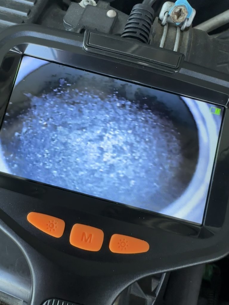

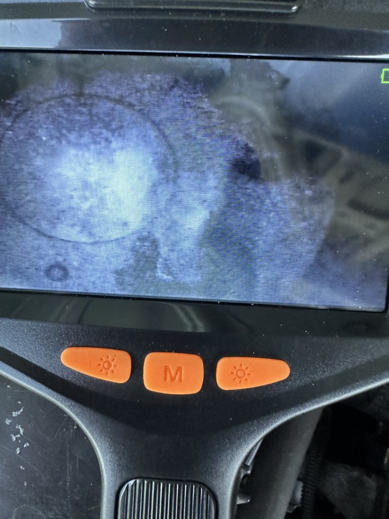

    Alrighty. The trucks sat for 48 hours with the cylinders halfway filled with Berrymans B12, so I decided to check on things today.
    cylinders 1&4 had completely emptied and looked…interesting. Cylinders 2&3 were still submerged in cleaner.
    ^cyl 1
    IMG_5343.jpg ^ cyl 2&3 couldn’t see anything but my reflection. I tried submerging the camera but couldn’t see anything notable.
    ^cyl 4
    So kinda interesting that the problem child’s 2 & 3 didn’t drain the b12 past the rings much after 48hrs. I should probably rotate the engine some to work the rings. I’ll do that tomorrow. For now I just topped it up with more b12 cleaner. Sunday I’ll do the oil change finally. I picked up some Marvel Mystry Oil to throw in when I change the oil so maybe that’ll also help. They’ve got a new synthetic formula. I’m not much of a fan of “mechanic in a bottle” concoctions, but my engine building grandpa swears by the stuff so I figure it can’t hurt, and beats tearing the engine down.
    The only part of this process that has gone awry for me is the spark plugs… I’m pretty sure #1 is stripped out. They were all pretty loose when I went to remove them. Like maybe 4ft lbs tight. Which was concerning. I know nobody ever looks at torque specs on things like spark plugs but if you’re wondering it’s 13ft lbs according to my manual. So when I went to reinstall them two days ago I felt the plug on cyl 1 start to get a little tight (like just snugged up, not overtight) but immediately felt looser. It’s still tight thankfully, but nowhere near 13ft lbs. I was not using my torque wrench, but I have never used it on plugs and I replace plugs on engines almost every day working in the motorcycle and automotive industries for the last 17 years. I’m pretty in tune to what 8ft lbs feels like because pretty much every motorcycle engine side cover is 7-9ft lbs. and I do use my inch lb torque wrench when I do that. That’s why I’m certain these plugs were at less than 7ft lbs when I removed them. I also noticed the plugs look like they had anti seize on the threads. That’s a big no no in my book on aluminum heads. Too easy to strip for the average joe. And I’m guessing that’s what happened. Guy probably stripped the 1st one slightly and then went very light handed on the rest.
    I can only hope it will crush the new washer when I replace them and not strip the threads first instead. I guess I’m just going to leave that plug a little looser than 13ft lbs when I do it. It’ll be fine…probably. It’s at that point where like you know it’s stripped but it still has some tightness to it, I’m just deathly scared that giving it that extra 1/4 turn is going to completely strip it, but it’s not very tight so that equally bothers me. Guess all I can do is put the new plug in on sunday and hope it snugs up enough to crush the washer but not strip. Otherwise I reckon I’ll be drilling and inserting a time sert or helicoil or something of that nature
