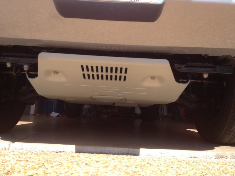

    I use "Fluid Film." It's a waxy lanolin material that doesn't harden. Supposedly, stops rust on contact and won't harm rubber. Many on here use it and approve. Some do not care for the smell though. I don't mind it myself. Lowes sells it and you can buy it on line.hthIMG_0956.jpg
