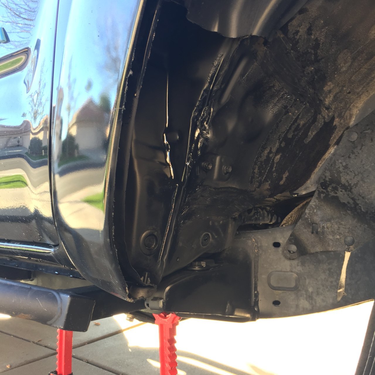

    Did some thinkin’ and cooler heads prevailed. Decided because of my lack of knowledge with body work and no closed garage, I’d take it to a shop. Super stoked on how it came out. Trimmed, pounded flat and sealed with Seam sealer. A couple coats of undercoating and no more worries.

    It looks like you only flattened the bottom half?

    Correct. I wanted to minimize the amount of trimming and modification to the pinch weld to keep as much of the factory continuity as possible.

    I don't understand. If you flattened the whole weld, then you would lose factory continuity?

    I meant in the sense of water proof continuity.

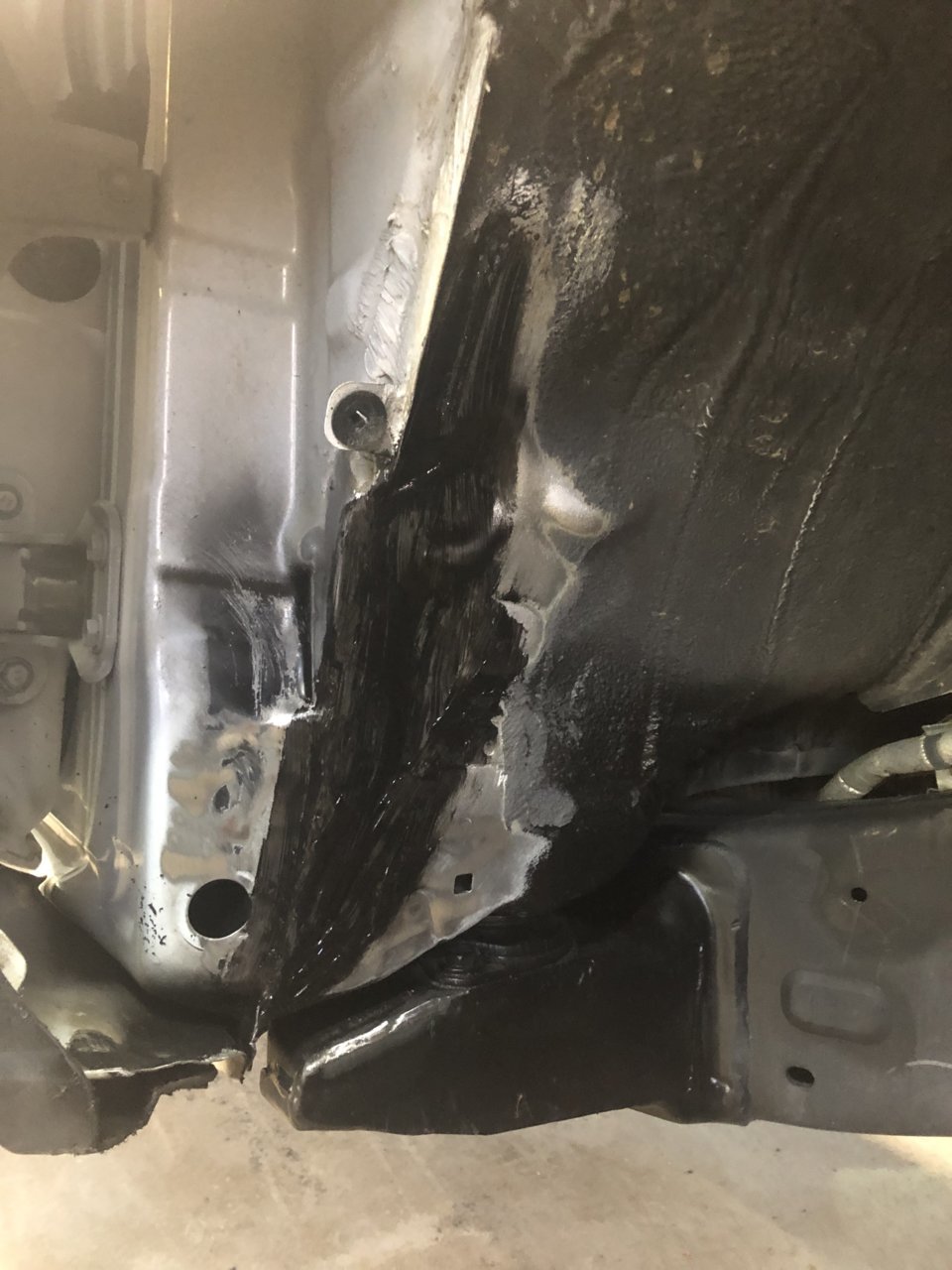

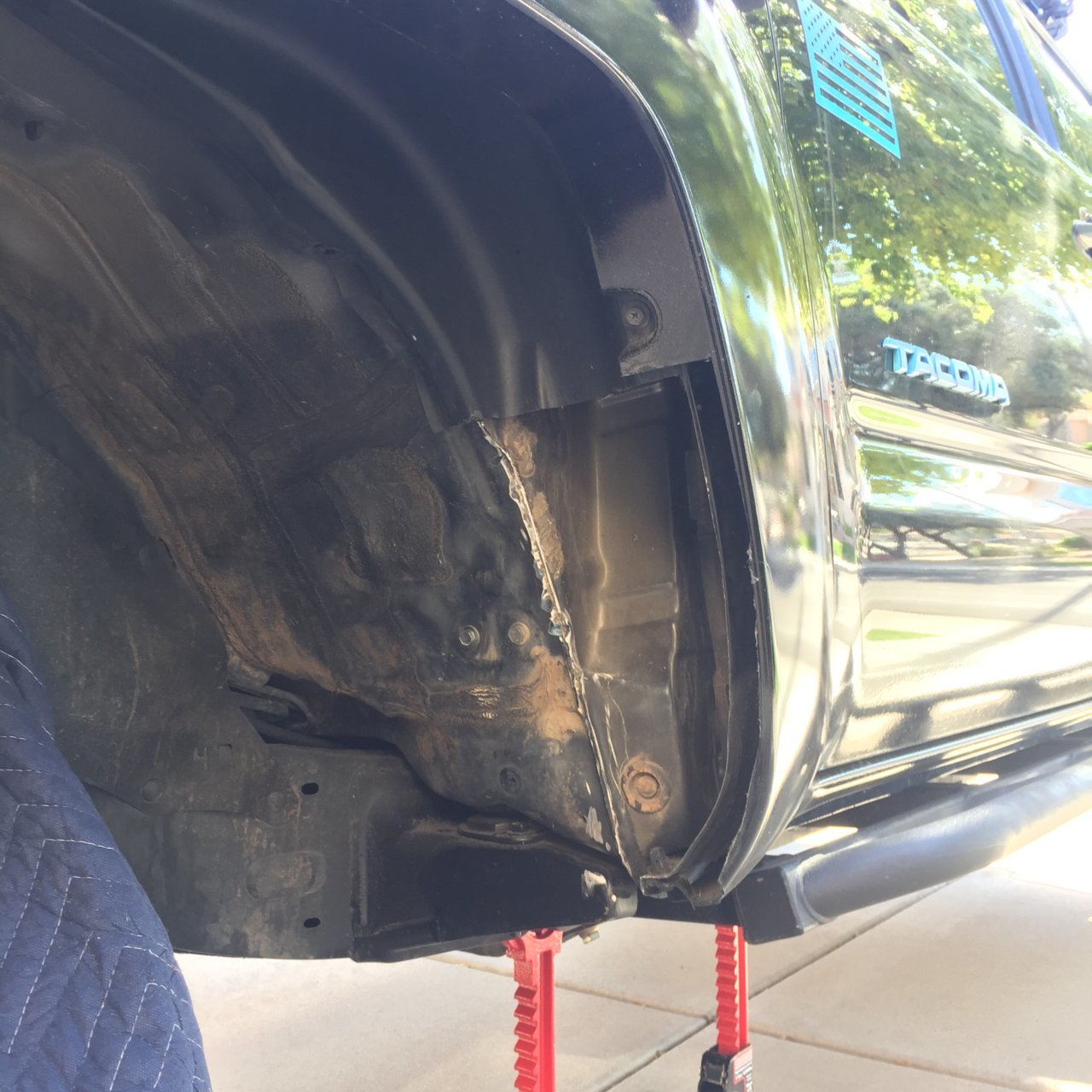

    Got the cmc, and finished cutting and grinding the pinch weld. Ran some caulk over it. No splitting, then painted it all flat black. Its been raining a lot and no rain either.

    Kinda hard to tell from the picture but it looks like part of the seam got pinched open. Idk how particular you are but maybe consider flattening or grinding down that portion to allow for a better seam when you seal it.

    The caulk got a little messy, there is no openings at all. Here was the other side before seal and paint. I also left about a 1/4 in of pinch on both sides and only went up about 8 inches cause that was all I was rubbing. Thanks for looking out though. I will make sure to double check.
