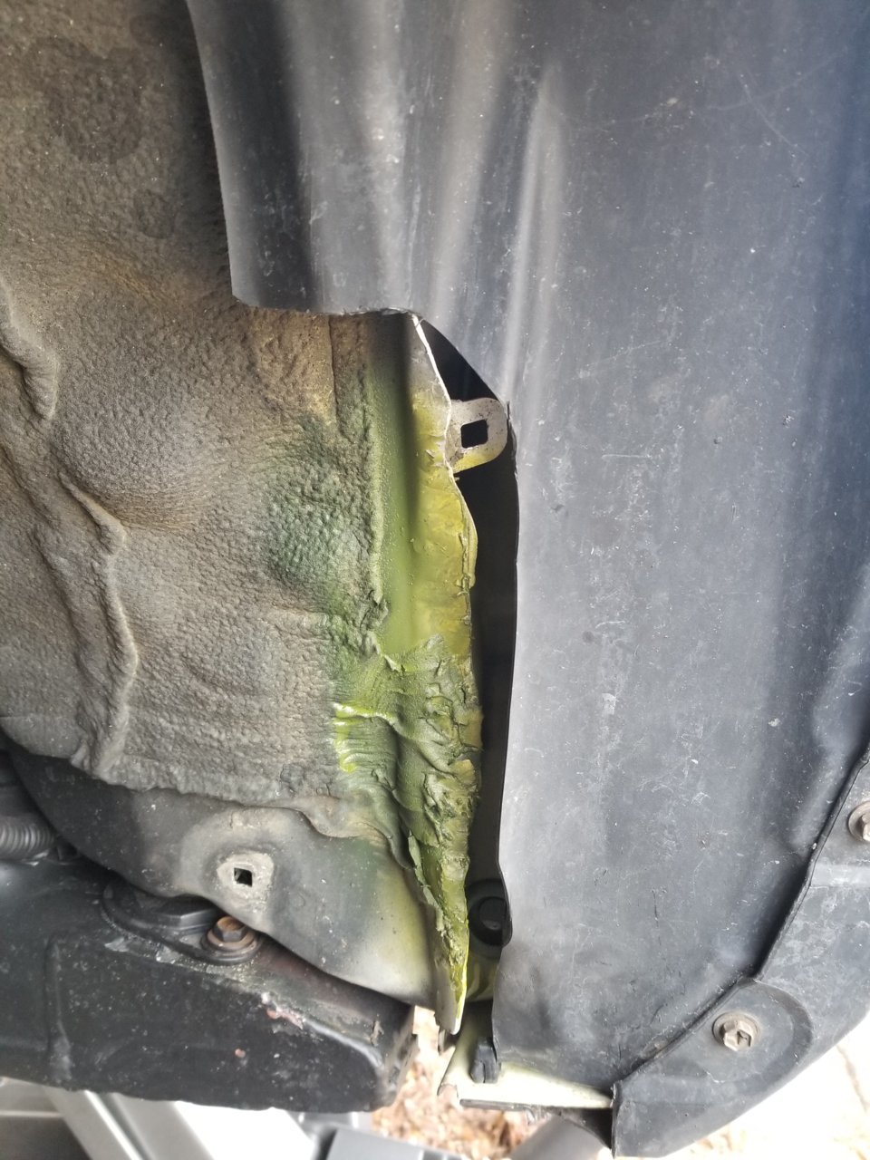

    Just did mine and the bottom was brutal no real place to get a good swing. Cut the fender liner and waiting on the 3M seam sealer to arrive. Coated the metal is Zinc phosphate paint use on out drives, should be good. The paint only comes in this green color it's just primer.
