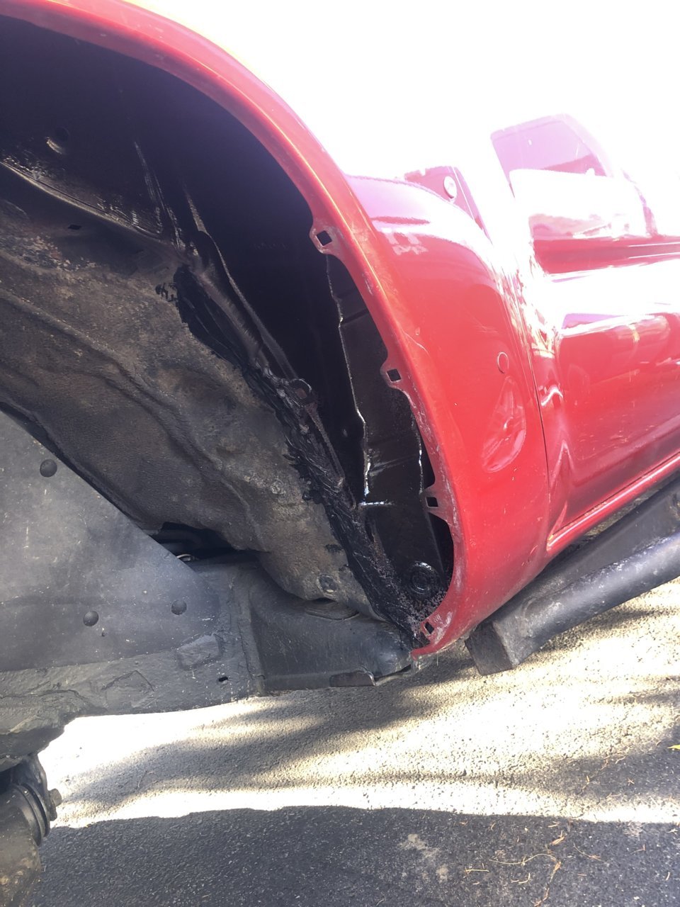

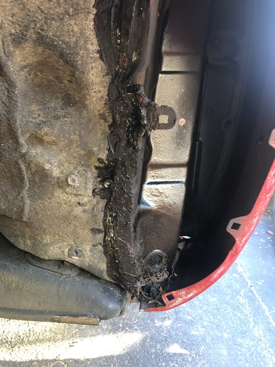

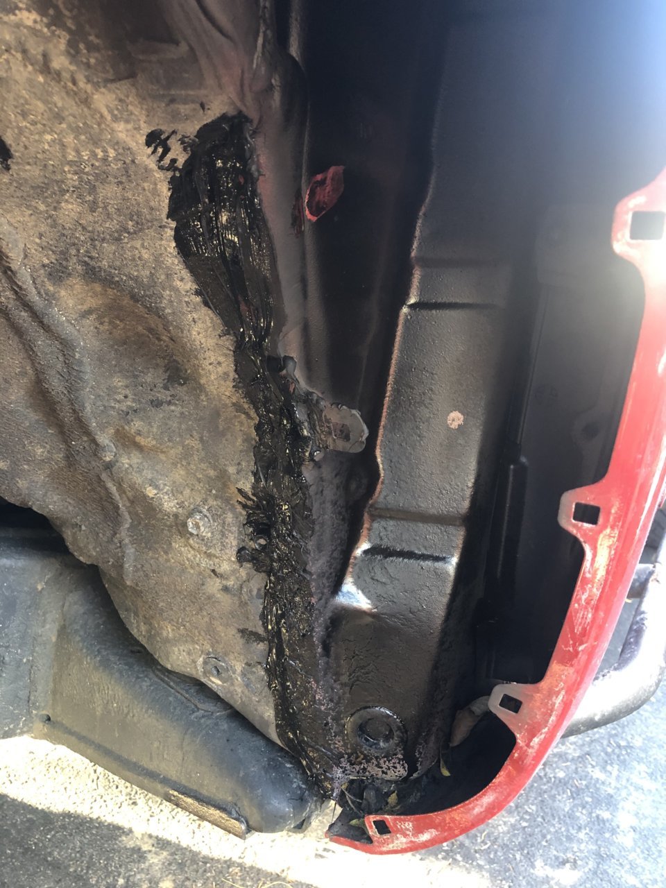

    so i cut on each side of the mounting tab to keep it in place for the liner. and bent the well inward. is it the end of the world i didn't bend it outward. the whole fender liner is stay in and just heat gun forming it out of the way

    Not the end of the world as some people have bent them inward also. Bending them outward adds a touch more clearance to my knowledge, unless there’s more reasoning to it. As long as you sealed them well you oughta be fine

    i sealed with 100% black silicone gobbed it on and let it dry then used some rubberized liner over it. didn't have any seam sealer locally

    Oh ok. Well you did say that you’ll be putting the stock liners back on so that should provide ample coverage
