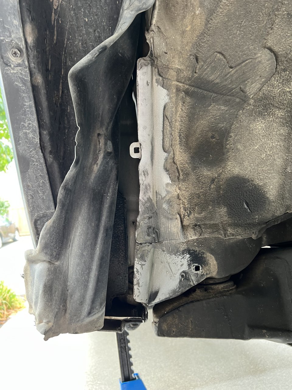

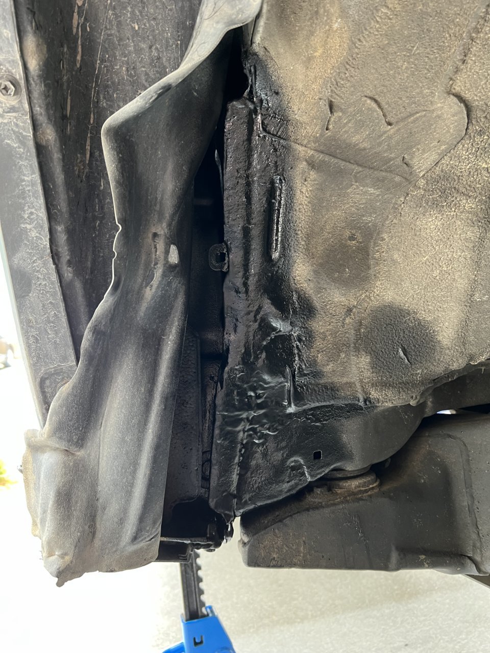

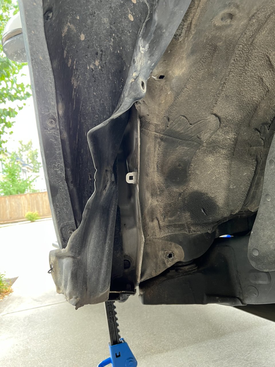

    Sorry to revive an old post! Just thought I’d give my two cents after reading through all these pages and completing this project. From start to finish it took me under two hours. Most of that time was letting the Rust-oleum Leak Seal dry. It’s a pretty simple job to do. Remove 4 retainer clips and bungee the wheel well liner out of the way. I used a 5 lbs hammer that made easy work of smashing the welds in. I kept my fender liners to keep mud and snow out of my door hinges. A heat gun to warm the plastic up and some manipulation and the wheel well liner can be pushed back further. I hope my pictures will help the next guy complete this job.

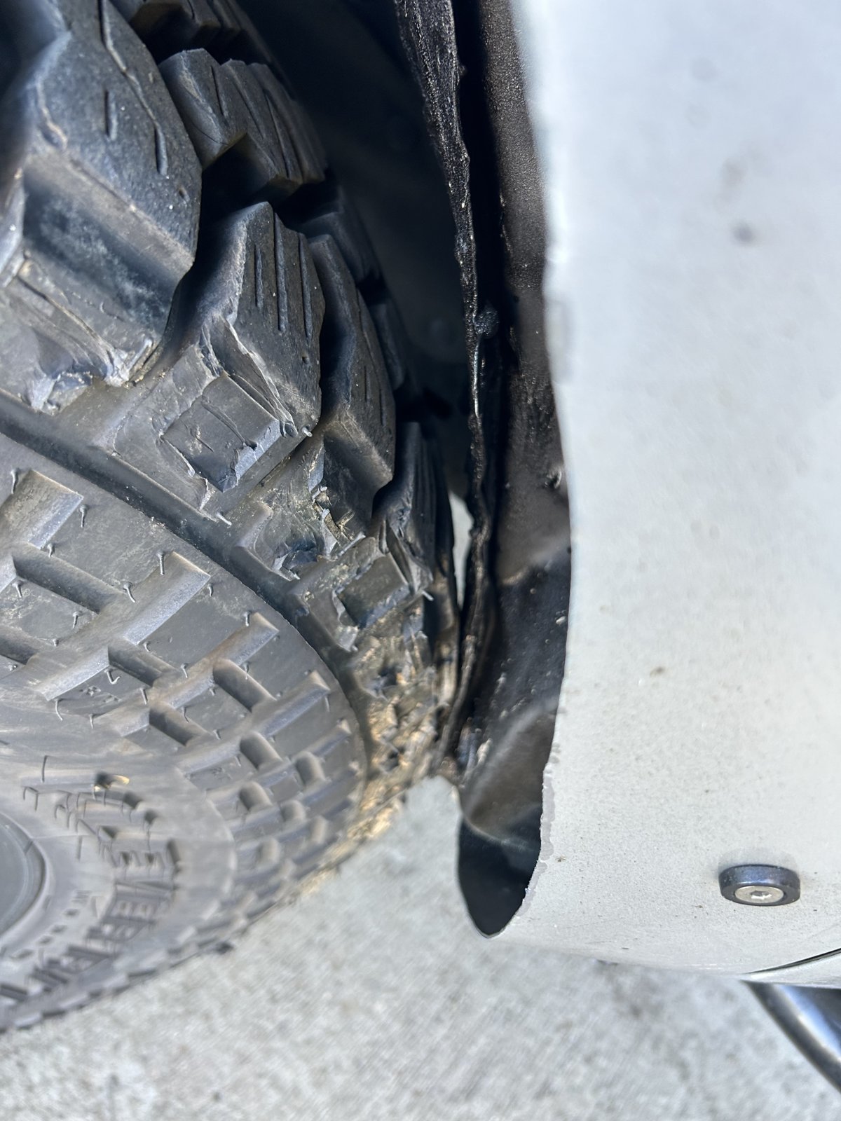

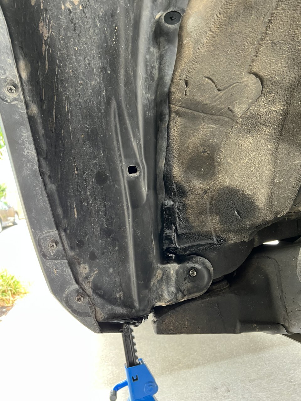

    IMG_4432.jpg might need to go back again get the bottom part more flat

    Well well well

    you know man, I shoot for 0 camber +1 caster 0 toe
    But left wheel is farther back than right
    So I’m gonna throw another alignment at it
    tbis happened when I made the trade off get 1.25” spacers to stop tire rubbing my frame
    maybe yeah. Abrade the sealant off I guess.
    last time doing the hammering I felt give in the metal
    Hit it until it maxed out and felt like no more give. Hoped that was the right way to do it.
    only next possible hammer would be a bigger hammer with zero regard to how it feels or gives.
    Not easy swinging small 3-4lb accurately with the wrong hand scrunched in the wheel well.

    Ah, the wheel spacers might have something to do with it as well. Is that pic you took at full lock? If so, BORA 0.75” could possibly give enough clearance. Increasing the caster would help too. Is there noticeably more space between the tire and front wheel well/fender?
  16. Apr 11, 2024 at 2:23 PM
    #316
    TacoTuesday1
    TacoTuesday1 Well-Known Member
    Jun 19, 2019
    #296781
    7,776
    SD CA
    Heard spacers are needed for rear shock relocate figured I’d get the spacers done first.
    pic was taken during a flex test
    Found a loading ramp to drive up and 3 wheel the truck basically
    Try and simulate off roading
    Or cycling without having to take suspension apart.
    Pulled ebrake keep the truck there
    Got out turned steering wheel while watching the tire. To see what the closest point looks like.
    Which was that. Regarding outer corner slightly rubbing the flattened pinch.
    I think the front clearing isn’t a concern until 37 or bigger and generally always has more room than the rear.
    going to mess with alignment and spring height adjust then re evaluate. As that’s easier and truck could use it anyway.
