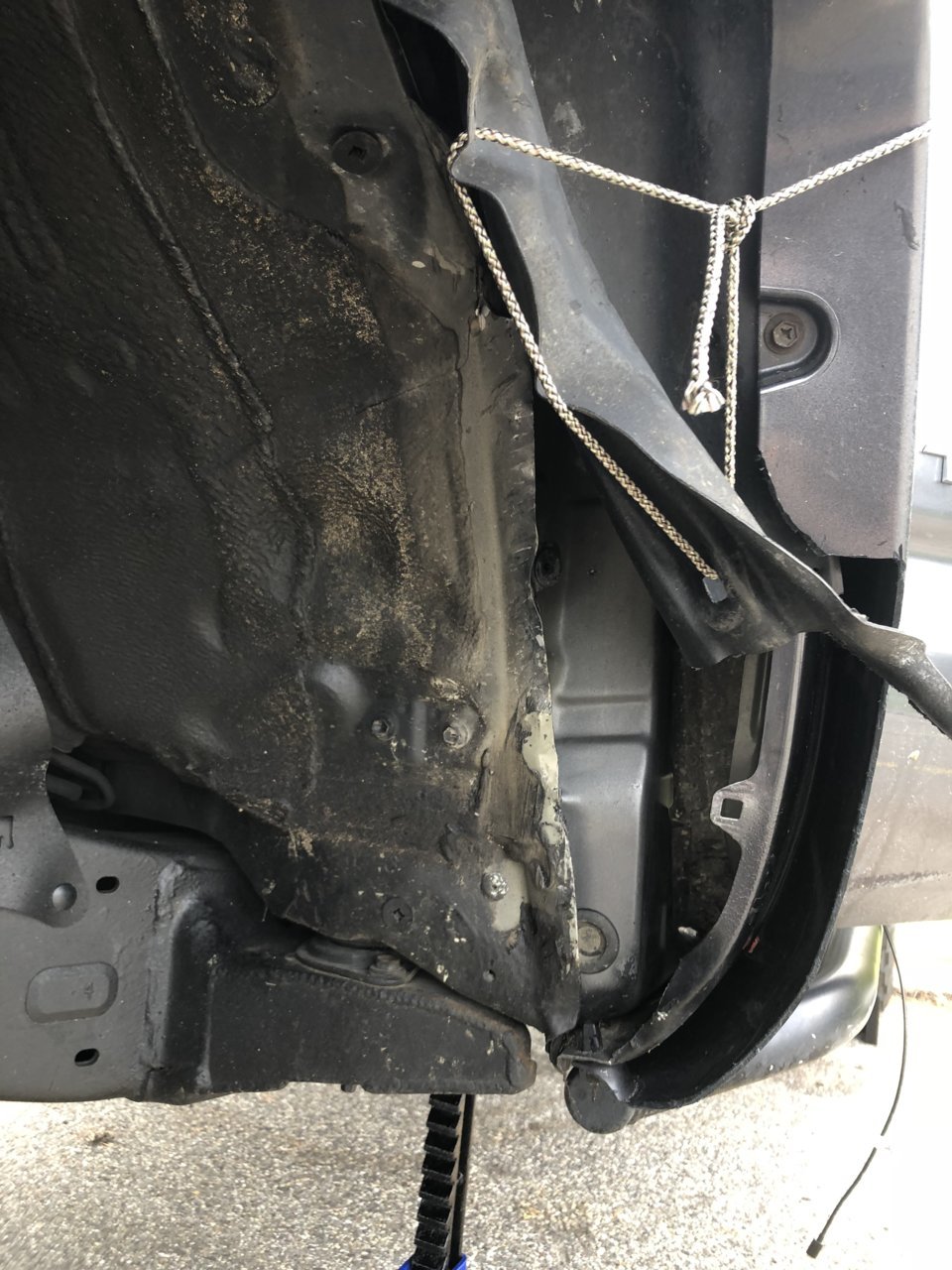

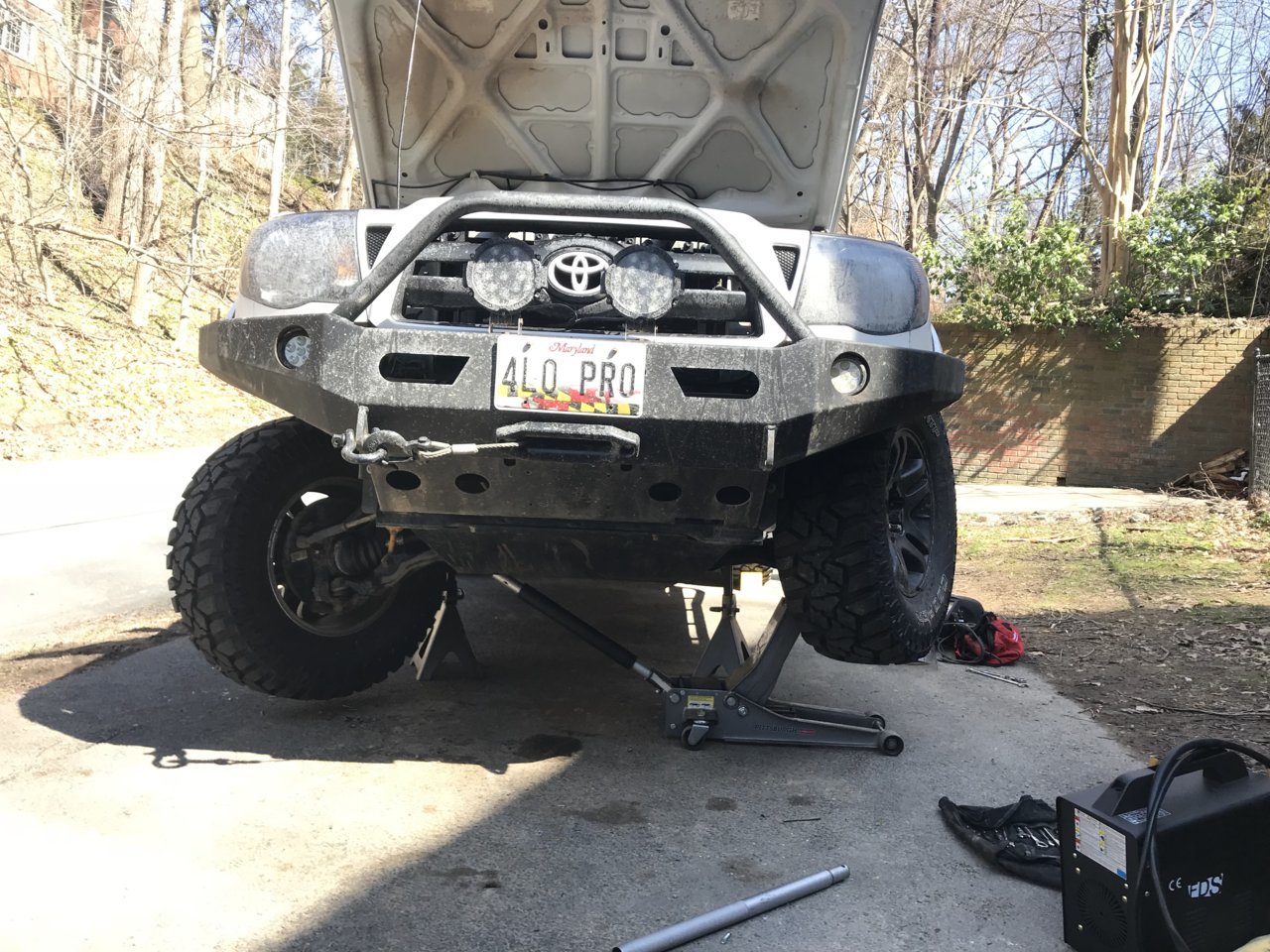

    Tommorw afternoon I’m going to jack her up and beat the pinch weld flat And seal it any suggestions on what works best for sealant?

    Taking off my tires now

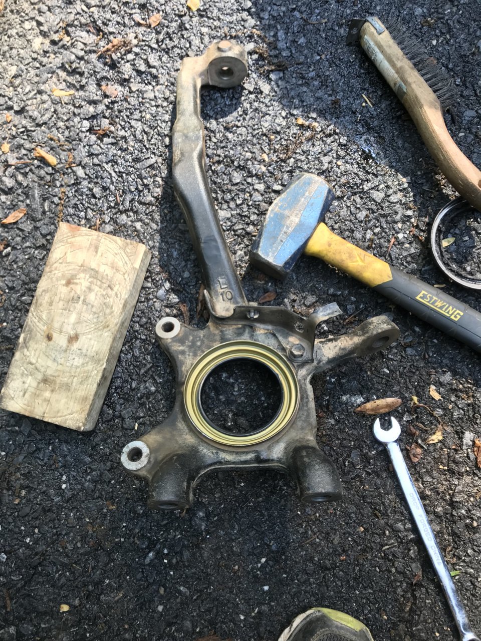

    2017 4Runner
    I just used a 3 lb sledge in mine (the one in the pic). I wouldn’t have minded a bigger one, but I’m afraid I would have been less accurate and punched a hole in the firewall or something.

    No, but really no write up needed. Just pull the plastic back, and hammer away. I hammered outwards, and just worked my way up and down the pinch weld. The top is easy, but the bottom is a bitch. You really have to hit it hard. I used both hands and went full on baseball swing at that bitch.

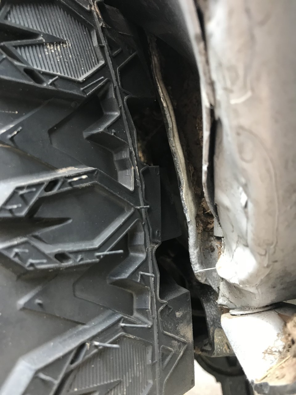

    The consensus seems to be outward so that’s the way I have been goingupload_2018-5-16_9-19-13.jpg

    I should continue till it’s flat against the other side?

    Hammer it nice and flat then, especially the lower part

    I’m worried if I hammer it around the other side it will crack the welds and she will leak, Ekkk..
