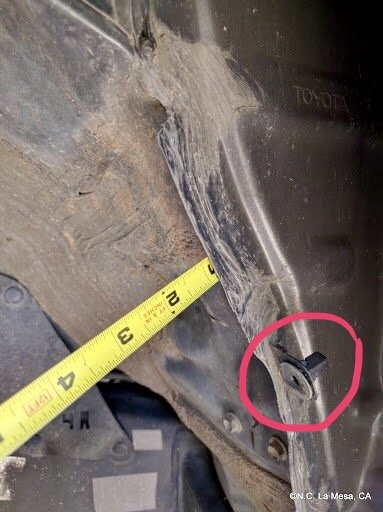

    Talking about this one. The clip holds pinches the liner against the pinch weld.
    A) I don't know how to get the liner out from under without cutting off the head of the clip
    B) I don't know how to reattach the liner there after beating flat that part of the pinch weld

    I thought you were referring to the hole at the bottom of the fender..
    A) From my understanding their is a tool one can use to remove the clips. I found many places online that sell either OEM clips or knock offs. If I were you I would order a bunch of exstra clips so you can reattach the liner. I cut my clips off from the backside using a wire cutter.
    B) I’m not positive, but I would not worry about one attachedment point as you have muple points of attachment for your liner and when you hear it up with a heat gun the plastic should mold to the contour of you fender wells

    Did this last weekend. Already had the CMC done so this was the last thing to eliminate all rub of my 285 tires. No pics :anonymous: but a few observations:
    I beat it flat to the outside. Driver side was WAYYY harder than passenger side for some reason, took 5x as long and when I was done my driver door was rubbing the jamb. Duck, okay so I pried it back and touched up the paint no biggie.
    I also retained the fender liner using @Crom 's method with the heat gun (this took longer than beating the pinchi weld)
    Before replacing the liner I bent the lip for the clip forward 90* so it's almost back where it was. This let me secure the liner using a new clip.

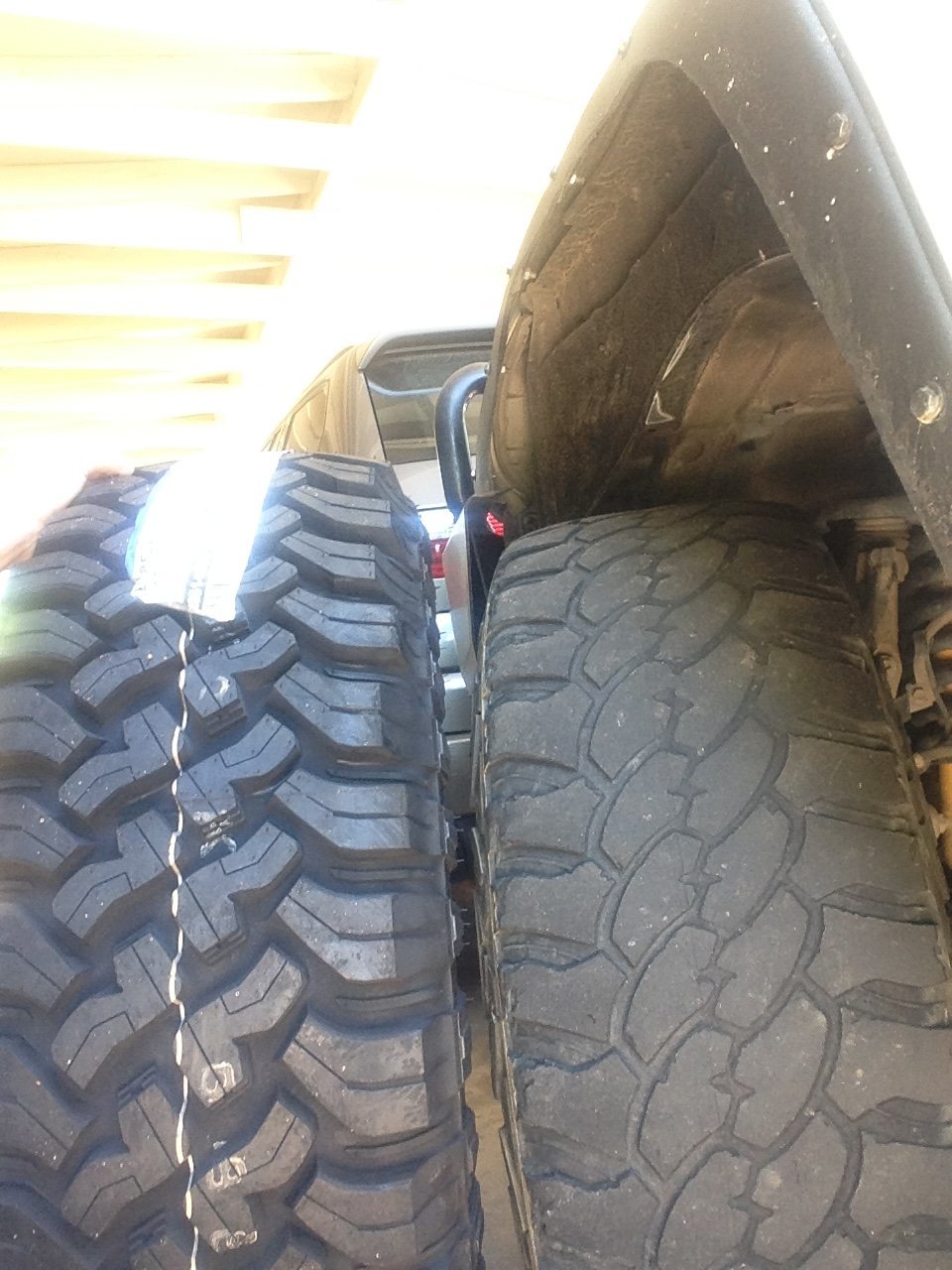

    Getting 35s in the morning, going to be fun making them fit
    EatSleepTacos likes this.

    Making my 34s fit was quite the adventure, so good luck man!!
