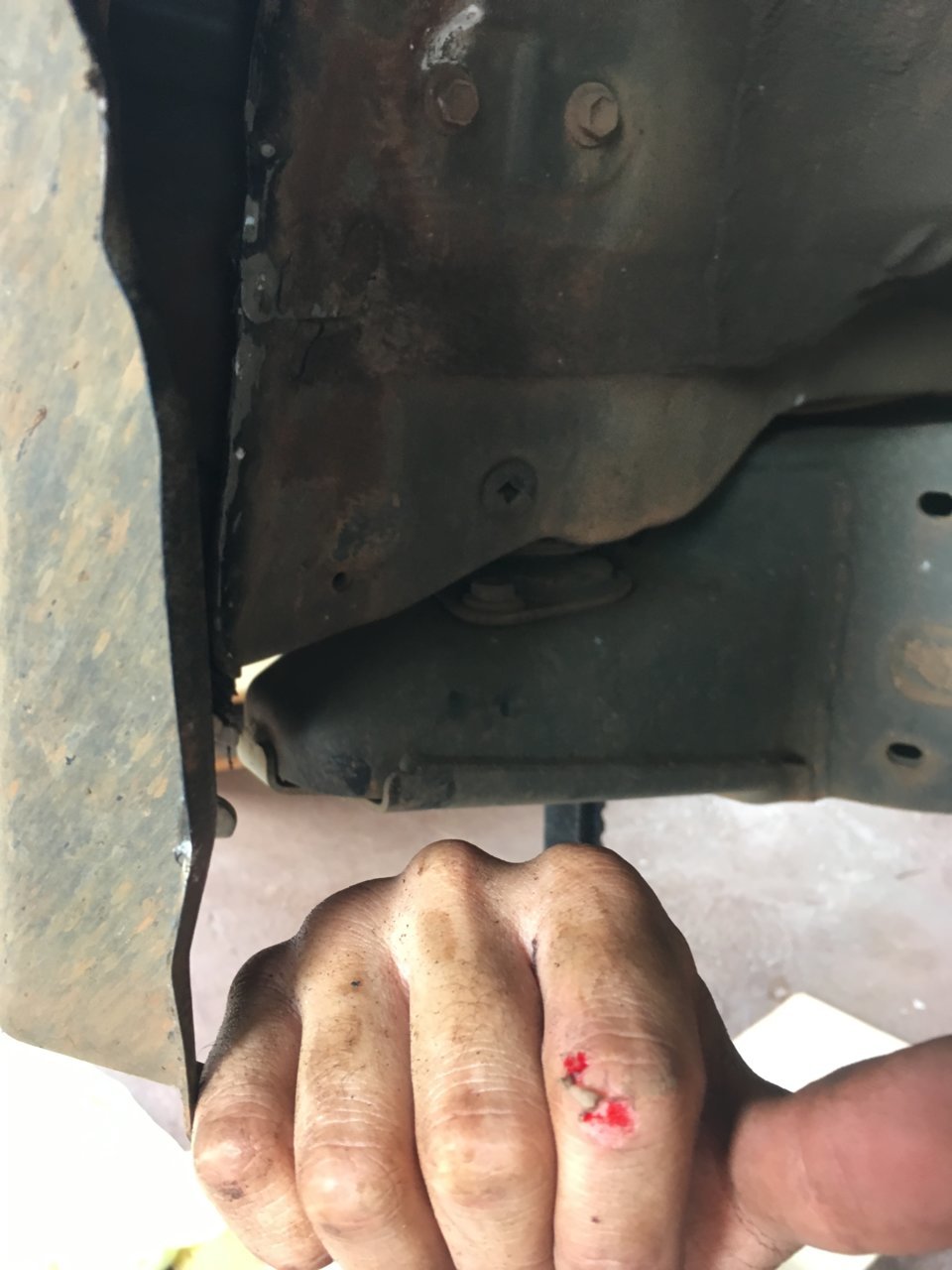

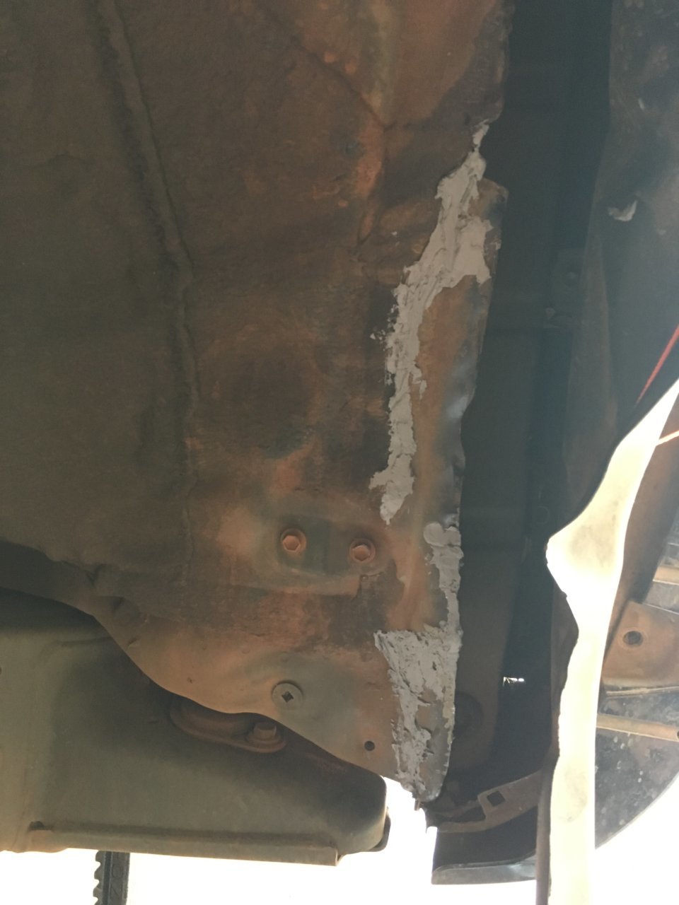

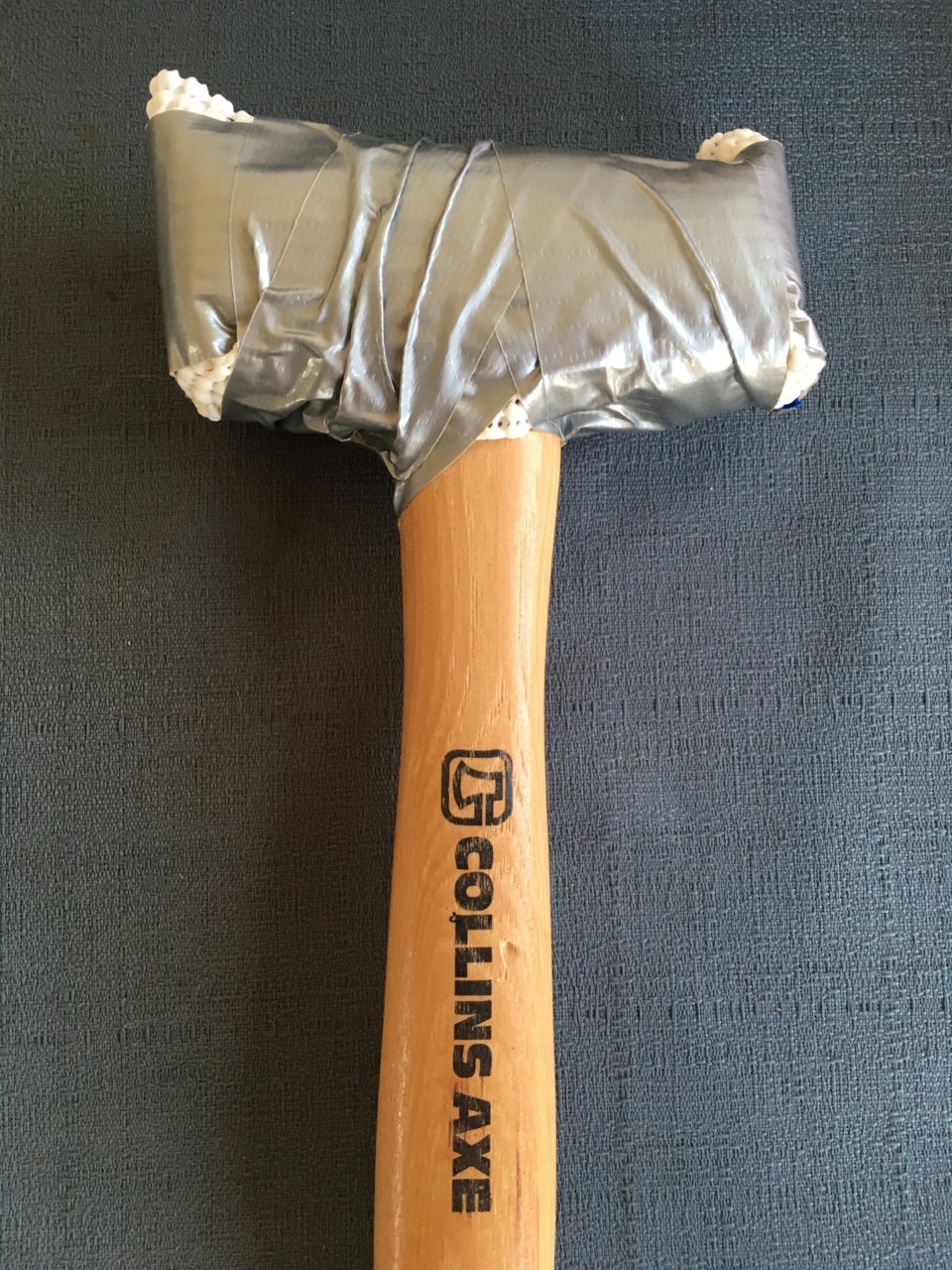

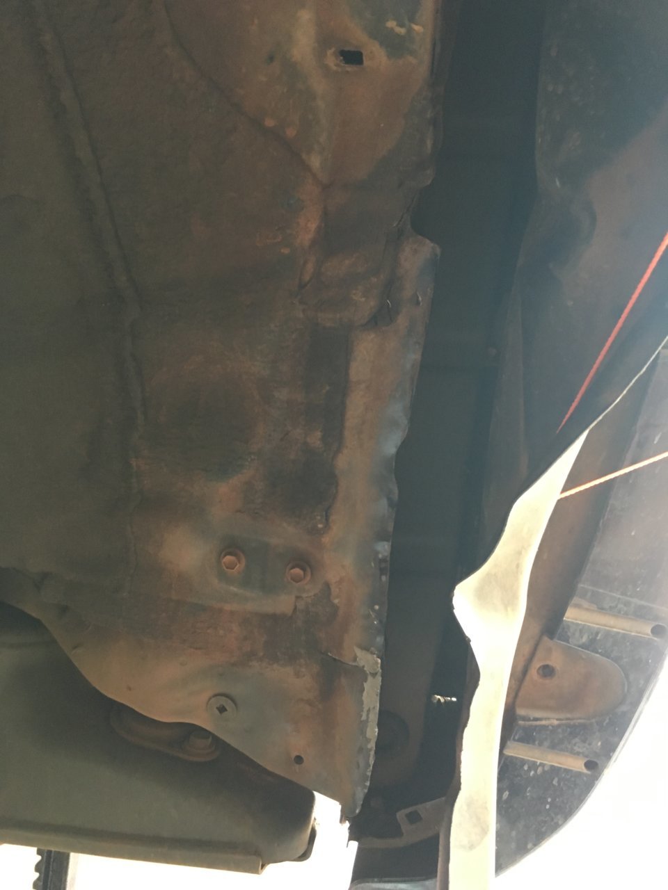

    So I went at it today thanks to all the helpful information in this thread. A couple extra (common sense)pointers if not already mentioned:
    - Do not train shoulders/arms before doing this mod like this Einstein did. Holy fatigue, Batman.
    - Wear gloves lol. Pic below.
    My padded sledge hammer that quickly appeared to have gotten raped:
    The debris that fell out as I began hammering the driver's side: image.jpg
    Driver's side flattened. I did get some cracking:image.jpg
    Applied seam sealer using the caulking gun with my ever-so-thrilled forearms feeling every bit of warmth of happiness. Looks like shit lol but I went straight to where the cracks were and along the questionable areas. After letting it sit while seam sealing the passenger side, I went back and added a little more and pressed it in get into the grooves:
    While hammering the passenger side, my knuckle clipped the cab mount and scraped it pretty good. Didn't stop me though. Looks like the CMC would have added more clearance for my swings lol! My CMC should be getting done on Thursday:
    Then sprayed both sides with 2 coats of rubberized undercoating. If I have enough left in the can after spraying my CMC, I'll definitely add a least another coat of it when I replace my liners with the Fend-X liners:
