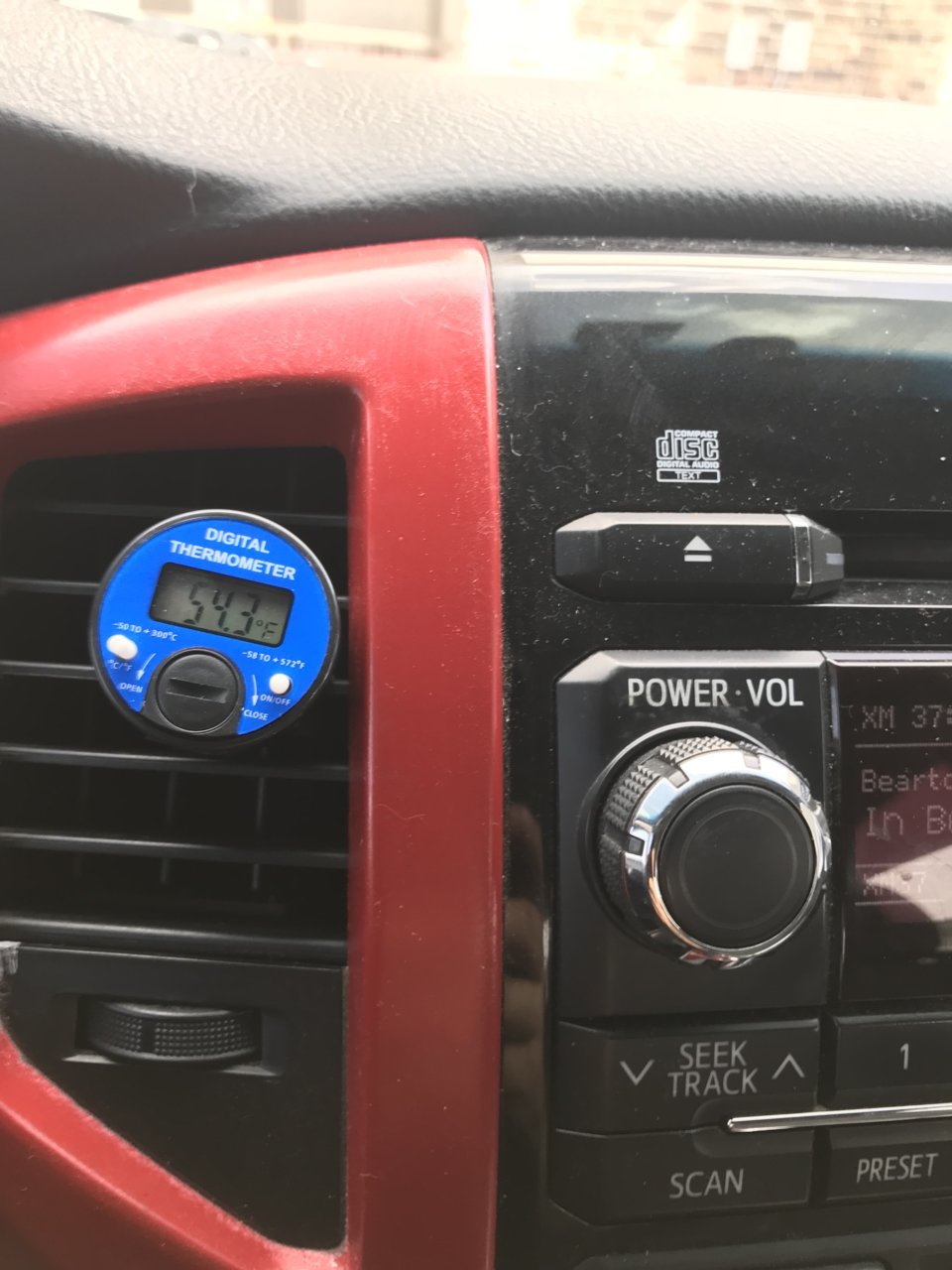

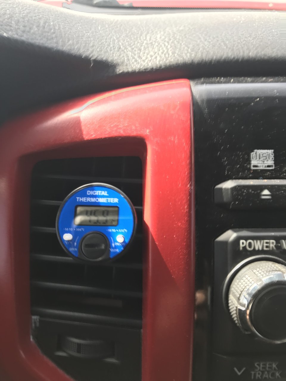

    Texas heat sucks dick! Nothing I can do about the weather but there is something I can do about my trucks air conditioning. I’m on a quest for at least 35-37 degree air. My old first gen extended cab would blow 33 on the highway. I have a dcsb with a 4.0. I got some basic temp readings today.
    Idle was about 55 degrees
    Stopped with engine rpm raised to 1500 got down to 44.7 degrees
    Cruising the highway at 65 mph with engine rpms just shy of 2000 I had 45 degree air. All of this is on the max blower speed, yeah I know it’s suppose to be taken on the next to highest setting but this is texas. My goal is to have 37 degree air in stop and go traffic with an ambient temp of 97 degrees or above.
