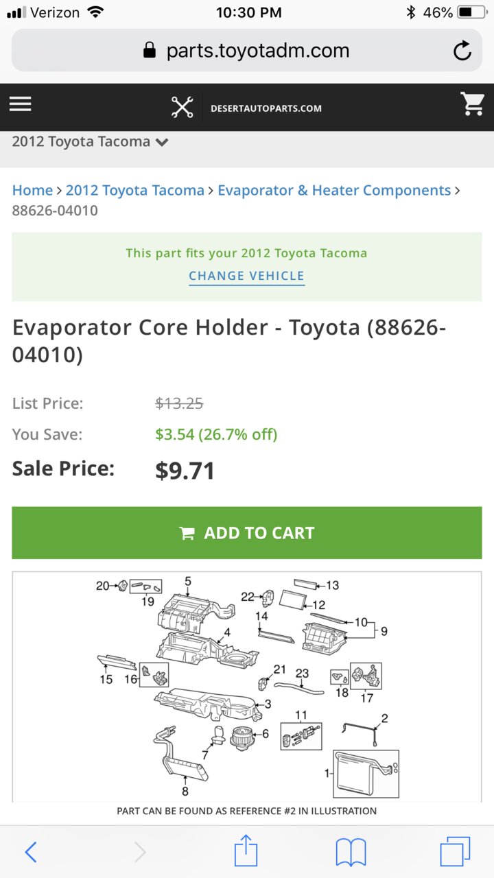

    I actually have one in my grubby little hands. Is there something specific you would like to know about the thing?

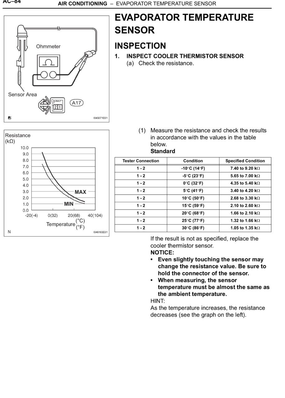

    May help with any mods you plan on doing with one of those.
