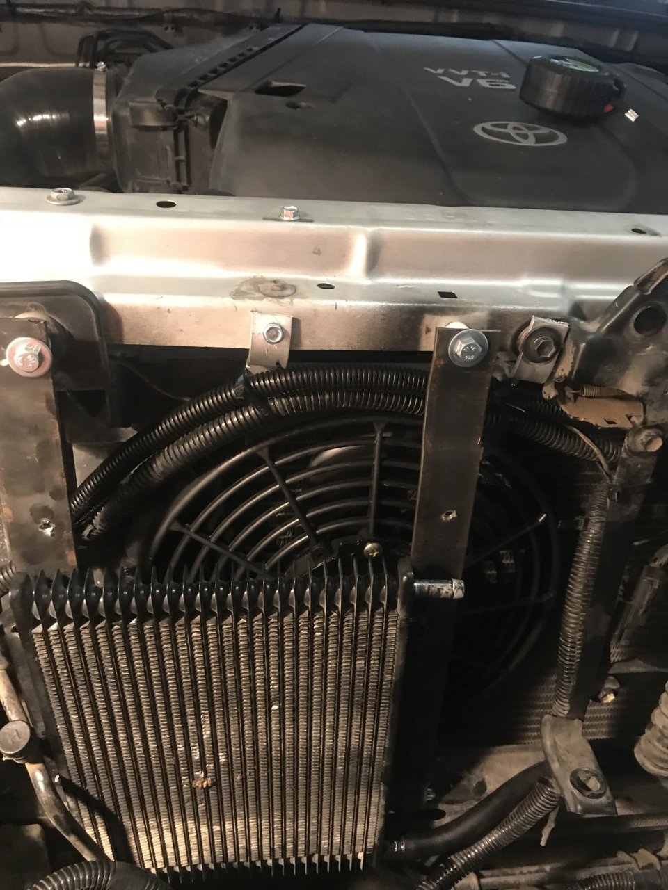

    @Bebop .... did you ever install an electric fan on the condenser ? I have ordered a fan but have yet to install it. Biggest challenge i'm facing is how to make some brackets that hold the fan in place and not look janky.

    Here’s what I did...solid
    Did you get a curve blade fan?

    Top mounts
    My fan doesn’t really do anything though lol..5959AAEA-B4AA-4385-8BFD-2C3AE4F8CF41.jpg

    I ordered 2. Waiting on them to show up and I’m gonna fab some custom brackets

    What ones did you get? I’m thinking about doing two 10” and doing straight blades this time...

    I gotta check my laptop at home but I think I did 2 16s

    There’s no way you are fitting 16s...10s were a tight fit. 12s I don’t think would even fit

    Maybe I ordered 10s for the truck. I ordered one for the fiancés evoque. It suffers from the same problem except it won’t blow cooler than 64 at idle. Mine sits at 55
