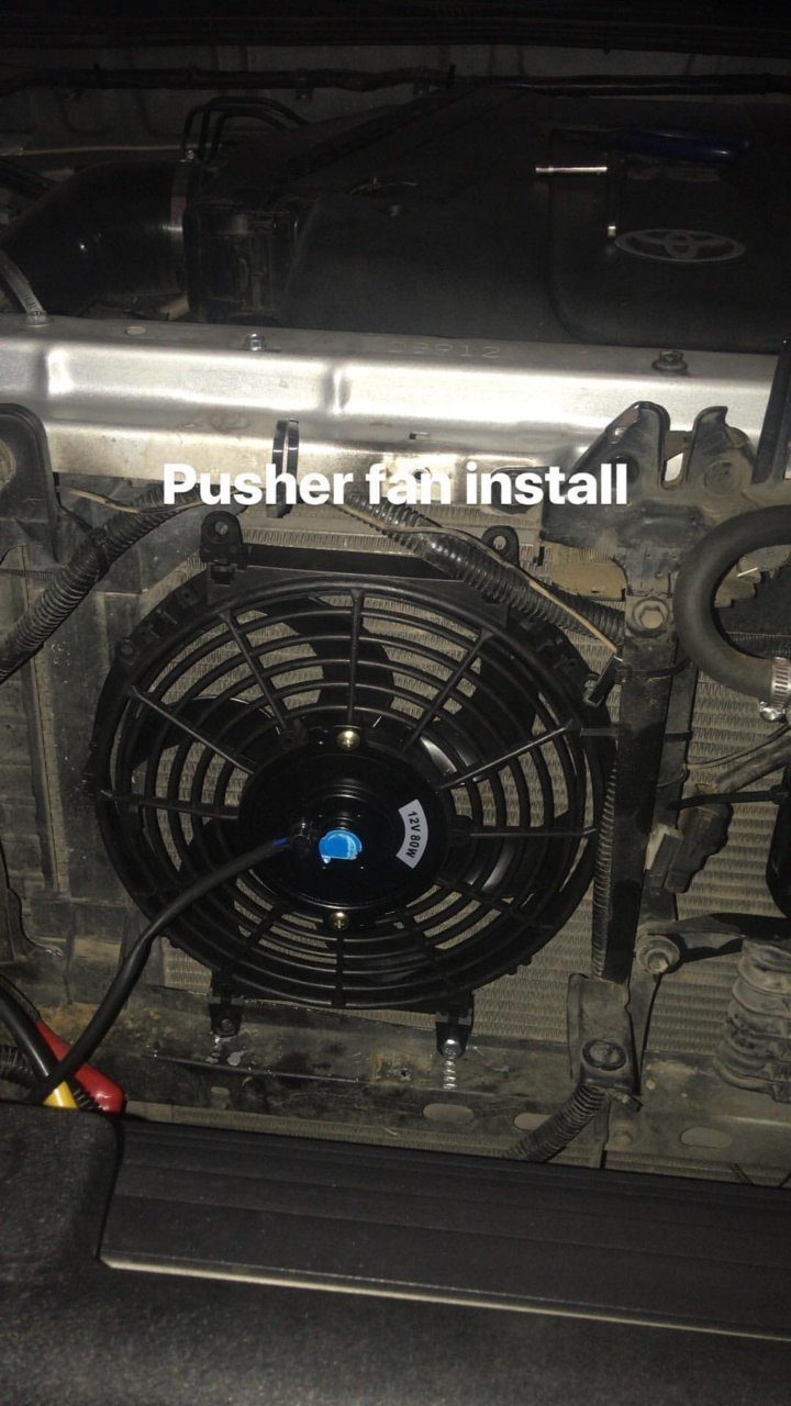

    Thanks for posting this. I ordered a 10" straight blade fan. How many CFM's is your fan rated for and how did you wire yours? I'd like mine to kick on when the compressor does.

    When it’s 90s here mine sits at 60
    10s are a great fit. Might not fit with trans cooler though

    1750 supposedly. I’m trying straight blade cause these aren’t doing anything lol. They are off Amazon
    Wired to a switch

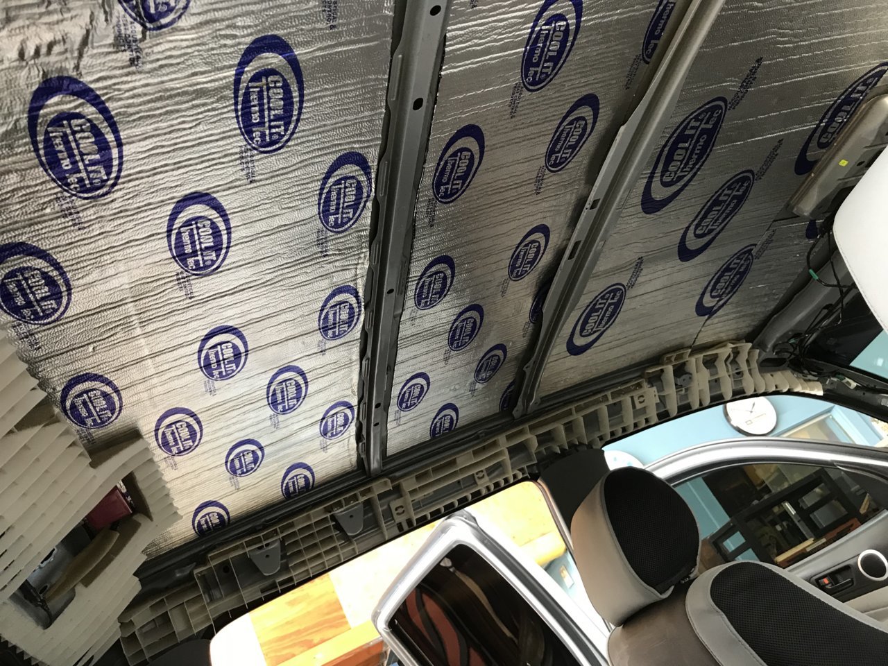

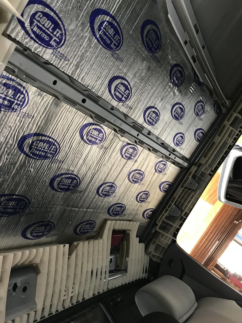

    Just did this yesterday, headliners back in.

    Sadly I didn’t take any before data or temp measurements inside the cab on a hot day. I did one time and it was around 115-122 inside the truck I think. I used this product on a customers barracuda floor pan since his complaint was the engine and headers would burn his legs through the firewall and tunnel especially during the summer time. He said after I did it he’s had no issues with heat on his legs anymore. I’m just hoping for less radiant heat inside after a hot day and that the ac won’t have to work as hard to cool the cab down

    I did mine a while back, i did a sound layer and a layer of the thermo stuff. I don’t have any before and after measurements, but definitely quieter and stays slightly cooler when parked. Mine is silver too, and i have tint and a windshield sun shade.

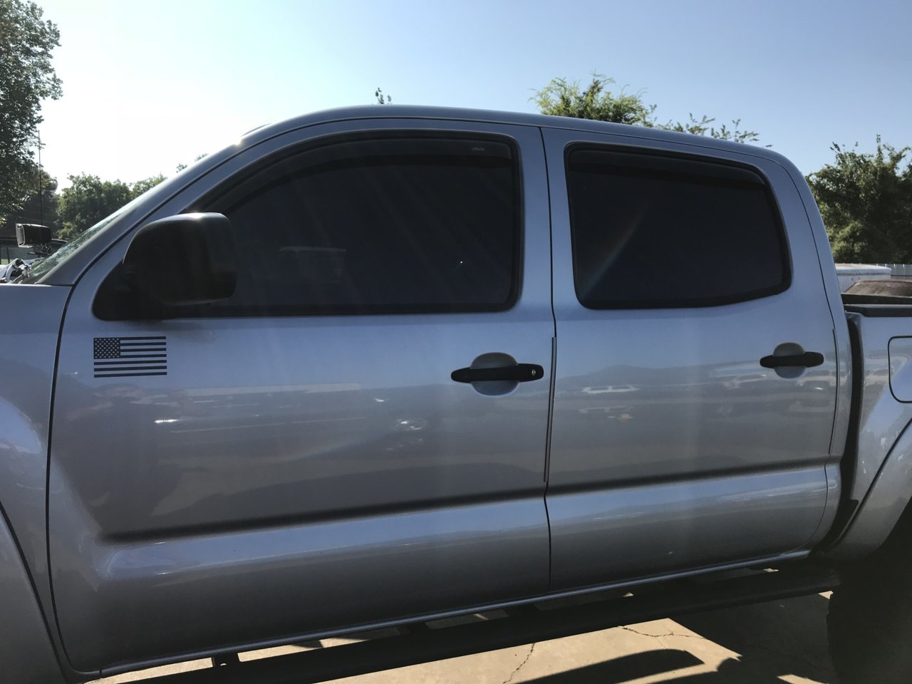

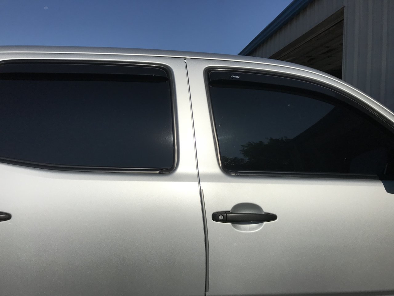

    :cheers: My rear windows are at 2.5% tintand front two are at 15%, 5% eyebrow and a sunshade as well.
    So you double layered it?

    Yeah, i did a layer of stinger sound deadener(butyl), then a layer of the dense foam foil.

    Pic? I can’t decide between 20, 15, or 5 LOL

    I’ll try to take one in a bit, 15% still allows you to see out of them at night time, 5% does not on the front 2 lmao, I had it for a while. It’s amazing during the day though

    I live in CA so I’m trying to figure out how dark I can go without being too dark. Lol

    The Thermotec (cool it) sheets 60”x36” in Amazon are $53-56 a sheet. I used 2 of them and still have some left over
