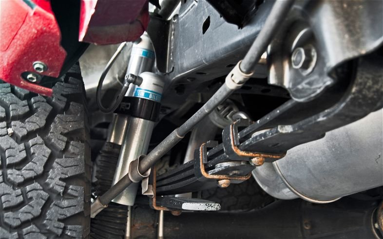

    Quick question, is the rectangle piece the rear brake line extension bracket?
    And how best to mount the rear shock reservoir??
    Also, are there some washers and or any parts that need to be taken off of the stock suspension and put onto the baja suspension?
    My shop has my truck right now and is wondering if there is a instruction manual that shows how exactly they want the baja kit installed?
    I know it's pretty strait forward, but they were talking about some of these washers or small parts and just wanted to make sure they set it up correctly?
    Any help is greatly appreicated!

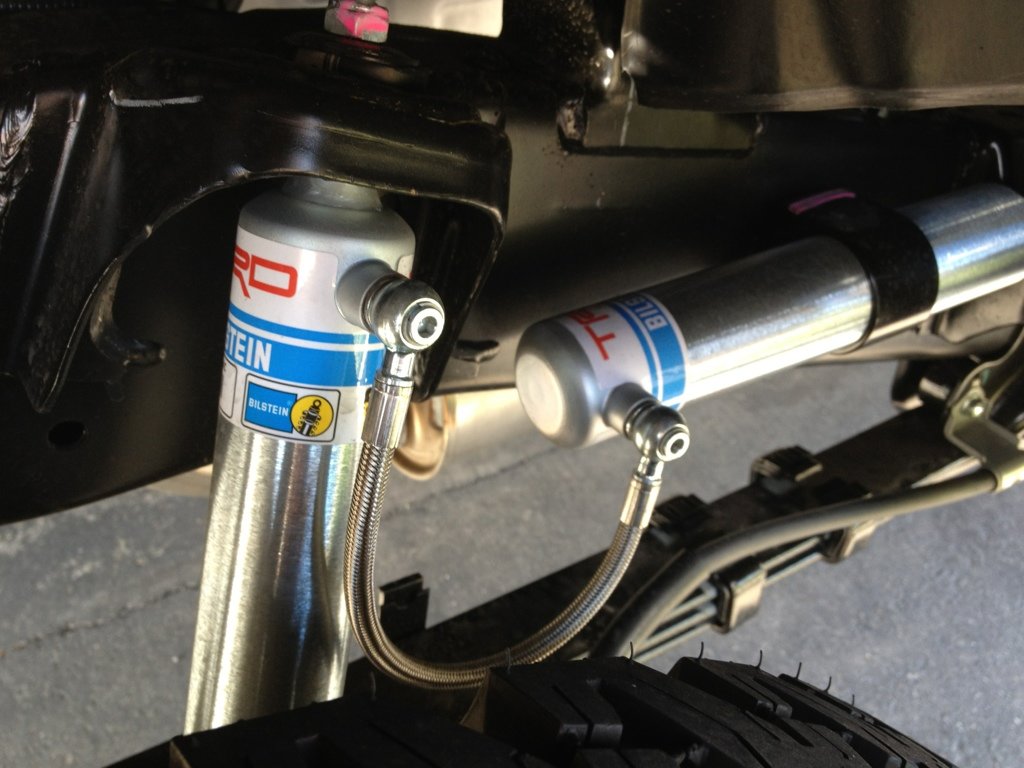

    What's a better way to mount the rear reservoir?
    This way (aftermarket)?
    Or this way which is in STOCK form?

    I used all the stock rubber bushings and washers for the shocks except for the top nuts and washers to fit over the thicker shafts on the new shocks. The square thing for the brake line extender I still haven't figured out where that thing goes, just didn't want to admit it.
    For the RR's the driver side I put on the frame like Brandon and Littleblue did, the passenger side I mounted it IN FRONT of the shock in the frame cutout but canted a little bit to clear the bed mount, then I put some flex conduit on it just in case the braided line rubs.

    I think stock is to put it on the frame now.
  20. Aug 23, 2013 at 7:43 PM
    #280
    Brandon###
    Brandon### [OP] Well-Known Member
    Apr 27, 2010
    #36105
    1,090
    mount the reservoirs on the frame.
    the rectangle is the brake line bracket extension
    there is no instruction manual despite what the sticker on the box says...
    reuse your stock parts
