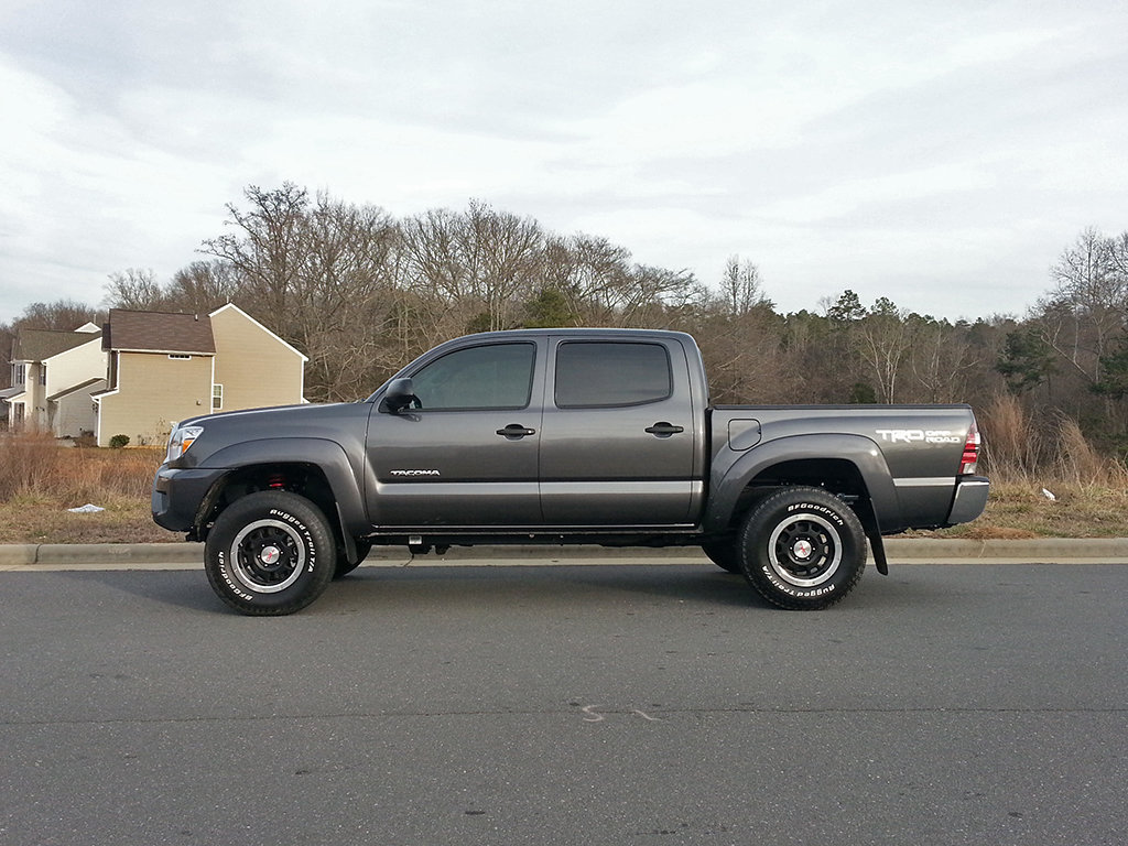

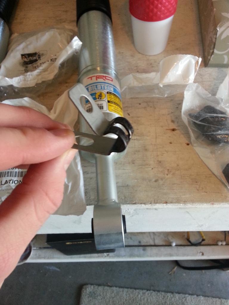

    Question,
    Can anyone tell me the proper place for this brake line bracket?
    I went ahead and installed it in place of the original brake line bracket on the diff, rather that the one under the left springs. Is that correct?
    Anyway, got it all installed. Pretty straight forward. I was confused about the front bump stops because I remember someone in another thread mentioning a nut on the back side of them. Turns out there isn't one and they just screw on and off. Used a metal strap wrench for an oil filter to get them off.
    Here's a photo, the truck's dirty right now. My 2014 Off Road came with what I am about positive had to be the TSB 4 leaf pack. I have 3 main leafs, plus one smaller overload. Didn't all the 2013 Off Road's come with only the 3 leaf packs, 2 mains and one overload? Did they change this is 2014 and just throw the 4 leaf pack on everything or am I wrong here? I ask because since I have 4 rear leafs, I should essentially now have the exact same setup as the Baja trucks. For some reason though I feel like I have a little bit of bro lean/rear sag. Maybe that will even out as the front springs settle? Either way I plan on doing an Add-a-leaf in the back to bring it up soon.

    The new clamp should replace the one under the driver leafspring. The existing clamp on the diff should be reused.
    The front is lifted with this setup, the rear no. So it will look different than stock. Yeah, the AAL will lift the rear some to get some rake to it. As well as get you some better cargo hauling capability. The AAL will take away some of the downtravel.

    kryten Well-Known Member
    Jun 23, 2009
    #18813
    1,750
    Canada
    07 TRD Sport DCSB 6MT 4x4
    1" lift from 3rd gen suspension, 265/75/16 ATs
    Doesn't Baja come with 'TSB springs', 4 leafs and an overload (3+1)? Or does Baja's come with a different leaf spring pack than the rest of the Tacoma trims?

    Mine is 3 + overload. I believe it is the same crappy TSB spring. I added the 550 lb helpers. Problem with the helpers is they do not ride like stock on rough roads. I wonder if AALs are the same. I like those black wheels. I almost ordered my 2013 and I had inquired about getting the black ones. I never got a definitive answer. In he end I just bought one that was already built.

    Thanks! They were hard to find. If you're ever in NC let me know, I'd be very tempted to trade you for the gray Baja wheels haha :cool:
    Thanks for clarifying your rear setup too. Sounds like we have the same thing.
