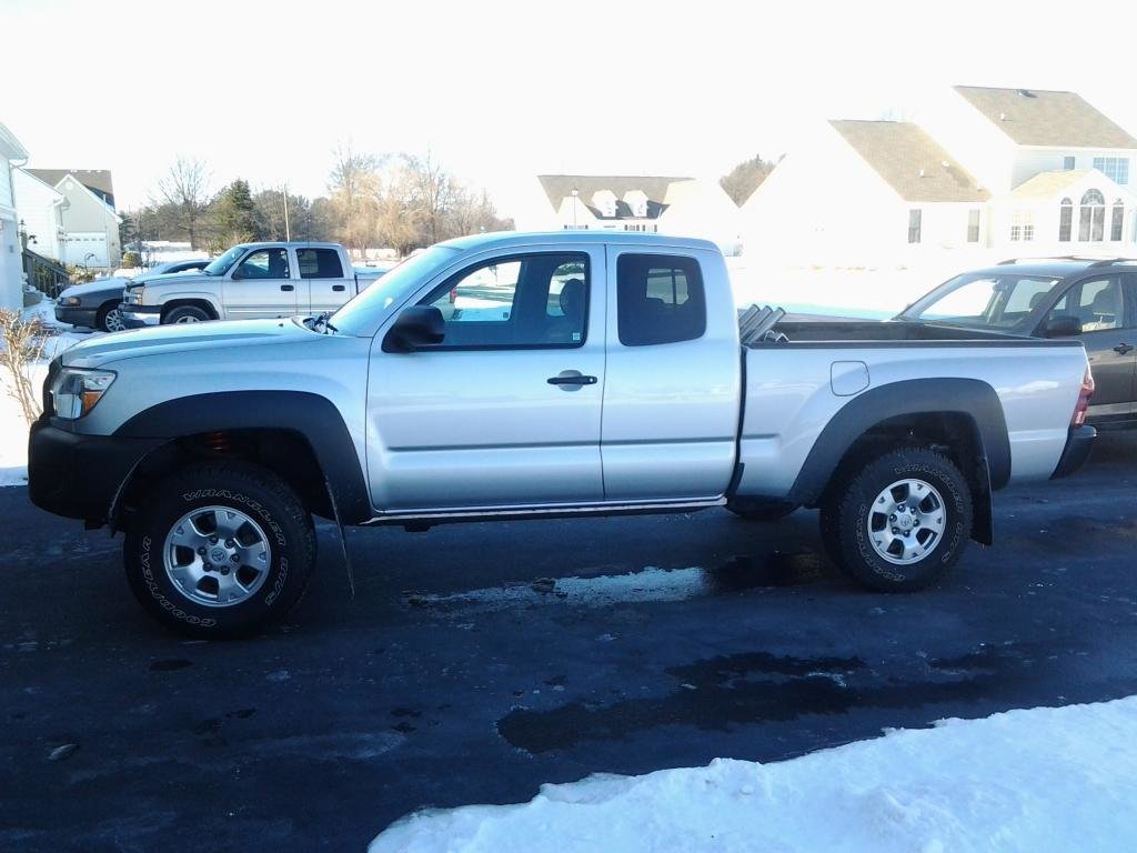

    Just picked up the truck from the dealer ...Baja is installed !! looks & rides -kick ass !!!
    pics coming ...stay tuned

    Nope, not working...

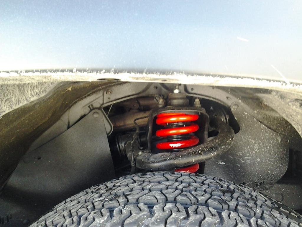

    322

    Looks good, I would have gone this route also, but availability of parts worried me...

    in 5 yrs if it wears out....something better will come along....not worried about parts.
