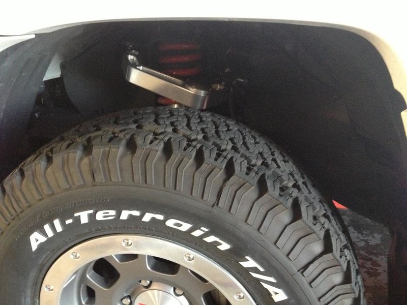

    Speaking of Toytec, I got the baja kit with the spacer from them and I notice this. anyone know if the spring seat is suppose to be offset? Also Can someone provide a picture and arrows pointing to where all the hardware kit parts is suppose to go?
  13. Apr 2, 2014 at 12:58 PM
    #453
    robotninjasrule
    robotninjasrule Well-Known Member
    Jun 22, 2013
    #106819
    207
    peter
    edmonton alberta
    2013 trd sport
    I think its offset because of the taco lean. The more compressed side for the DVR side. Although the the part number should say which is which.

    CORRECT ....as stated thats how mine looks even without the toytec spacer

    So are the Toytec parts used in addition to the factory seats (stacked) or do they replace the seats shown in the above picture of the factory set-up? If used alone, are they different heights like the factory pieces, or will I get the Taco Lean back?

    They replace the oe seat, about the lean I don't know. I've been busy with army that I am not able to install the suspension.

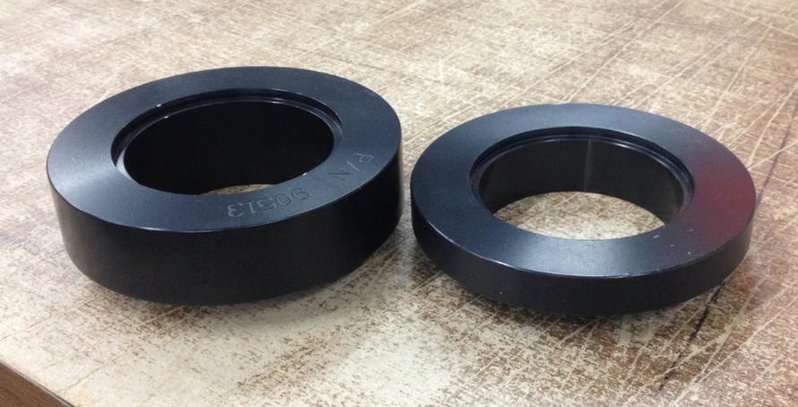

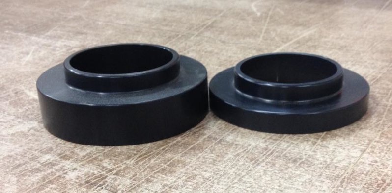

    I emailed Toytec, and here's their reply (and attached photos):
    "The Baja front shock factory seats are the same thickness from side to side. Our 1” spacers replace the factory seats with a thicker seat. They are the same size side to side as well. I attached some photos of our spacer next to the stock one. I cannot find the other stock one, but am almost positive there is no difference side to side in the seats."
    After looking at the picture posted by xpaznboymkivxp a bit more closely, it does appear that the factory seats are the same. Look close and you'll see that the spring on the left looks wider that the one on the right too - must be the way he took the picture. The only difference is in the adjustment of the seats. One is higher as shown by the line on the shock body.
