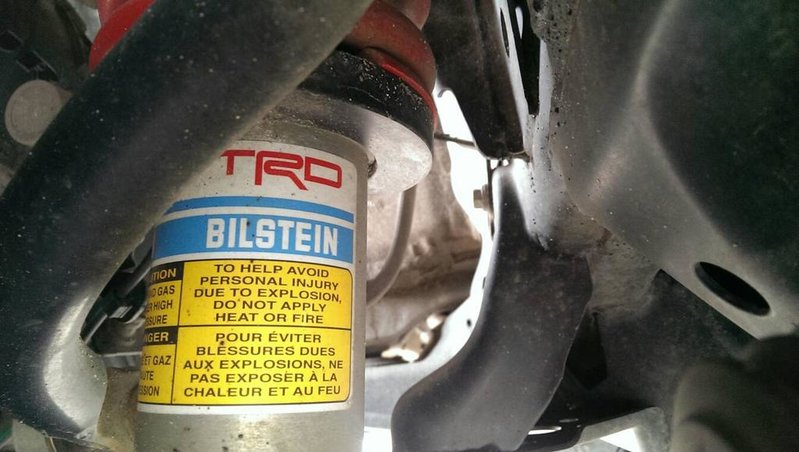

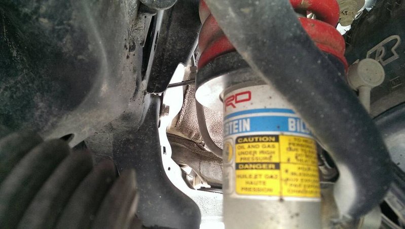

    I've got 0.5 inch difference in the front and a full 1 inch difference in the rear side to side. Do you think my front shocks were installed on the wrong side? It seems as though there is a difference in the bottom plate height but that could just be how they put on the stickers??

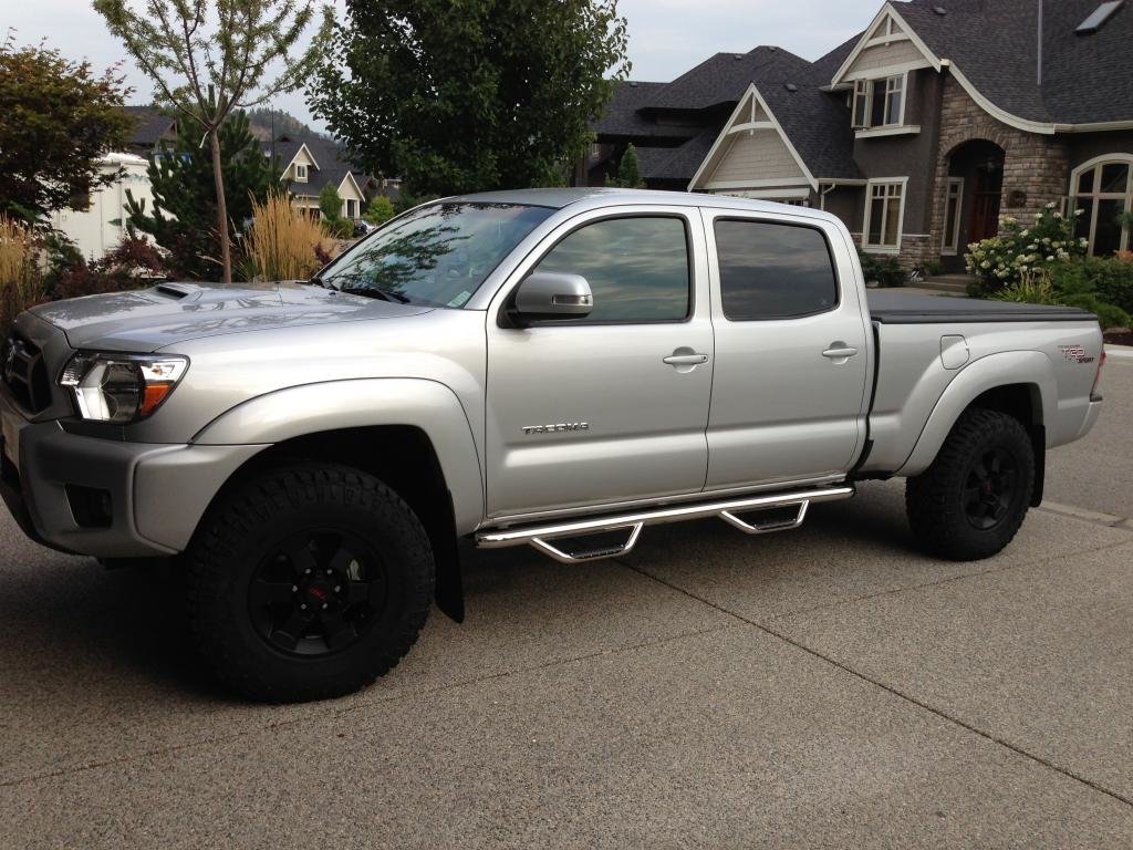

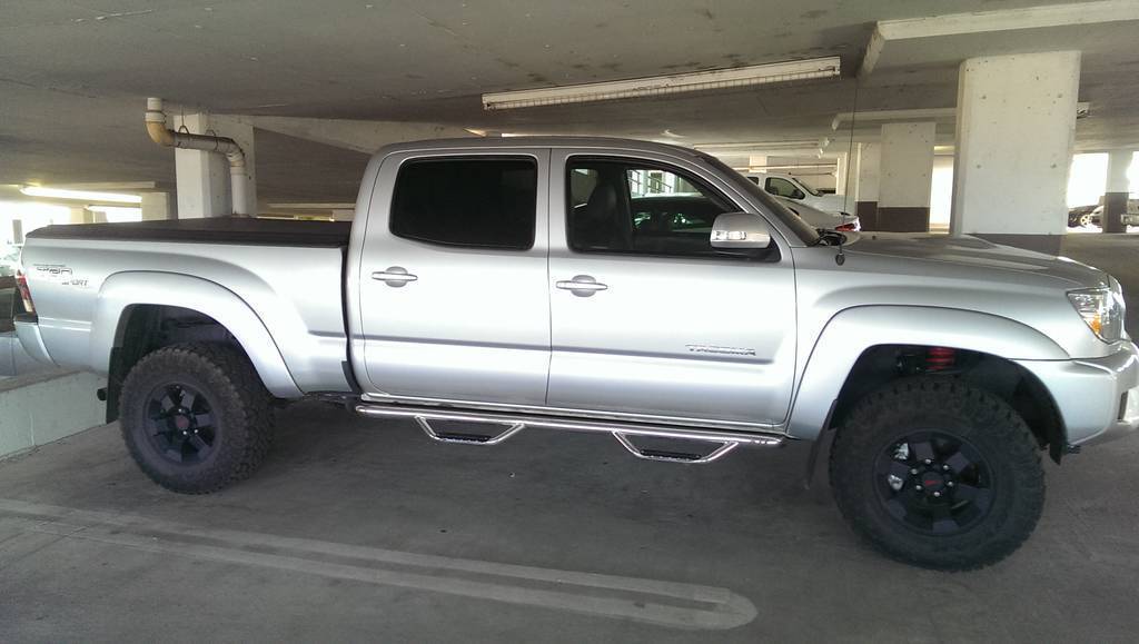

    Finally got around to getting my AAL put in. So much better now! I like the stock rake look and the truck looks like what a stock Baja (suspension wise anyway) truck should look like!
    No AAL:
    With Wheelers progressive HD AAL:
    I measured and I have from center of wheel hub to under fender 25inches on the passenger side and 24inches on the drivers side.
    I can't remember what the distance was stock but?

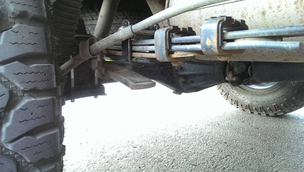

    I'm still wondering if my shocks were installed on the wrong side as I still have the 1" lean in the back...

    Actually, I think this may have just answered my question....
