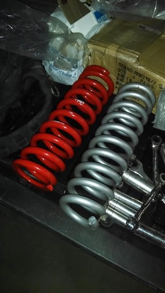

    Will the baja trd (red) springs work with the 5100s and provide lift?

    I don't think so

    I think you would need the 6112s.

    I would think so to because the collar on the baja bilsteins looks to sit lower.
    Strange because the seller of the baja springs replaced them with OME 885s to support a plate bumper.
    I was under the impression that the trd baja springs were the same springs as the eibach springs which are sold in toytecs lift kits but just silver instead of red.

    I don't think so. The Toytec springs provide 1.6" of lift. The Baja provides 1.75" lift, though this could also have to do with spring perch placement. The Baja springs are also 650lb rate, whereas the Toytec spring is 620lb.

    Interesting. My concern was with the spring collar being low on the baja shocks vs the bilsteins 5100s. But the eibach still look longer than the baja springs.
    Pic found on this forum

    Are you sure those are the 1.6" springs? Toytec also sells 2.5" springs, which I'd guess are the ones pictured.
